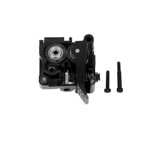

The connector on my extruder housing busted somehow mid print and the PTFE tube came out, luckily it was during a color change and the printer recognized the issue and didn’t resume printing
After taking the extruder cover off I found the little metal tabs that grip the PTFE tube all busted out of the connector, which no big deal normally as I have tons of these connectors on hand but I was annoyed to find that the connector seems to be molded into the extruder housing and non replaceable.
I contacted creality and they are sending me a new one but it will be 14 to 21 days and I cannot find this part available to purchase anywhere, so now my printer is down due to something that should be a simple replacement
Hopefully someone will make and extruder cover with a replaceable PTFE connector,

Here is the price I am talking about, the connector is indeed molded into the extruder front shell, unless I am missing something

I had same issue with extruder tube holder and Creality sent me a new extruder shell (this top part where the gears are in). In the meantime I ordered also one on Aliexpress as some of the spare parts got available there.
I have just extracted the plastic push connector and can’t see any metal claws in the orifice as is normal in these PTFE connectors.
I am wondering where have all the little teeth gone, Maybe I I have a metal reinforced print. :smile:
Anyone attempted to extract the embedded part. Looks to be pressed in. Crazy how it is not a screw inserted product.
I found all the teeth for mine stuck on the magnet used for the filament cutter blade

This is obviously a flawed design, and we are nowhere near the only ones with this, there IS a jerry-rig fix part that can be printed on Creality Cloud, search for: " K2 Plus Extruder Cover for PTFE tube / pneumatic fitting"
The problem is that it has to be 3D printed as well, thankfully I have another 3D printer and could print it in Polycarbonate to withstand the heat from the chamber (PLA and PETG likely won’t be good enough), and furthermore it will require a pneumatic fitting, the instructions say a PC4-M6, but I actually suggest a PC4-M10 fitting instead so you can push the PTFE tube all the way down into the extruder as it was before the “Extruder Front Cover” tore apart.

I found a double sided connector in the spare parts box that came with the printer, stuck it on the end of the bowden tube that orginally went into the extruder then super glued a smaller peice of tube into the broken connector on the extruder and connected it to the other side of the double connector. It wasnt pretty but it allowed me to continue printing while waiting for the new part
