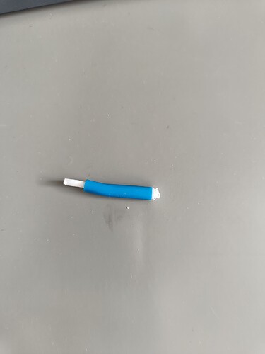

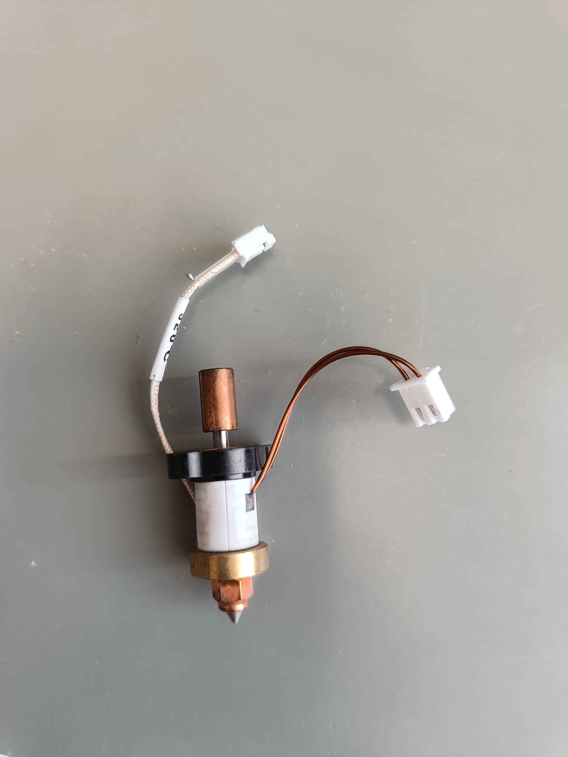

I have cleaned the heaterthroat with a heated iron wire for 4 times now. its getting blocked again and again at the top part of the heaterthroat (a few centimeters below the gearbox outlet) . I am unable to fix it.
You have a different heater-throat then I have. (I don’t have that blue pipe in it)
Maybe it is time to upgrade your hotend to a unicorn type. (that is the new type in K1 max)
My method of cleaning was ment for that type of hotend/nozzle.
This pipe connects the gearbox output to hotend input. I am not sure if this pipe is needed anyways. Could you give me a link where I could find the unicorn type?
My current hod end looks like this

You have the older style that the K series first came out with and has since then upgraded to the unicorn style…
Keep it in place as it helps directs the filament into the hotend so it won’t get caught on something.
Are you printing PLA/PETG/or TPU with the lid on and the door closed? That looks like it was caused by heat creap
Yes, I am printing with the lid and door closed with Hyper PLA. I have changed the hotend and it worked fine until I started printing a model that was supposed to take 6 hours. The nozzle was again clogged after 3 hours of print.
Not a good idea to print PLA with the lid on and door closed, the heat builds up in the chamber and causes the extrusion issue. There are some STL files around for printing a lid riser that will allow it to stay cooler in the print chamber
