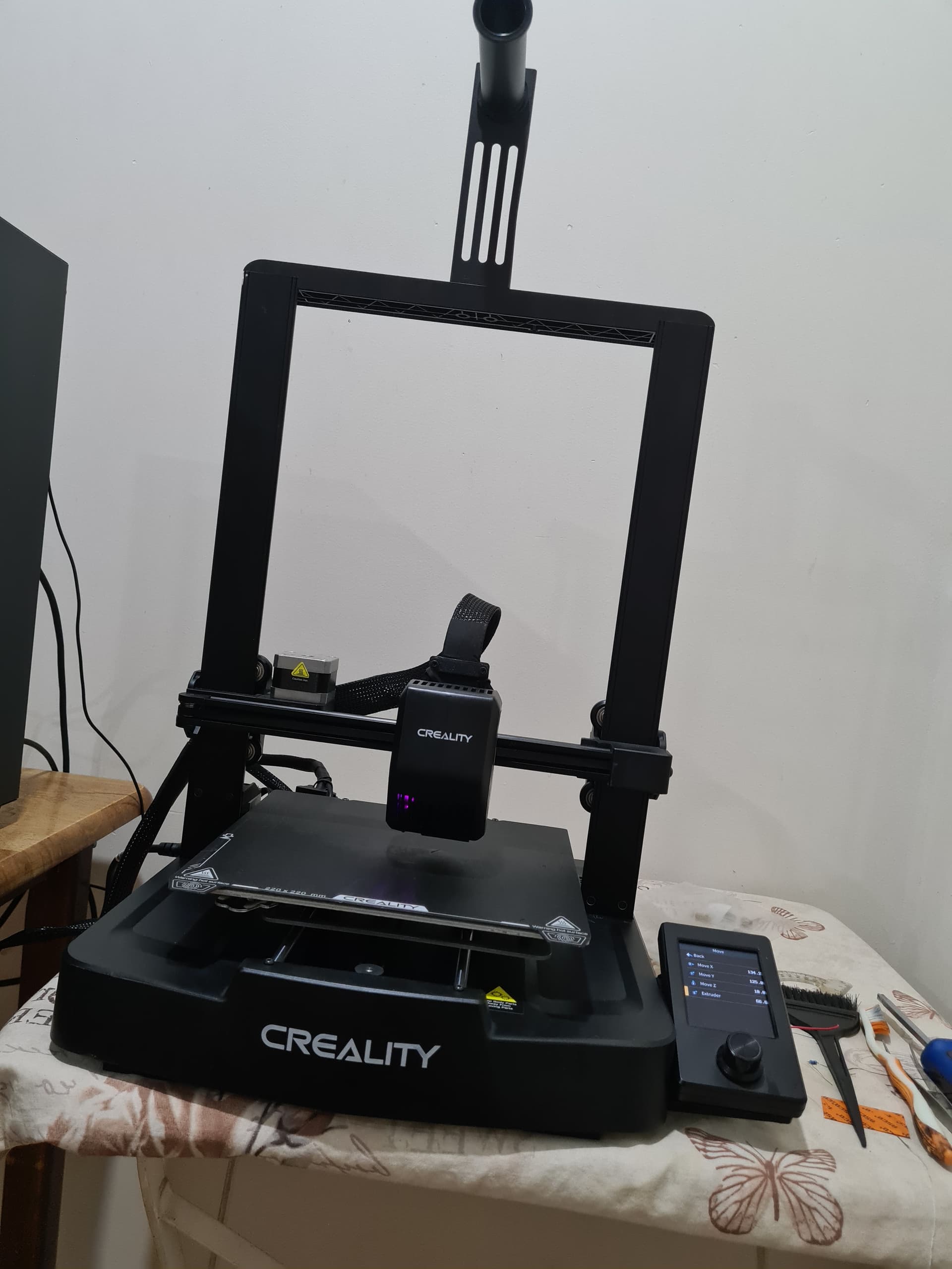

Hello Everyone Having an Issue with MY creality Ender 3 V3 Se Extrusion Stepper Motor , sometimes it stalls and skips stepps making very very werid Noise Tried Removing the hole Gears attched and its still stalls avd vibrates
i tried removing the whole motor i test it it with my Arduino + TB6600 Driver and its spins Very Good and Fine
test Continuity Mode via multimeter Between Its coils and its fine , pluged it into the connector of the Toolhead PCB and also the Continuity on the connector is Fine
Sometimes the Motor stalls and makes huge Noises , sometime it does not work at att even if only the motor is attached to the Head
am afraid maybe the Driver on The motherboard Is Dead
