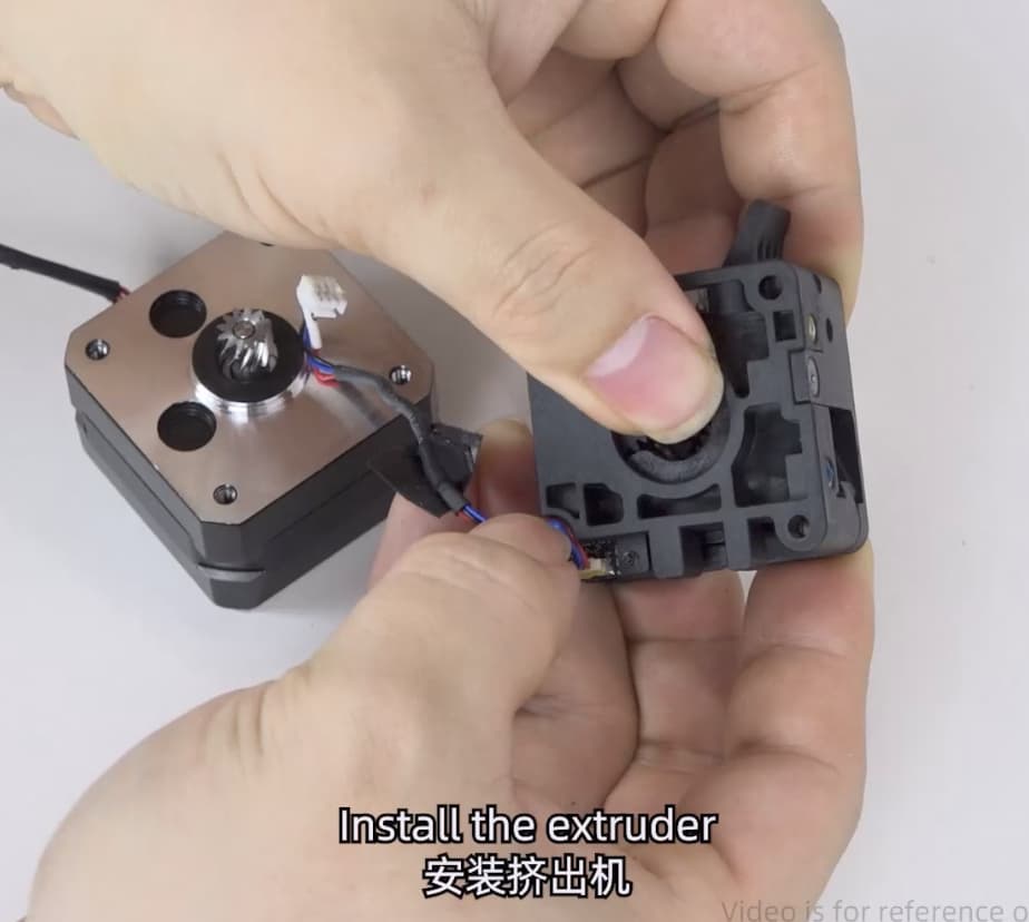

Since I buy my printer the first thing I had to learn was, how to clear extruder jams. For that I reviewed the «Service Tutorial Creality Hi Extruder Jam Clearing» video from the site Creality Hi & Creality Hi Combo 3D Printer User Guide | Creality Wiki but after the third time I started to be too much worried because putting back the extruder was difficult and the Cutter Sensor Cable started to be damaged. Even I try to buy a cable replacement, but was only available on stores on Canada and Australia, booth very away and the shipping was too expensive.

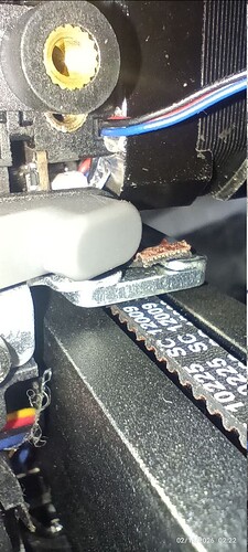

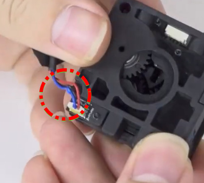

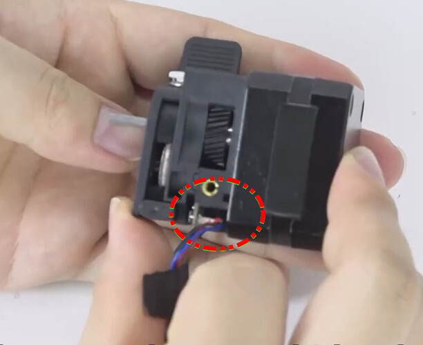

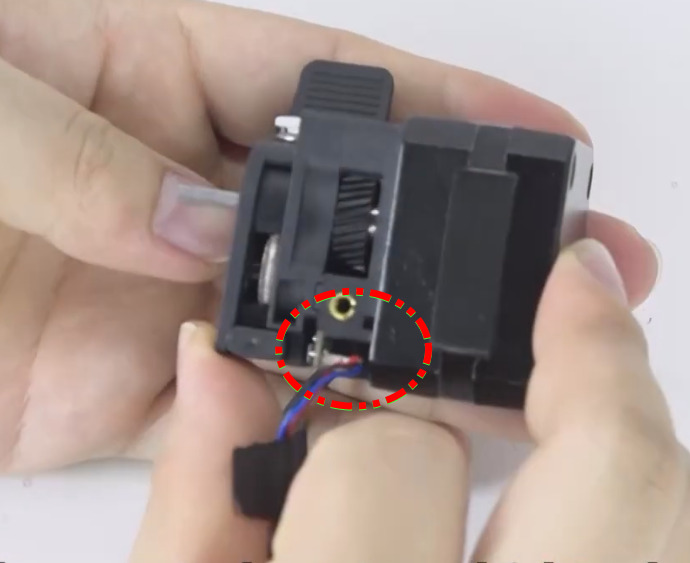

Was only until last week I see the video «Service Tutorial Creality Hi Replace the material break detection plate» and on the second 4:53 A EPIPHANY where in front my eyes:

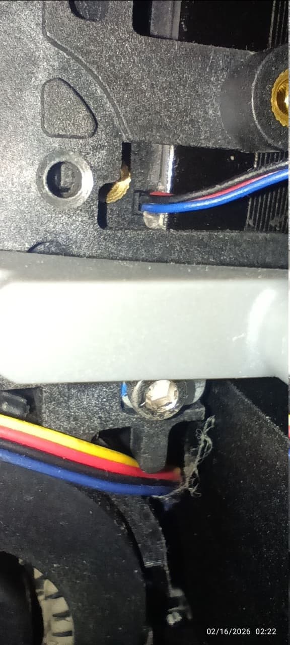

The back of the extruder have a small groove to put the cable on it. THIS IS NOT SHOWN ON ANY OF THE OTHER VIDEOS, EVEN if you look carefully on the other videos you can see the cable damaged.

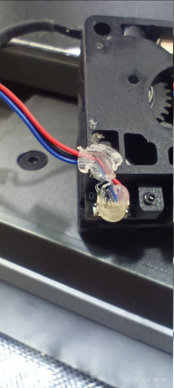

On my extruder this is the groove:

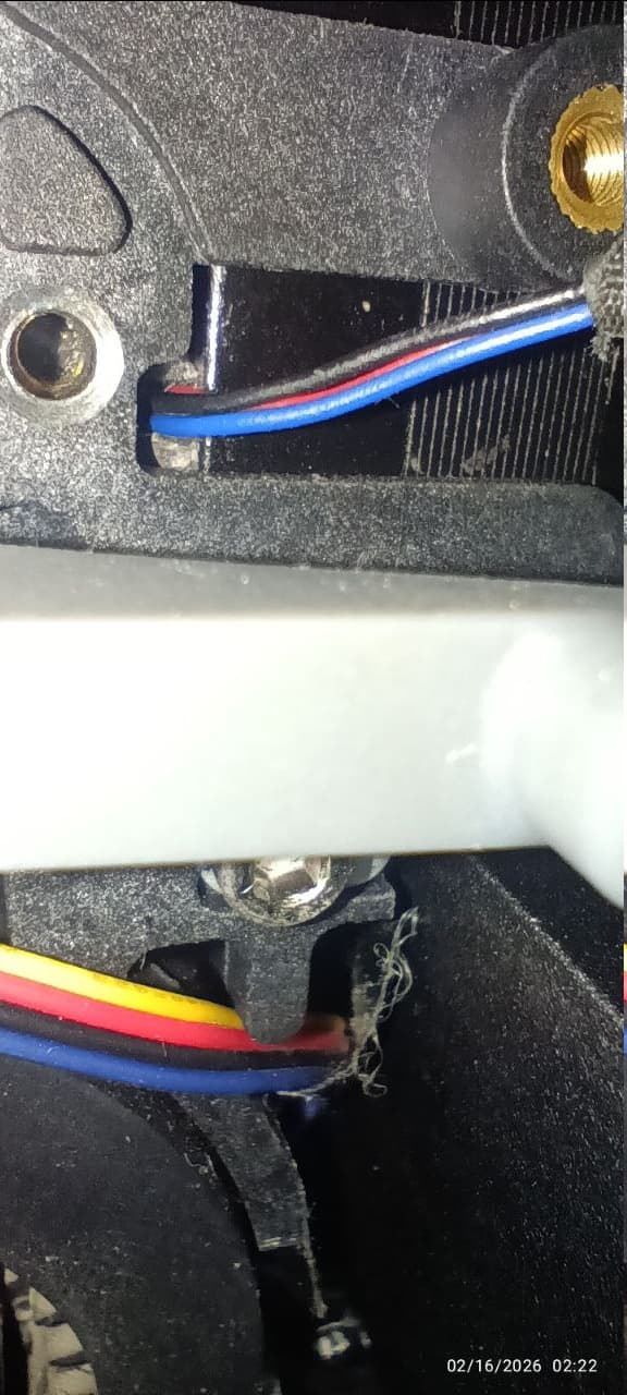

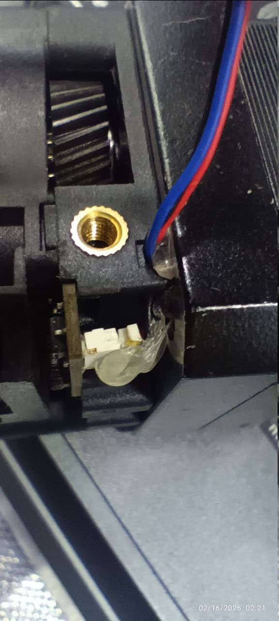

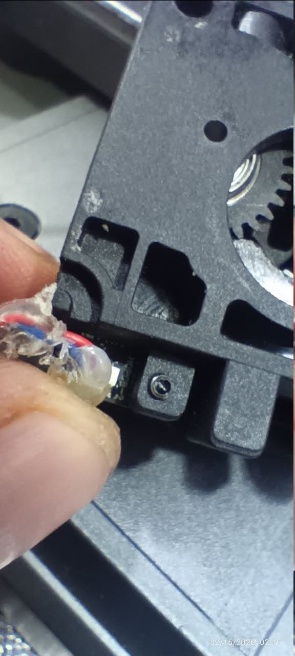

So I promptly put a small drop of hot glue making the cable fixed on the slot (and I had to put another drop on the connector because on one of the installations the connector got disconnected.)
Now when you assembly the Extruder and the motor, the cable is ALWAYS ON THE RIGHT POSITION:

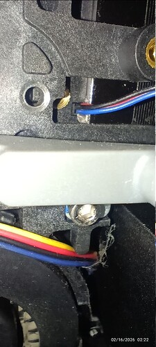

And installing the extruder on the print head, is like a breeze, it fits without problem and the cable is not damaged
Before this discovery normally was a fight to install the extruder on the print head, now it only take few seconds.

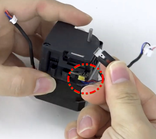

I do not know why on the other videos THIS VERY IMPORTANT STEP is not shown nor indicated. but if you route the cable on the small groove you will save a lot of time and trouble. If you look closely on several videos you will see the cable out of the slot.
And on some videos you can see the damage of the cable because is not properly routed.
Hope Quality and support repair the videos helping more people.

When you route the cable through the groove, do you have enough length on the cable to plug the other end of the cable onto the board on the front of the extruder?
Hello there, yes, the length is fine, ever better than before.
