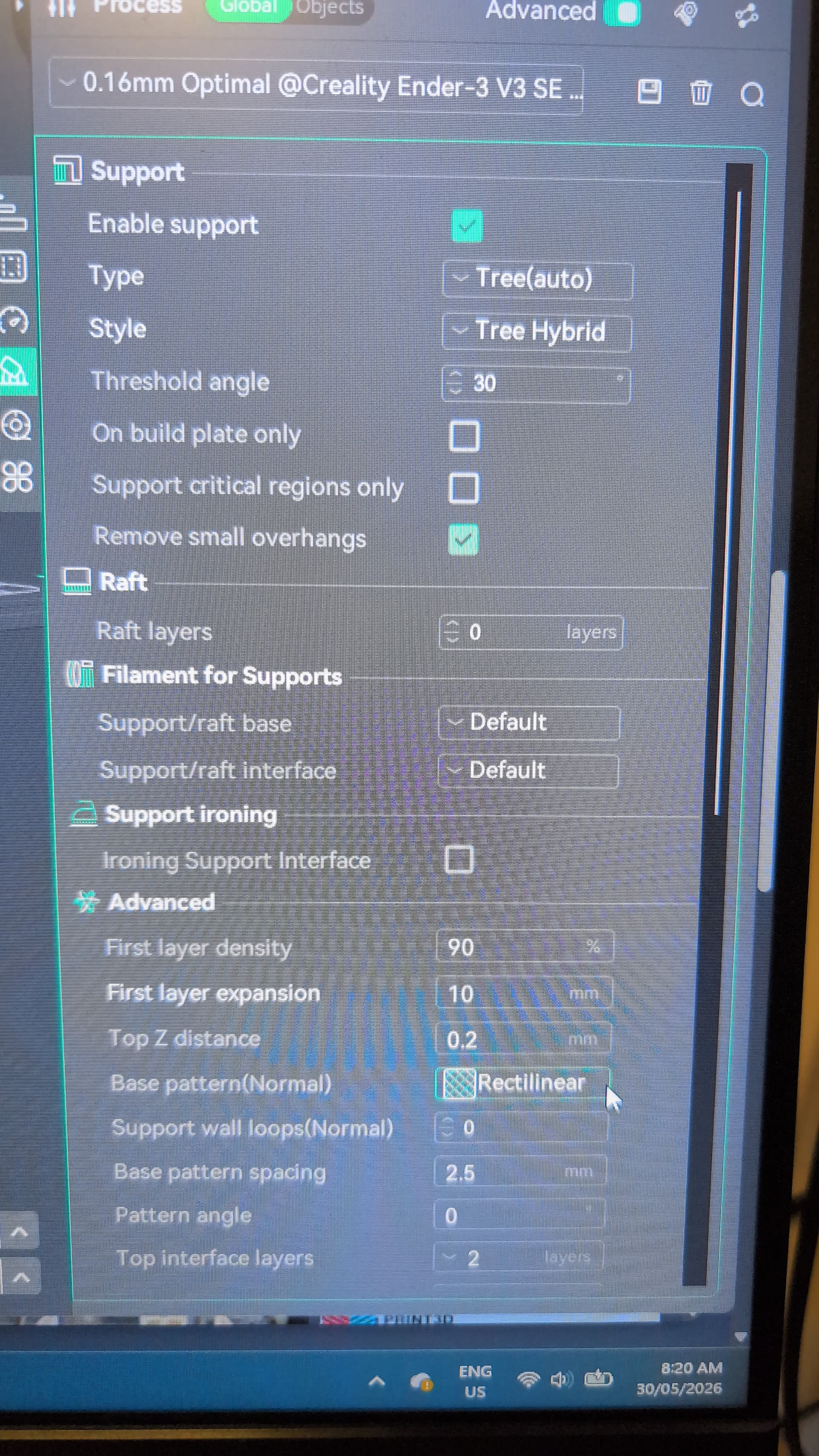

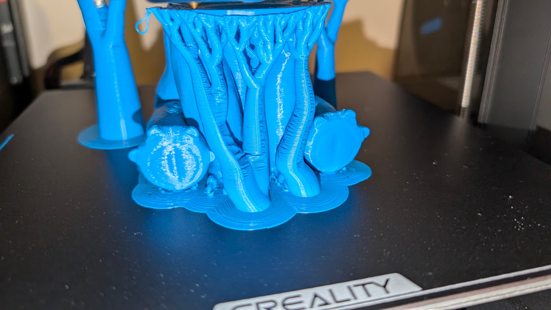

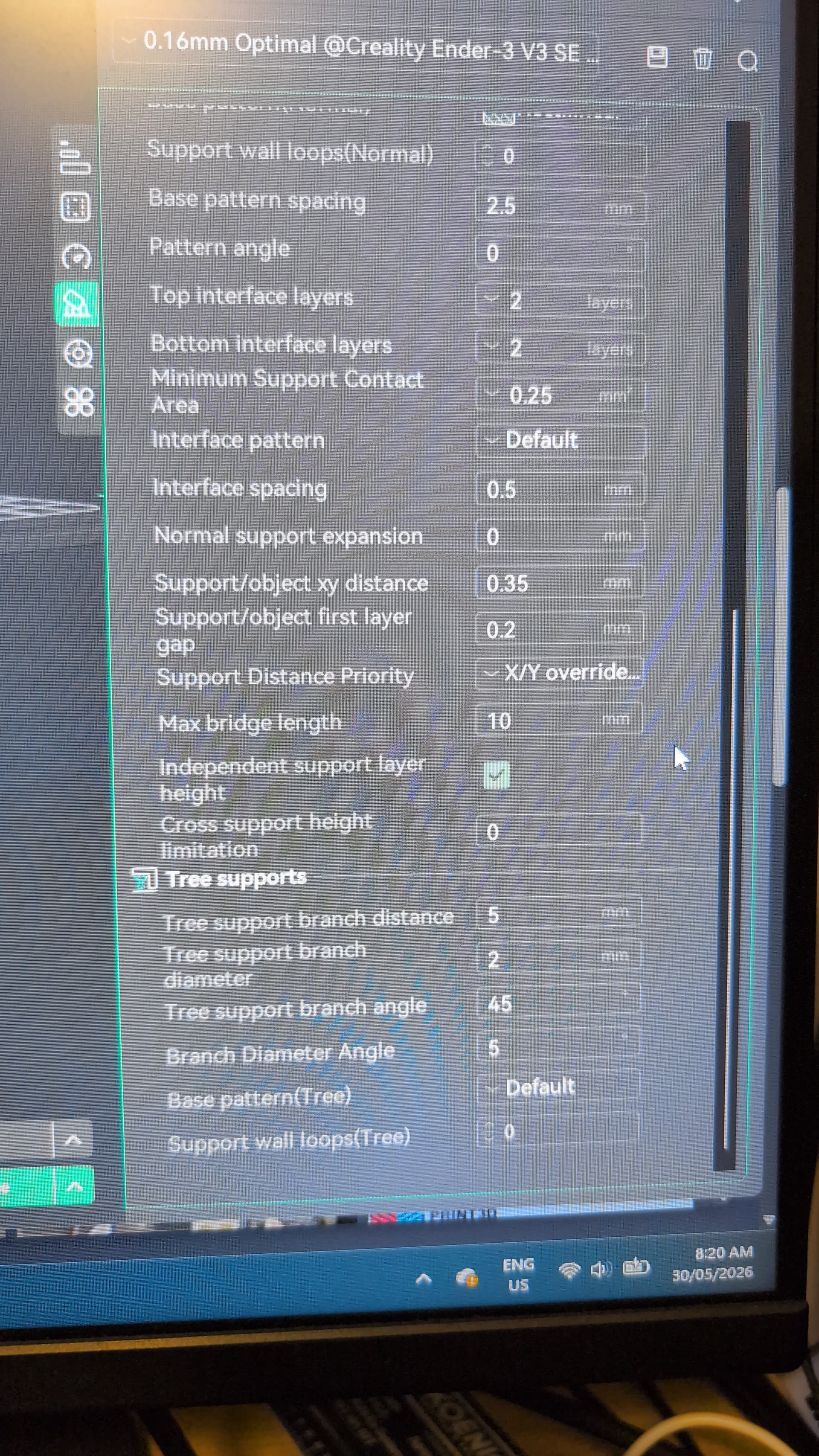

Hi all. New to 3d printing looking for advice to fix the tree supports. Obviously I don’t care what they look like but they are occasionally failing, resulting in the print failing. I’m using creality print with the below settings.
I would decrease the branch diameter angle. This creates more bases for the tree as they don’t ‘branch’ as far. Also, I found especially with Soleyin Grey PLA that single digit moisture was required to keep the branches from breaking. Thats a starting place
Thanks mate, I ended up fixing it by slowing down the print speed and also slightly bumped up the temp.
