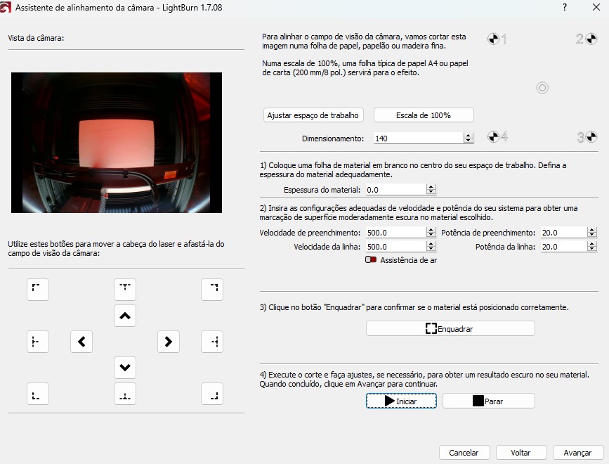

I’m experiencing the same issue with my Falcon 2 Pro 60 W when trying to align the camera. After problems with using memory cards, I decided to calibrate the camera while it was connected to my laptop to avoid constantly inserting SD cards. I completed the camera calibration, but when I moved on to alignment (the next step), the official video says to use a speed of 6000, yet LightBurn only accepts a maximum speed of 500 for alignment. I set it to 500 and adjusted the parameters. On the laser, I set the power to 20 W and in LightBurn to 20 % power with a speed of 500. The air system is disabled on the alignment screen, but when I restart the laser, the air pump turns on automatically. Then, when I try to start the alignment procedure, the air light turns red and everything freezes.
