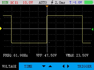

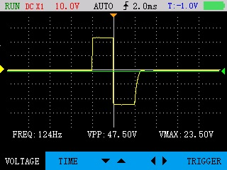

When I measure the 3 output pins, I can’t measure an voltage between them to re-engineer the pinning.
On older Lasers it was a simpler 24V on/off - it looks like A1 has a different logic?
I measured now the output myself and suceeded.
When AirAssist ist off: you get an 24V 4s per period PWM signal.
When AirAssist ist on: you get an 24V 16s per period PWM signal.
see pics attached.
Looking at athe A1 port, the upper left Pin is +, the one down is the PWM “minus”, so measured against the + Pin
