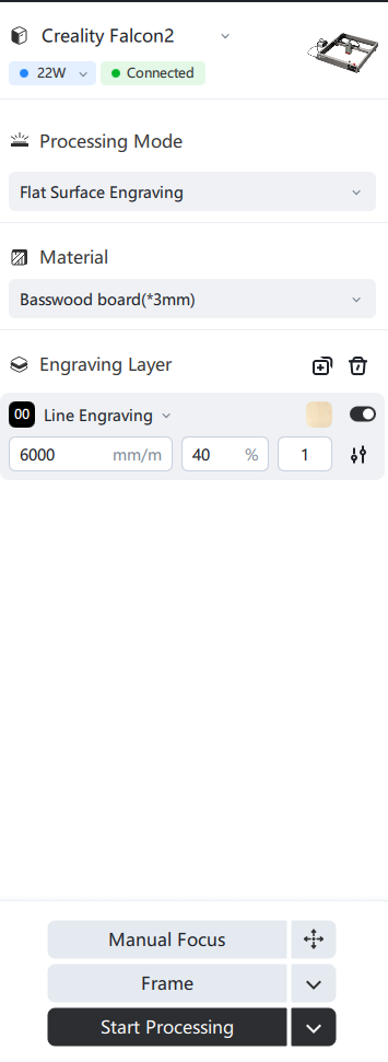

When I try and run a simple shape, it recognizes it and then frames it as expected. When I try and process the image (score it) the laser head correctly positions itself and follows the required shape, but the laser does not fire on. I know the laser works because it works in other software, and I can fire it manually in the drop down in the “Frame settings” window. Can you help please? I have also updated all the firmware and ensured I have the latest version of Falcon Design Space installed.

I click on the “Start processing” buttton, not the frame. It does everything as expected, except fire the laser
here is a screengrab of what i see
Update: I drew a simple circle in FDS, exported it as Gcode and looked at the code. It’s says M4 on one of the early lines. I edited the code to M3, saved it and then imported that code to FDS. It worked. I’m not sure why FDS is generating a gcode with M4? And why I have to edit the code to M3 in order for it to work? It seems to be a long work around to solve a problem. I can’t seem to find any setting in FDS that I can change?

its version 1.9.2 so the latest version. I just tried it again and I still have to export the file to gcode, change parameter M4 to M3 and then run the gcode in FDS.
Ok, just an update, I reinstalled the firmware for the laser head and now this works. Not sure what happened but it’s fixed :slight_smile:
