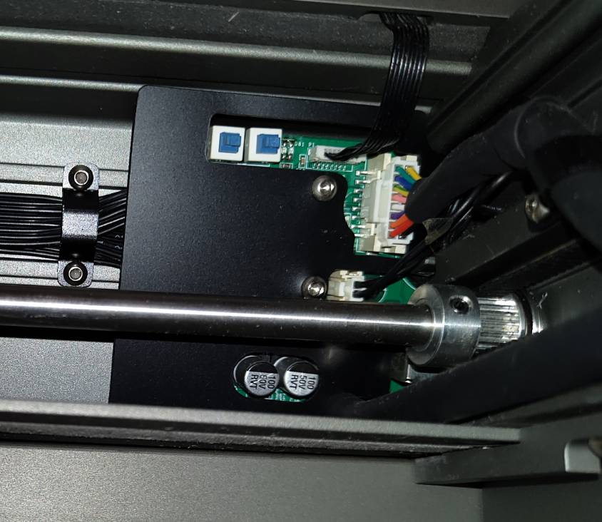

Just finished assembling my Falcon2 Pro. When I go to install the LED/Fan, there is no connector for the light module. There is a smaller connector but it doesn’t for the LED Light Bar. Has anyone ran into this ?

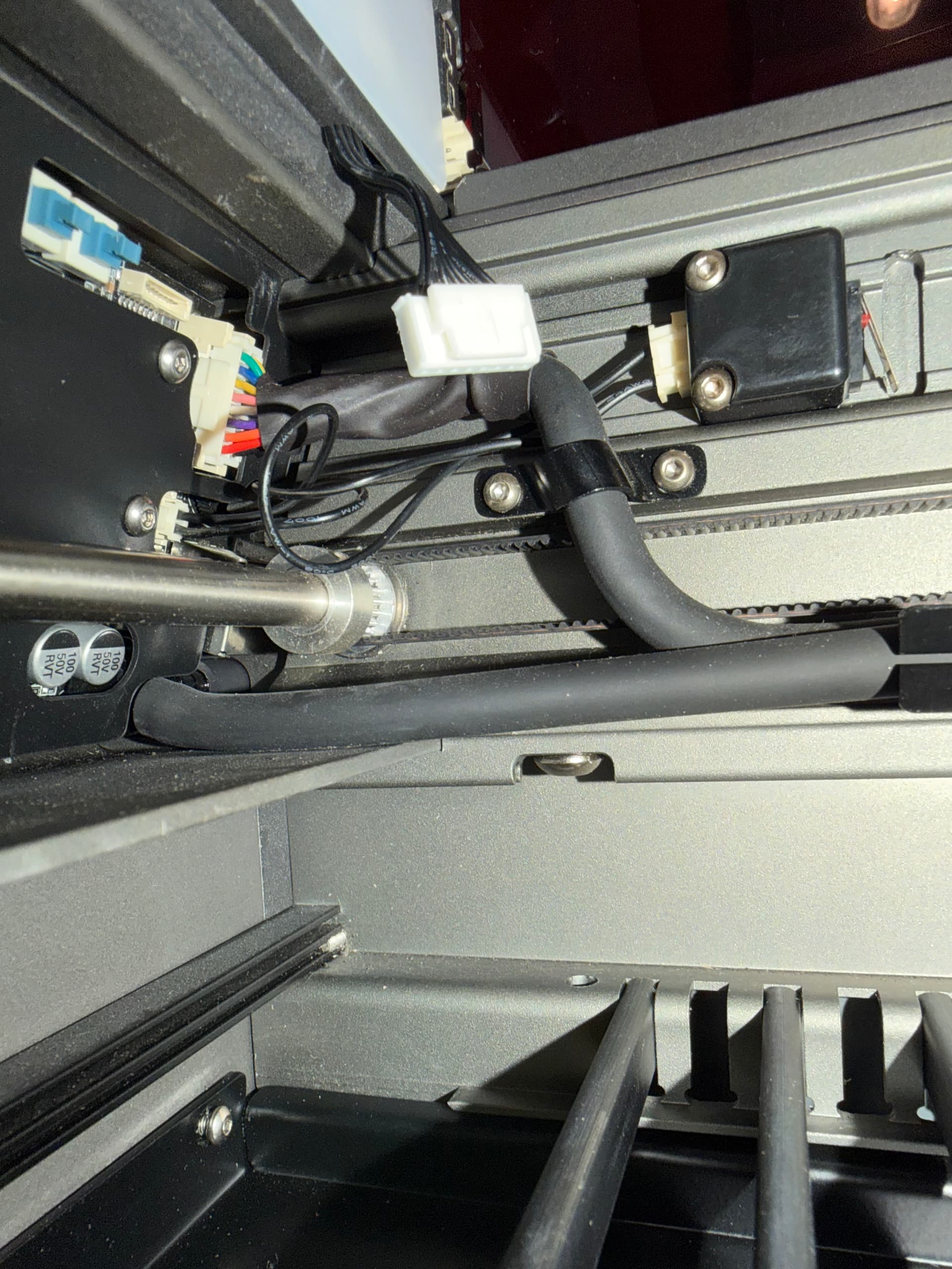

It should look like this:
The light panel connector should come from the front top. Unfortunately your video does not load. Can you look for the cable it should be just over the socket there somewhere.
Step 19 here:
Or 3:40 here:

So in the video you shared there is a bigger connector to connect to the light bar cable. When I try to fit the lightbar cable in it’s too large. I notice your also doesn’t have the large connector like in the video. The connector attached to the housing is too small to fit the the connector coming off the light bar.
Can you write an email to support@crealityfalcon.com with that pic? I guess they changed the connector then but this revision of the board does not fit the new revision of the light or there is some adapter cable needed now, so they can send you whatever is required.
