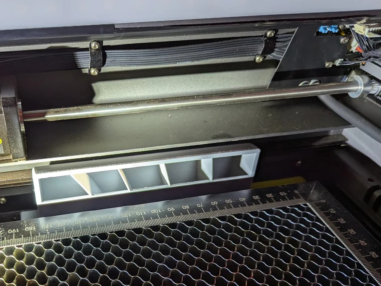

Falcon2 Pro Enclosure Intake Addition
Added a 3d printed intake to my Falcon2 which helps immensely with airflow through the enclosure to evacuate smoke/particulates while still maintaining negative pressure inside. It’s oriented at the opposite corner from the exhaust fan.
Does require you to cut a hole in the drawer which will probably void your warranty. :slight_smile: Not an issue for me so I went for it and this helps.

I have the Falcon 2 Pro 22 watt. I have installed 4 x 80mm fans above the laser on a 6mm MDF board. I also installed 2 x 80mm fans in the extractor pipe. The workshop is very warm in the summer and this helps with the cooling, and also keep the laser cleaner.
