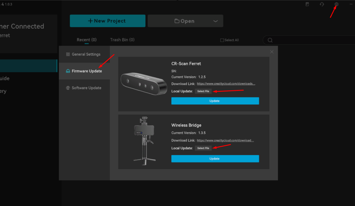

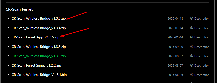

Hello everyone i’m writing this because there were some clues to fix this at the time of writing which is 1st of May 2026
yes you will need to download this version of creality scan V4.1.0.3
from: Creality Scan - Creality Software & Firmware Download
then you will connect to the bridge via WIFI making sure all network interface but the wifi is enabled.
After that open creality scan 4.1.0.3 in device management
download the latest ferret firmware and latest bridge firmware
from: CR-Scan Firmware Download | Creality Firmwares
then the steps i did were:
  1. upgrade ferret firmware
  2. reset the bridge by pressing the pin button for 5 seconds.
  3. connect via wifi
  4. open creality scan 4.1.0.3
  5. go back to device management
  6. upgrade bridge firmware
  7. close creality scan 4.1.0.3
  8. install creality scan 4.2.1
  9. open creality scan 4.2.1
  10. wifi password popup will appear
  11. enter a password, i used numbers only
  12. now it can be used by phones and PCs
download everything and then disconnect from the internet while doing these steps or creality 4.1.0.3 will try to auto update.
hope this helps

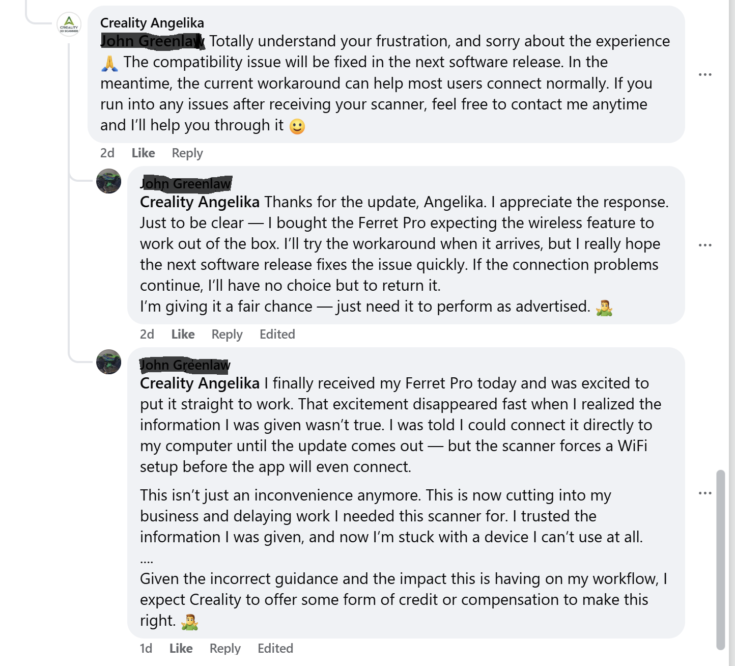

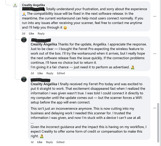

I ordered a Ferret Pro, and the day before it arrived I saw Creality’s post about the WiFi connection issue. I commented on that post, and Creality replied telling me I would be fine — that I could still use the scanner by connecting it directly to my computer until the update was released.
That turned out to be false. The scanner requires WiFi to connect to the app in the first place, so the ‘just use USB for now’ advice was impossible. I received the scanner today and discovered I can’t use it at all because the app refuses to connect without WiFi.
