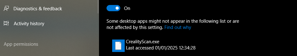

I recently purchased a new laptop and have run into this issue.

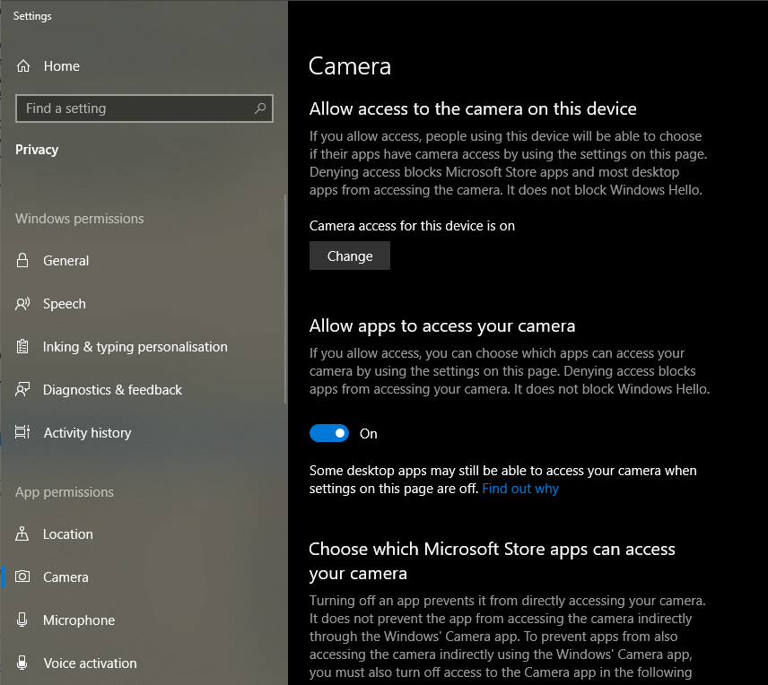

Windows detects the scanner and installs it properly and I have confirmed this in Device Manager and camera settings.
I have enable the camera permissions as suggested.
When starting Creality Scan 4.1.03, it hangs at the performance test and my Ferret scanner is undetected.
Any suggestions?

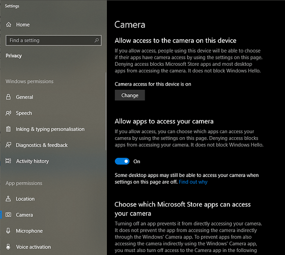

I seem to remember there being more than one place where camera settings could be enabled.
Have you tried the below?
Go to the Windows start menu and type “Privacy”.
You should see an icon shaped like a padlock with the words “Privacy Settings” next to it.
Click on that.
On the menu down the left, scroll down to “App Permissions”, and select “Camera”
Make sure that “Allow apps to access your camera” is switched on, and then scroll down until you see CrealityScan.exe, and make sure that it’s in the Allow section.
I’ve done all of of the above. I’m not sure if this is an accessibility issue or an issue with the software security check that isn’t completing.
