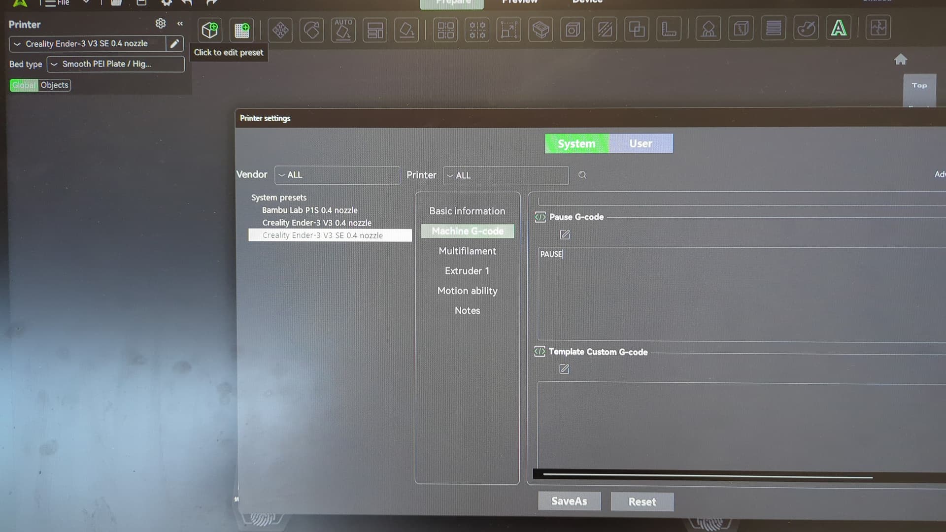

Hello, I have a problem with pause at hight option in Creality slicer 6. I have Nebula pad installed, it works well and I do not have any problem with it except the pause at hight option. I want to change filament midprint. I set the pause in slicer but my printer pause at specific point and do not park the print head, then after the pause I can not resume print as well… how to make my printer to pause at specific layer, park head, allow me to change filament and hit resume to resume printing at point where it pause ? Any idea ?
I have the same issue!!! Have you managed to find a solution?
I’ve found the solution!!! The printers setting is to send the gcode M25 when you set a pause. This seems to work only when printing from SD-card. To make in work with the nebula you need to send the command “PAUSE”.
Go to the printers settings - Machine G-code - scroll down to Pause - replace M25 with PAUSE - save as (it won’t let you overwrite the standard)
