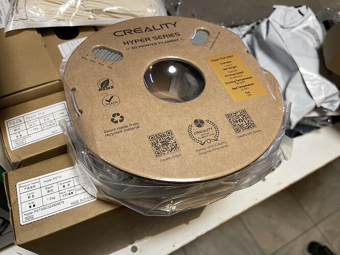

I ordered 5 spools of gray hyper PLA from the U.S. Creality store a couple days ago because: US $17/spool when you order 5+.

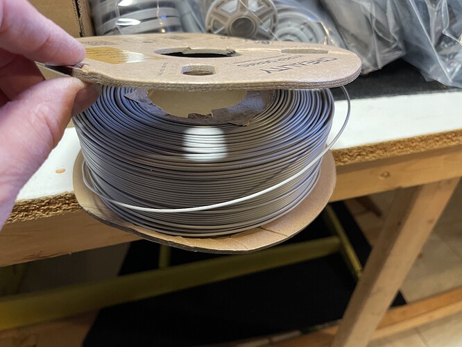

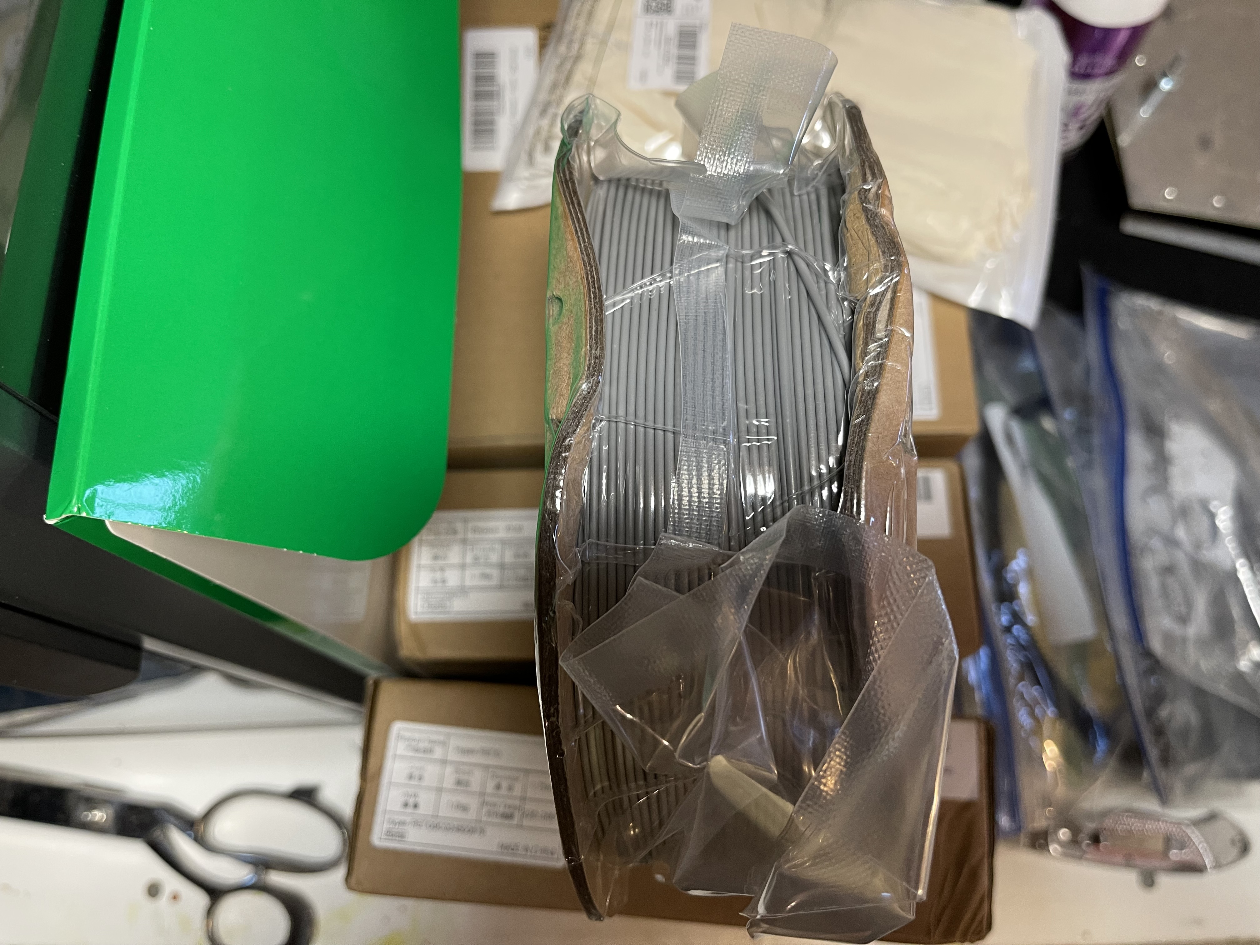

They arrived today and it’s as if FedEx threw the package down 3 flights of stairs. :confused:
All the cardboard spools are damaged:
I’ve had some great luck —no issues at all with this K2 (despite FedEx’s best efforts to damage it when they delivered it to my house)—and I don’t want to start having bad luck now.
I can straighten out the cardboard spools, but the damaged areas all have the rigidity of a wet noodle. SHOULD I TRY TO RUN THESE, OR SHOULD I COME UP WITH SOME KIND OF PLAN “B”?

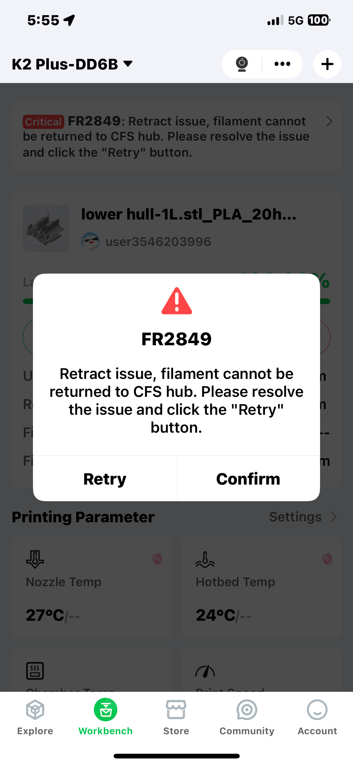

Well, the printed rings was a good try—I’ll have to see what’s going on when I get home from work. I figured the only time these mangled spools would be a problem is during retraction:

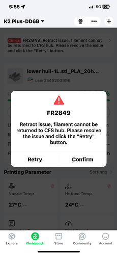

Ugh…got home to find this (expected):
What I DIDN’T expect is that slot 2 of the CFS ain’t sounding “normal” now and doesn’t rewind so good either. Sounds as if a gear in the drive mechanism is partly or fully stripped.

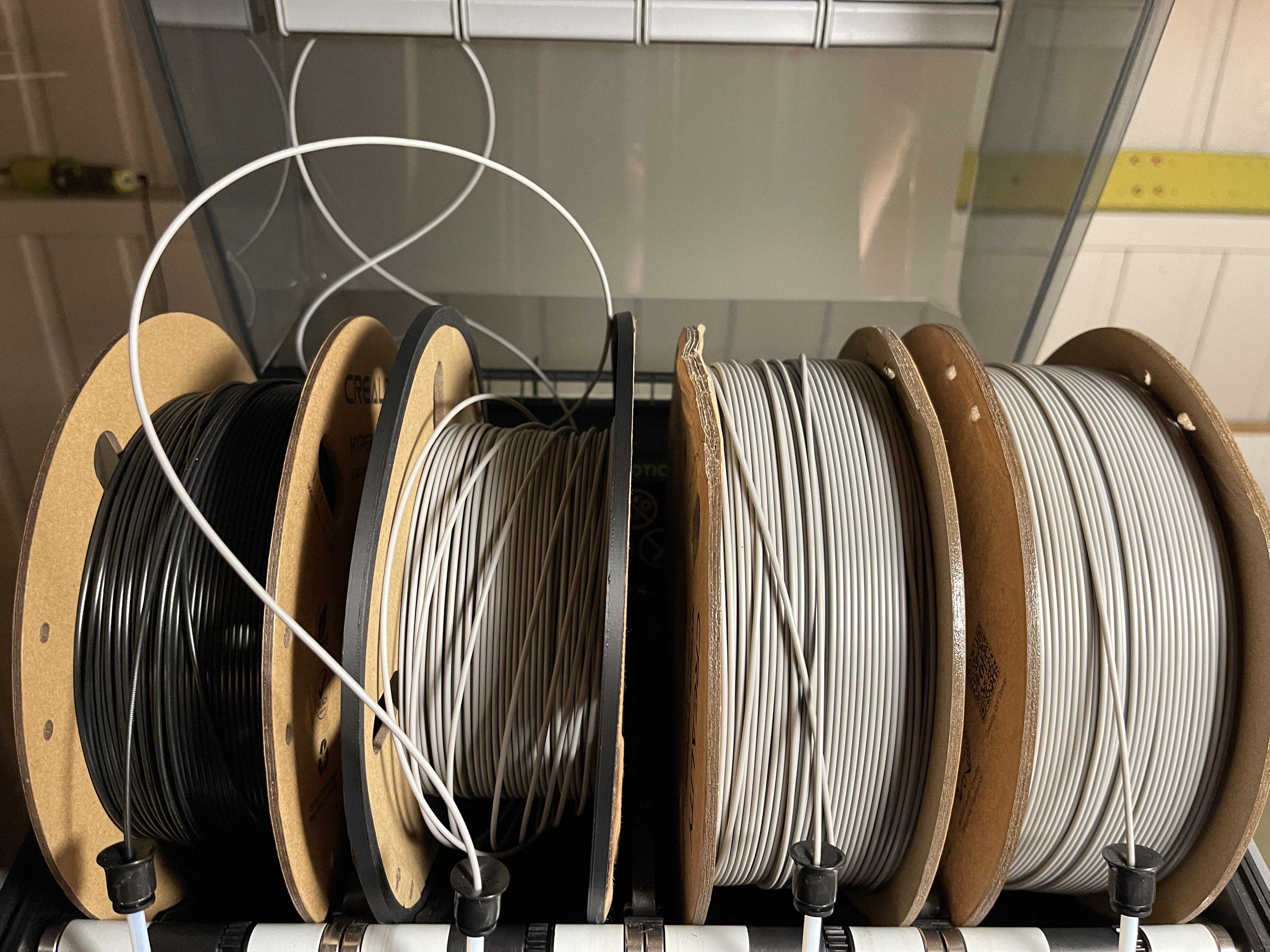

Slot 2 is knackered, but so far, the spool in CFS slot 3 has managed to function OK with the printed rings on the spool. Good thing, too—I wanted to be there to help the CFS retract after the 19 1/2 hour print job, so I set my alarm to be there just before it got finished, but it finished an ENTIRE HOUR early! I can’t believe how far off the slicer and Creality Cloud app are in their print time estimates!
Finally, to wrap up this thread, I only just now realized something obvious—all of these 19 hour build plates are using a single filament. I can just run these mangled spools on the external spool holder. :man_facepalming:
Ha!—Nope! FedEx made EXTRA sure I wouldn’t be able to run one of the 5 spools they mangled, out on the external spool holder either!:
