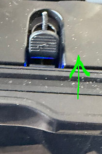

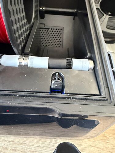

the filament is stuck in there how can i get it out? its not moving at all
Hello @No_Name ![]()
You should be able to push that lever in front of the stuck filament to release it…
Also check the roll of filament that was in there to make sure it’s dry. When it breaks like that it usually means it needs drying.
yeah im pushing it upfront but still not moving the other 3 filaments are working just fine just this one does not
