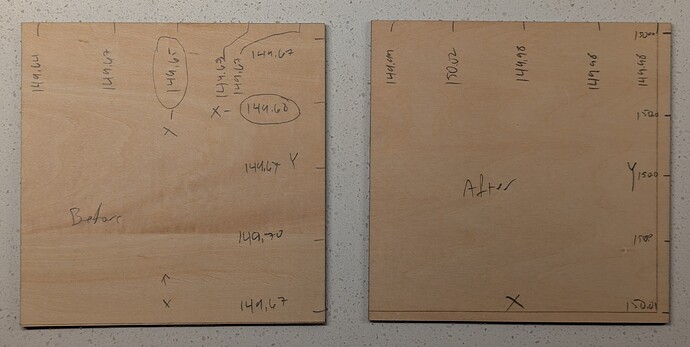

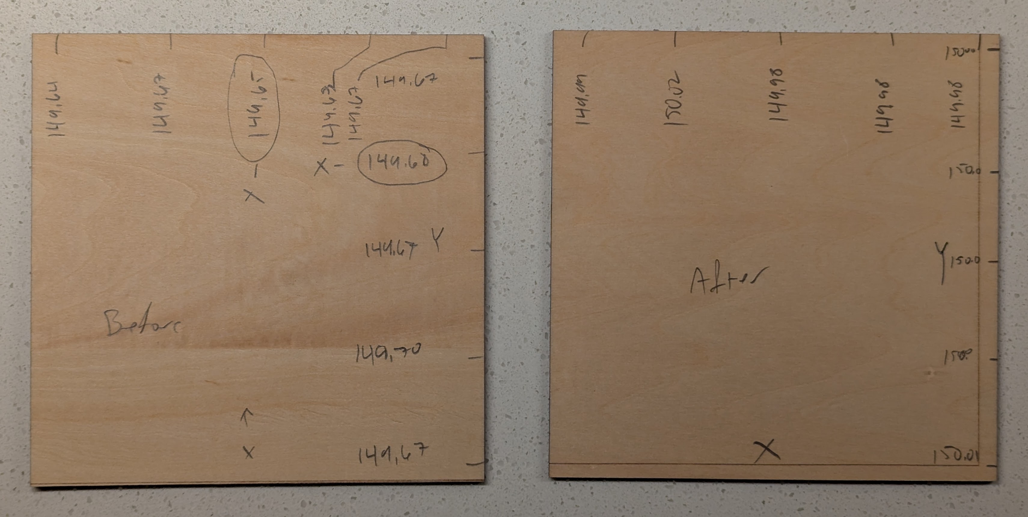

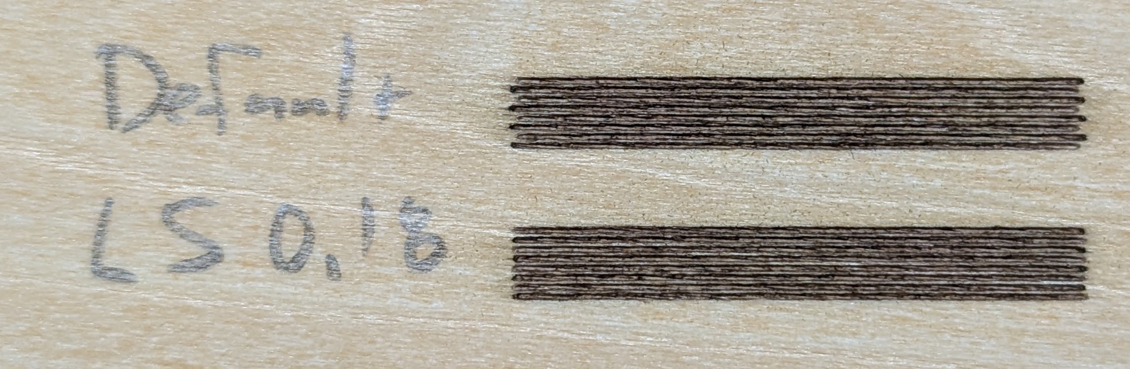

I highly recommend anyone running Lightburn on their Falcon2 to do these steps. Takes about 30 minutes and your fills will be cleaner and you can ensure your have dimensional accuracy when cutting items. Before and after pics below. Makes a huge difference with detailed work.
Scanning offset adjustment - before and after. Also turned up the lines per inch from 254 to 300.
