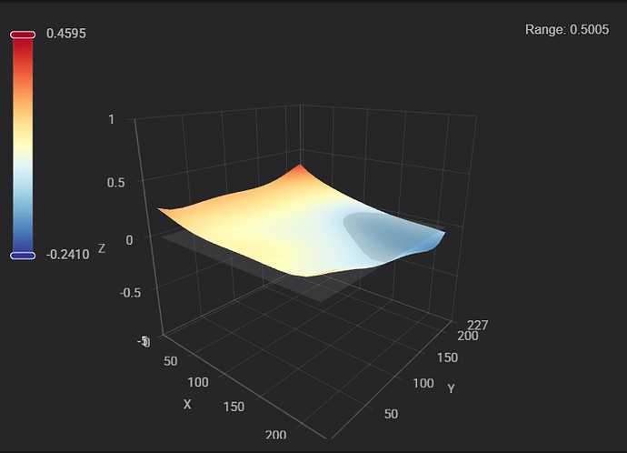

Same issue here. I’ve tried tooth skipping method, print shims to level manually, but looks like my bed is warped.
depends on potluck on what bed quality you got, but can you try setting bed temps to whatever you need for 10 minutes and retry mesh calibrating? seems the sweet spot for it to stablise
Yeah, tried that, 15 mins @ 70 degrees. Results are pretty much the same. I’m starting to consider to replace my hot bed, or do the glass bed mod.
Hi, I also have a problem with the first nar. I calibrated more than 10 times as in the video but it did not work perfectly. I have a problem that in the cent there is +0.11 from the front +0.018 and from the back -0.061. I have pads under the table legs. how can I fix it?
that graph looks like a tilt in the rear z-axis lead screw… get these here in the rear to at least tilt it in the right direction as a new bed is not going to fix a tilt, only flatness.
