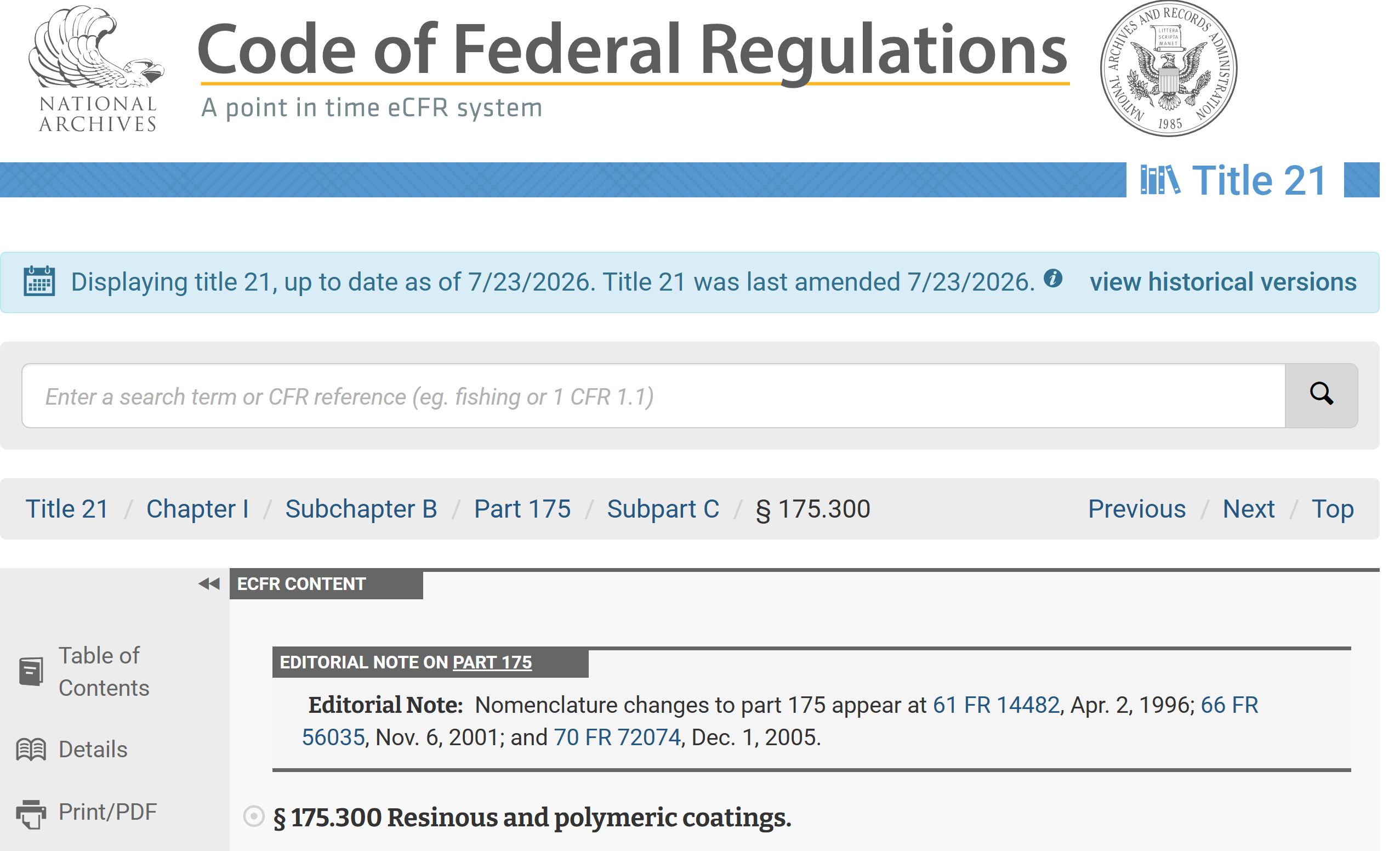

If you’re really bored and/or having trouble sleeping, here’s the regulation in the US that covers what is food safe:

Also, thanks for the reference to the US legislation, that is an interesting piece of information (I work as a regulator but in a different field).
