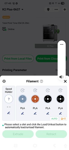

My CFS is showing still connected to the printer. The filament menu both on the printer and in the app for the spool holder shows no filament.

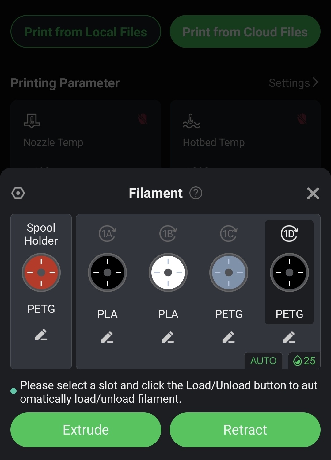

Are you are not getting the side spool showing up in the phone app ?
It should look like this (for a single cfs)
If you’re not even getting this while idle..then maybe you haven’t bound the device to your account.
You should be able to remotely extrude / retract from the side spool, from the phone app.
Even change the filament type/settings via the app

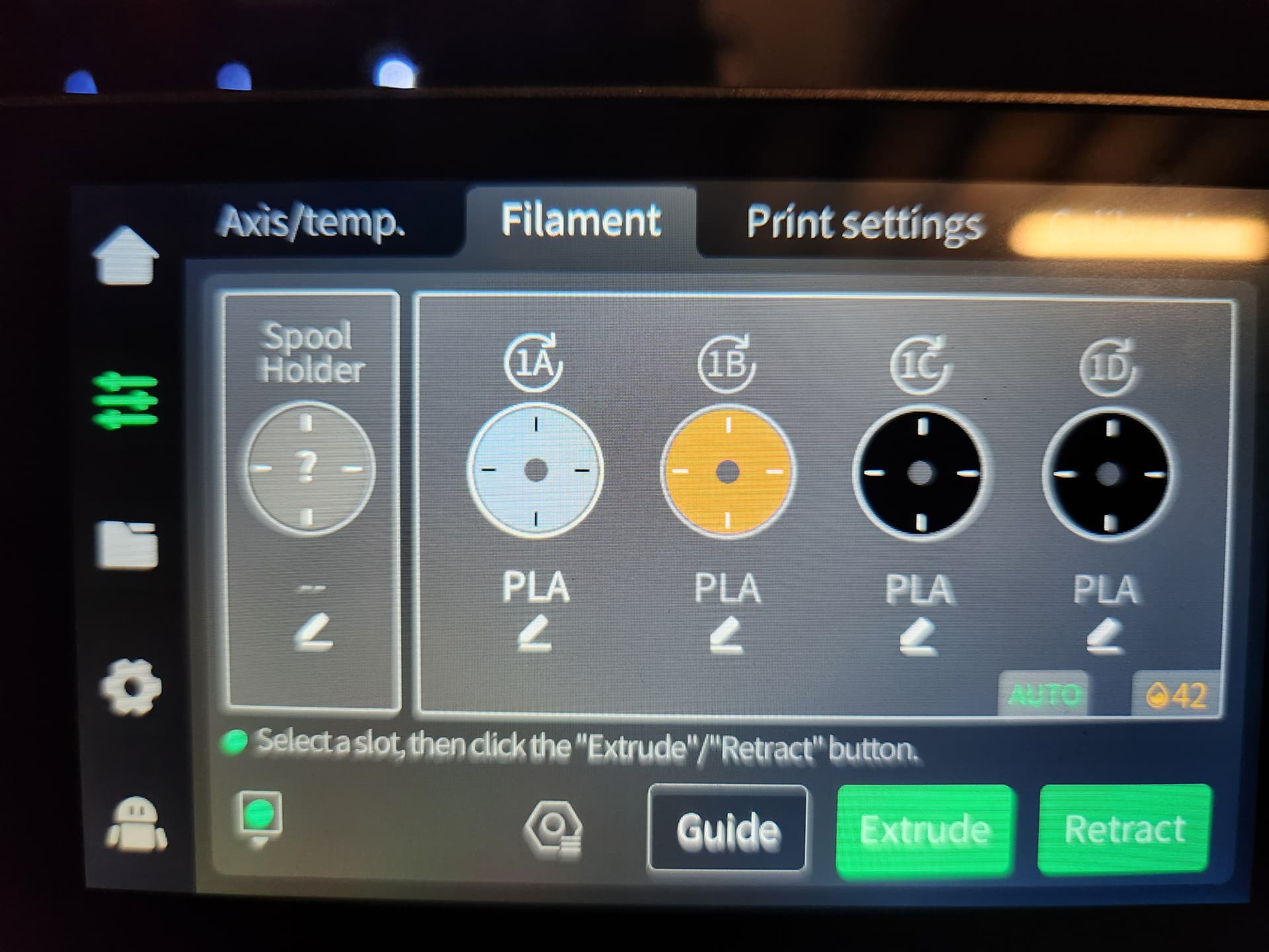

The Spool Holder is showing up as empty on the Phone App, Desktop, and the Printer. Having never even installed the Spool Holder onto the printer and never used it I would expect this to be the case.
I have only ever used the CFS.
Ok what your screen shots show is it all working as expected… there is no relationship from the physical side spool to the system, you just have not assigned any filament types to the side spool.
How the K2 operates, is if the external side spool is selected, then the K2 does not feed from the CFS, but only uses the filament detector inside the extruder to detect if there is filament or not.
So when its saying side spool detected, without any filament loaded from the CFS, this means the extruder is detecting filament, either broken off, or something is activating the filament detection spring… this is located withing the extruder, as part of the extruder front cover you remove to clear jams.
