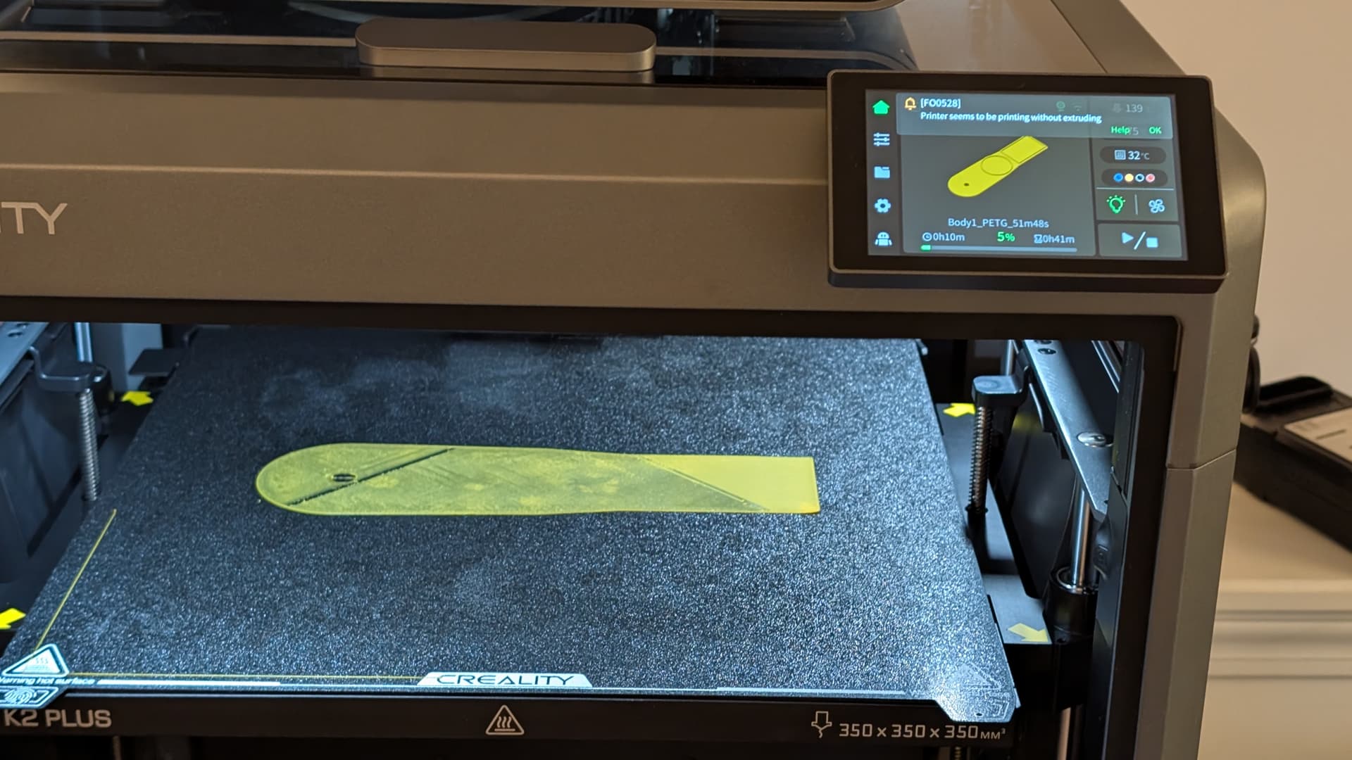

I have tried a few times to print objects with PETG and sometimes they come out fine and other times they fail with either an FR2865 or FO0528 error. It seems that the two objects that failed (twice each) had fairly large first layers and they failed on the second layer.
This shows the build plate after the failure (fidget toys). You can see that the lower left was part way through the second layer and the upper left shows a glob of filament that would have ruined the print.

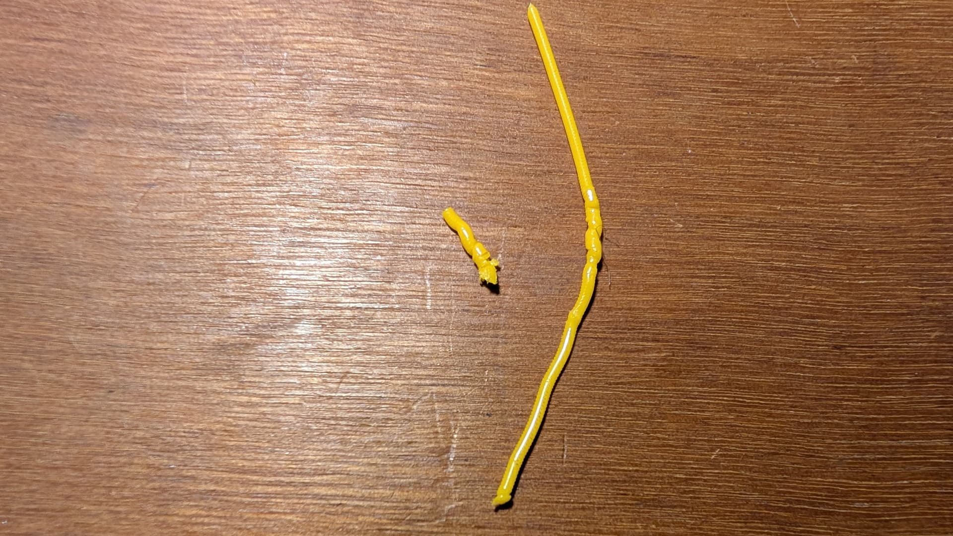

The second photo shows what I cut out of the extruder. I got the long piece the first time and the short piece was more melted and I had to cut it.

The other object I tried to print also failed on the second layer and I tried to print it again and it failed in the same way.

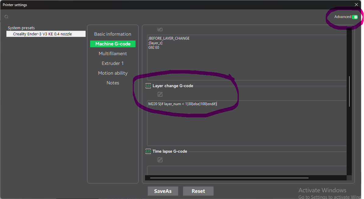

I have my slicer setup to forcefully slow the first layer down, since doing so I have experienced nearly no first/second layer failures.
I mostly use Orca slicer these days and just add the following to the printer’s “Layer change G-code”:
M220 S{if layer_num < 1}30{else}100{endif}
You can do this in Creality Slicer as well, just have to enable the Advanced settings in your printer profile.
This forces the fist layer to run at 30% speed, adds a bit to the print time, but my first layers are almost always perfect these days with just about any type/brand of filament.
There’s other ways to do this of course, but I find this to be the simplest for my uses as it’s automatically added to everything I print on that print profile.

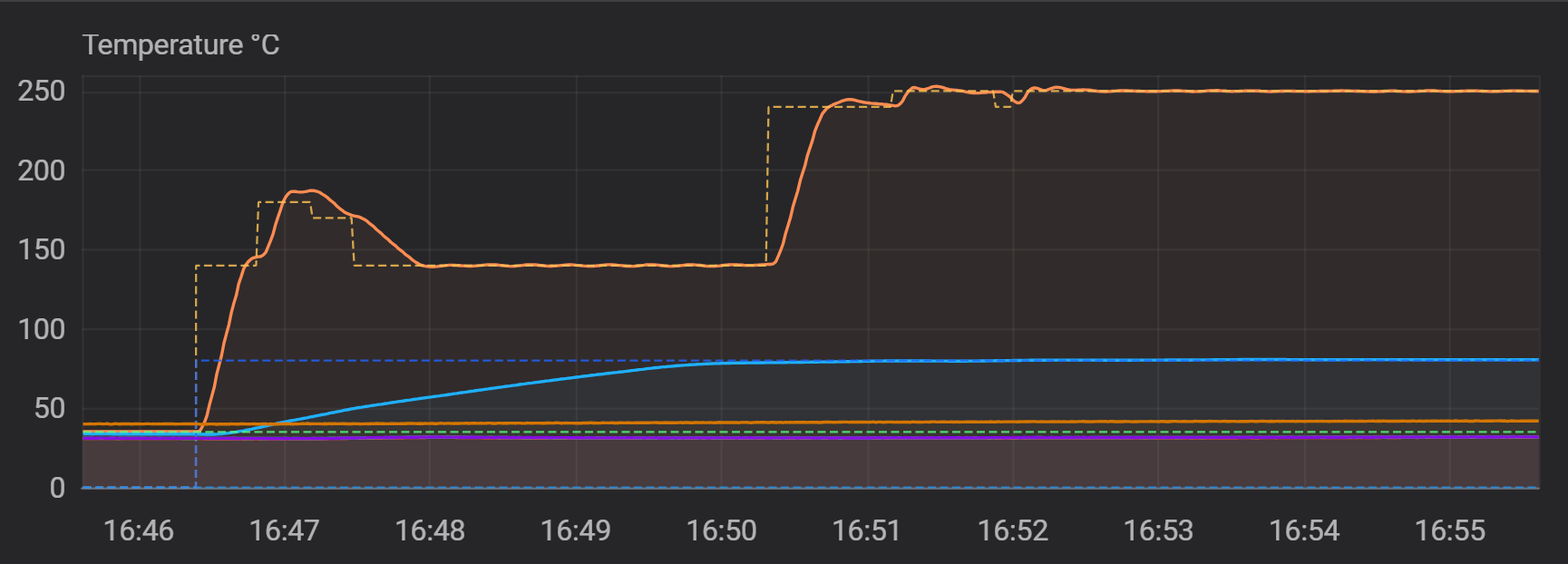

Have you been watching your hot end temperature while printing? I found mine would drop after each layer and then it would clog. The culprit was “Auto temperature”. It was turned ON and the factory settings were for PLA not PETG, so it kept resetting it. Make sure Auto temp is OFF in the filament settings or fix the Flow Temperature Graph for the higher temperatures.

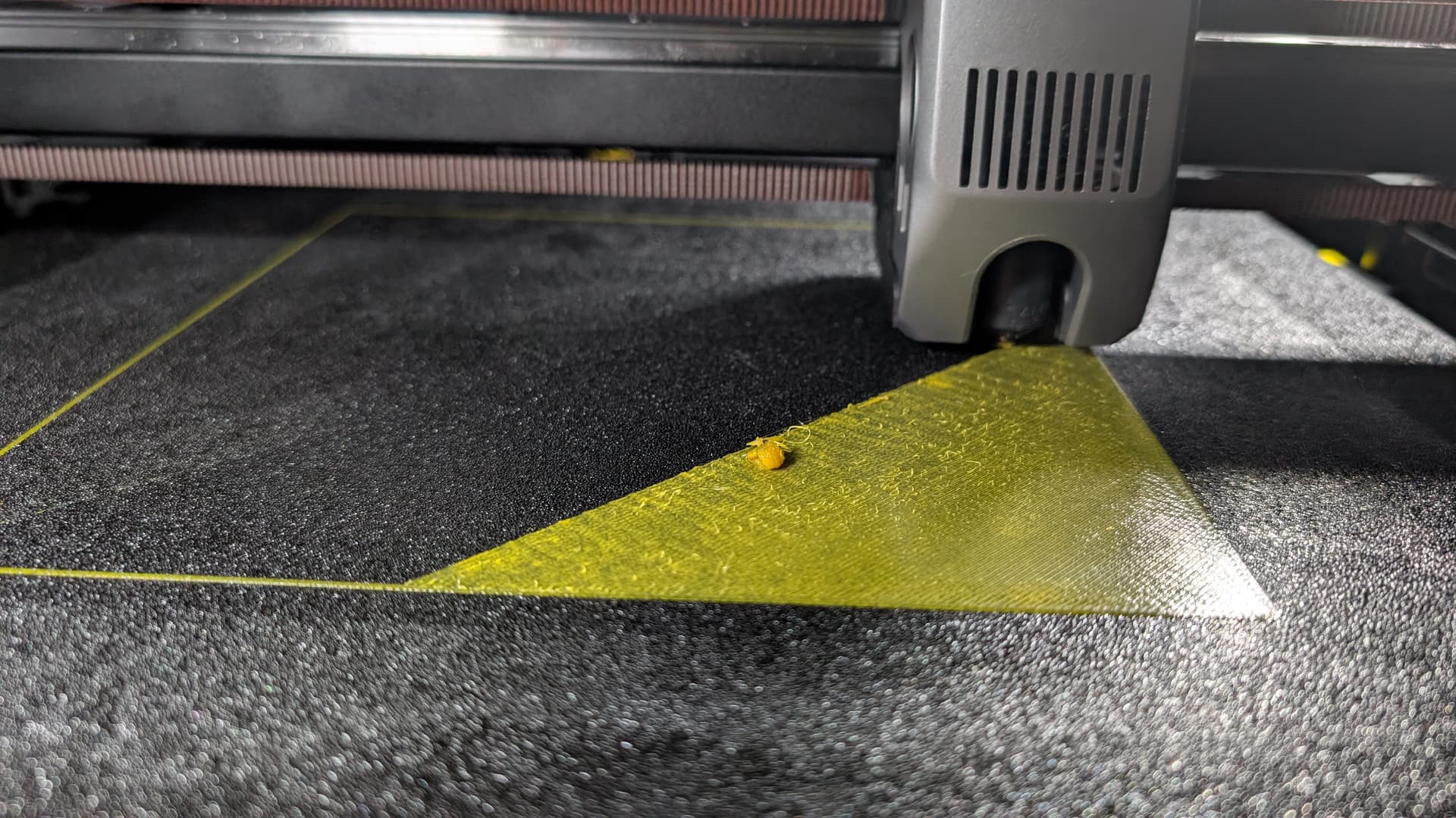

Back from traveling and I tried the suggestions quickly and they did not work. I did some PLA parts and I feel better now. I am getting back to this and gathering more data. I did a run today printing a 200mm x 200mm x 0.4mm plate. The first layer had lots of blobs and I aborted the print, to save myself having to clear another clog.
One of the causes of blobs with PETG is an extruder that is too hot but I already turned it down. Then I looked at the graph of extruder temp and rather than 240 C for the first layer, it went to 250. I set the first layer to 240 and subsequent layers to 235. I even confirmed in the gcode that it sets the temp to 240 at the start and after that it switches to 235. These are the only M104, or M109, commands in the file.

Here is the graph. It briefly goes to 240 but then goes to 250.
250 does not occur in printer.cfg, printer_params.cfg or gcode_macro.cfg.
I did see what @Darrell_Degner referred to about auto temp. I am using Orcaslicer and I could not find an option for auto temp like there is in CrealityPrint. I do see some “M104 S220” lines in macros and a reference this in printer_param.cfg.

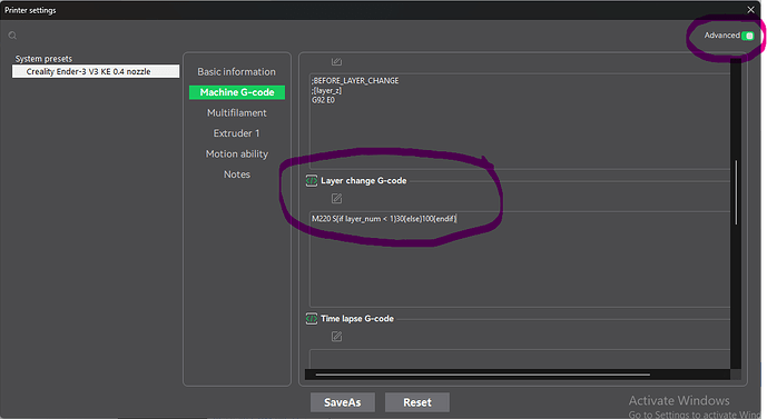

Also, I took @AxMn’s suggestion and I added line to the printer’s “Layer change G-code” to slow down layers 0 & 1. Not sure if that is helping but I will try anything.

The photo looks like the print head might be too close to the bed, the nozzle then tends to scrape along the layer and pick up blobs which it deposits elsewhere. Have you tried raising your Z Offset in your printer settings a bit, +0.01mm increments, might do wonders. I tend to see this kind of issue after installing a new nozzle, so the first couple of prints are used to dial in a new Z Offset.
I print almost exclusively in PETG and first layer at 250c is pretty standard, it helps with bed adhesion.

I bumped the Z offset to 0.03 and it fixed the blobs seen on the previous photos.
