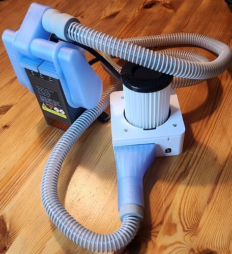

Started to use my Falcon 2 Pro indoors cutting plywood, found that the smoke was a bit overwhelming! Connected the flextube to a wall exhaust with a built in fan. It solved the smoke problem but my neighbors did not like the smell. Now I designed a particle and carbon filter that solved the smell problem. By also introducing a HEPA filter to the laser head ventilation, I don’t need to clean the head any longer.
This is my system to get clean air into the laser head. After now more than 50 hours use cutting 3-5 mm plywood the head is clean from dust! The filter is a standard HEPA part for a compact vacuum.
