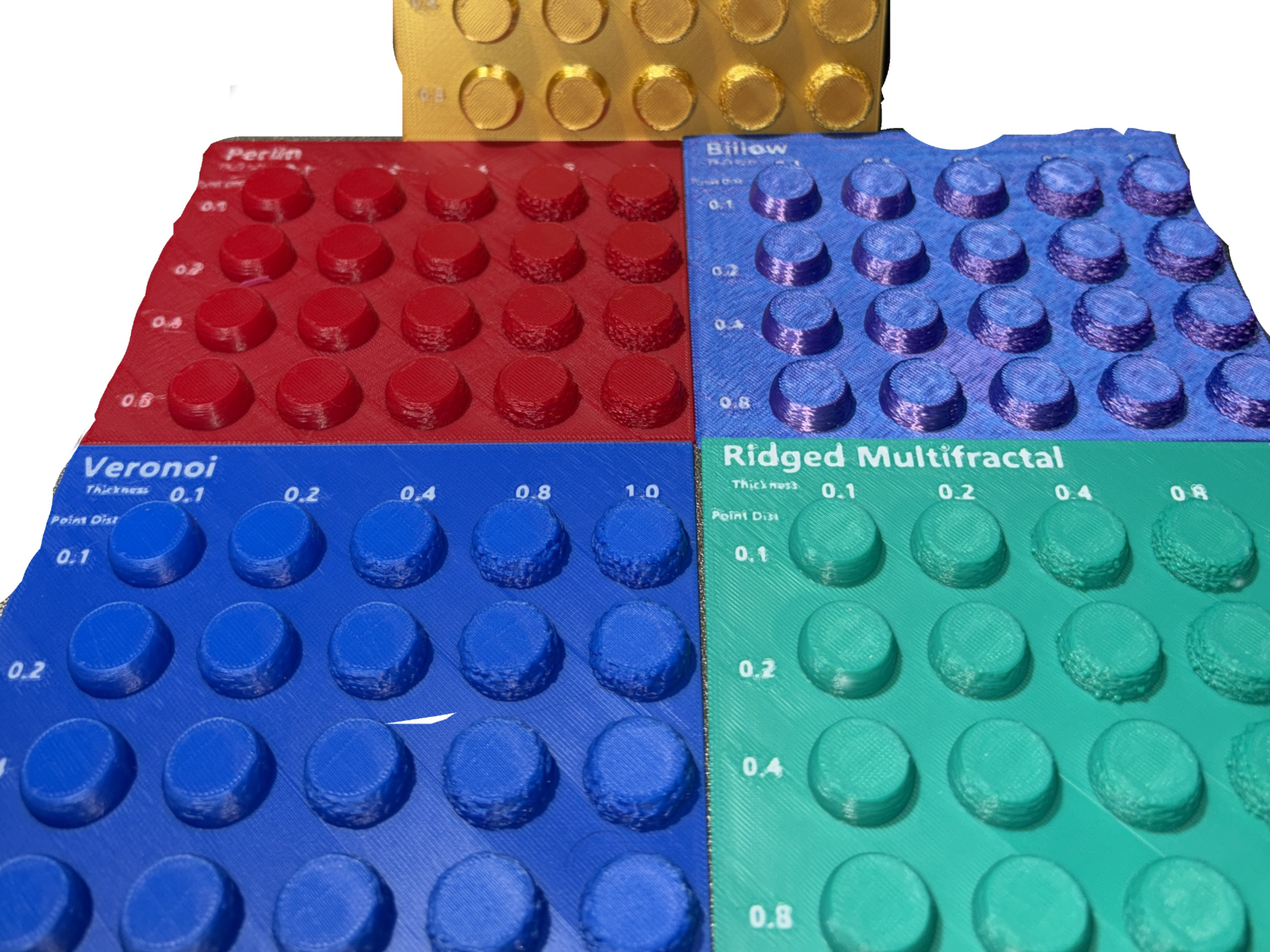

Fuzzy Skin Settings Decision Helper/Testing
The Fuzzy Skin Decision Helper is designed to assist 3D printer enthusiasts in selecting different surface texture options based on four main noise types: Perlin, Billow, Veronoi, and Ridged Multifractal.
Each section clearly showcases distinct texture variations with adjustable parameters, providing a tactile reference guide.
This model and related plates are to help users who use Fuzzy Skin more than occasionally or need help on deciding the correct settings they need to get the effect they want.
Fuzzy skin can create a pleasing visual affect but I found it does not hide the seams as well as I would have hoped, without higher thickness and point distance.
Besides visual affect the practical usage would be things like improving grip on certain part of a model.
Assumptions - can by changed as needed:
Fuzzy Skin: Contour
Fuzzy skin generator mode: Combined (displacement=nozzle movement v. Extrusion-fast)
The 5 different Fuzzy Skin Noise types are done on separate plates.
Did not apply fuzzy skin on first layer.
Changed Wall generator to Arachne
Since Fuzzy skin is not meant to be used on top surfaces and in fact seems to ruin them, I cut of the tops of my spheres used to display the fuzzy skin effect.
