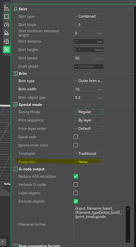

Trying to use the fuzzy skin. The YouTube video is useless to me. His screen looks way different than mine. PLEASE someone give a step-by-step procedure for finding this feature, if it exists.
Also, the slicer BADLY needs a search function.

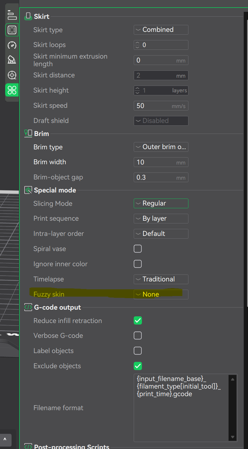

I just tried fuzzy skin myself. It is under advanced, special mode, at the bottom

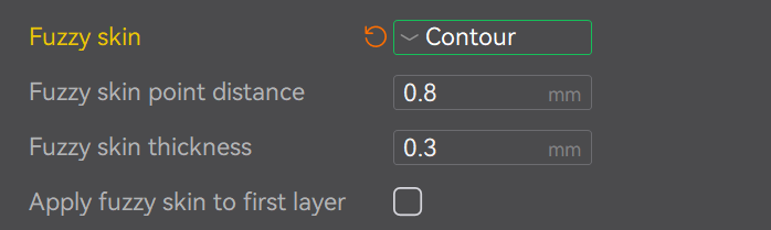

Once a type of skin is chosen, it opens up these options:
I just used the defaults on my first try. It is an interesting texture. Looked good on the cat model I was printing. Note, fuzzy skin is hard to paint.
