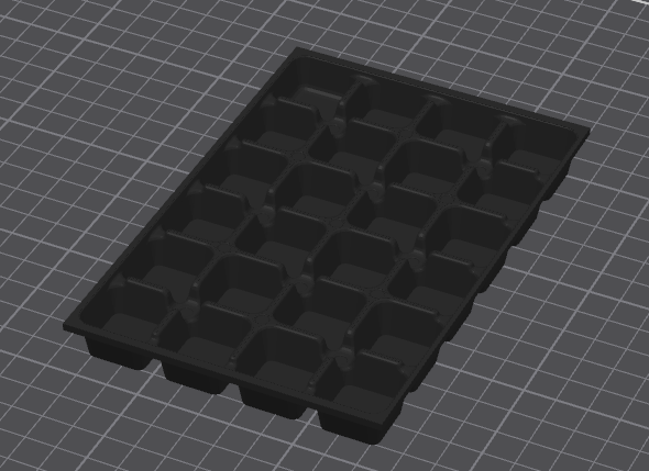

I didn’t mean “longer” in terms of time but length of the g-code. Was that a simple object ?
no, not quite:
