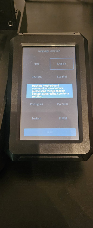

Ik heb een Creality Ender-3 V3-KE en heb nu een probleem met de moederbord.
Deze is namelijk nog maar kort vervangen en nu krijg ik te lezen op de display dat de communicatie met de moederbord niet goed is.
waardoor ik nu niet kan printen.

Can only think connection between screen and motherboard isn’t connected properly. Double check all of that, could even be a damaged ribbon.
Sorry for the late response.
But the ribbon is not damaged and it is connected properly.

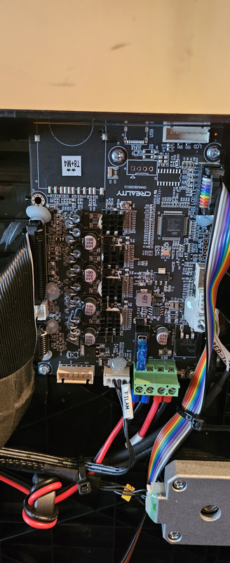

I have now checked the motherboards, the old and the new.
And I saw that there was a light on the old one, but not on the new one.
Does this mean anything?
Hello Eagleseye,
Looking at the photo’s, the old one has no glue but the new one has…it that correct ?
Cheers.
Yes that’s is true.
I have to do dat zo i kan remove the kabels from the motherboard.
The company has glue the kabels on the connectors.
I contacted the online store where I ordered the motherboard.
And they sent me another motherboard.
The other is returned.
And this one works fine.
