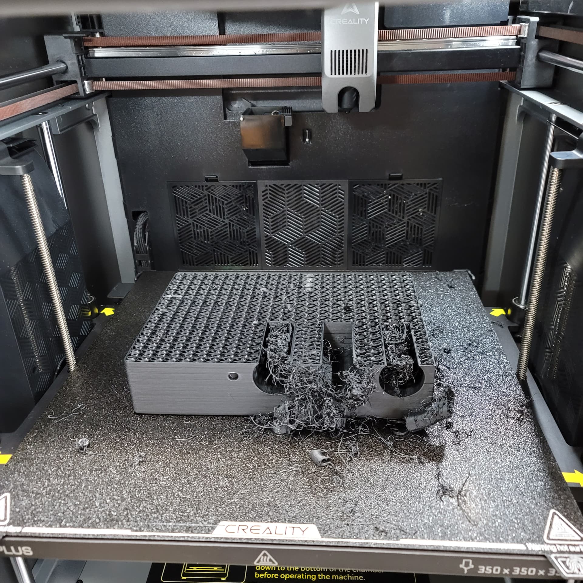

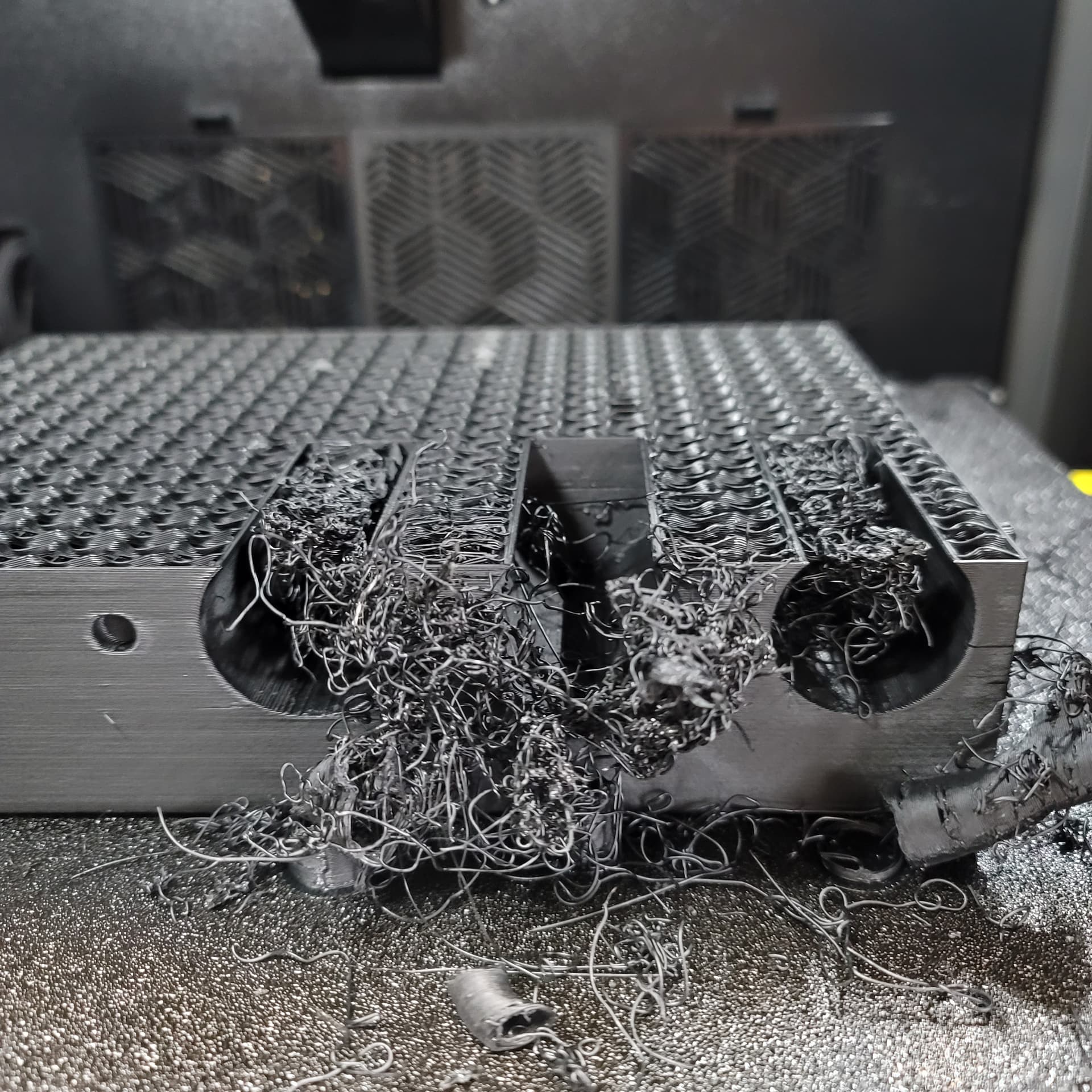

Started out a week ago with a new K2 Plus combo. The benchy and a couple of other models printed fine and looked very good. However, I spent the last few days trying to tune a PETG filament. Did flow and pressure advance calibrations, checked bed leveling, etc. I’ve been through 3 spools with nothing but trouble and have been trying to get a successful print, but it gets to maybe 50-60% complete and then fails.
The AI detection is useless, it just does not work. See photos. I’ve already changed the nozzle and no improvement. I’ve slowed the speeds down to 100mm/s and below, but still can’t get a complete print.

Look like support failed, does those part/section need support and part hit the nozzle causing it.
Yes, you’re correct. After close examination the supports(tree) were weak and some of them weren’t formed correctly(maybe due to support speed being too high). The nozzle must have been shaking the supports and the weak ones knocked over. The nozzle then must have been extruding in air where the supports should have been and then resulted in the building of the spaghetti. I checked my filament settings and I forgot to enable z-hop in filament overrides so that made it worse.
I lowered support speed, enabled z-hop, and made the supports a bit thicker. Then I ran the print again and it was significantly better. It completed with no problems(12 hours), so I’m happy with the results now. I concluded that for PETG you can’t go too fast. I re-ran PA and Flow calibration and also re-leveled and raised the Zoffset to about +0.05. First layer now comes out beautiful.

I’m pretty sure it was a support problem coupled with Z-offset too low. Also I noticed I had checked “Reduce Infill Retractions”. Apparently, if you check that option, it will not do retractions when moving over infill areas. As a result no Z-hop occurs on those travel moves. Without Z-hop the nozzle likely hit some areas and broke some of the support trees, leading to the mess.
I understand that now. But what’s not obvious is why didn’t the advertised feature of “AI spaghetti detection” not catch that and stop the printer or send a message? I had AI enabled on the printer.
In my experience, nothing-AI works. Keep hoping for some firmware updates… Anyways, also check the infill-to-wall-overlap percentage. Many profiles (were? are?) using 30% which is far too much and causes too much pressure at the edges, leading to knocking stuff over - changing to 15% may help.
