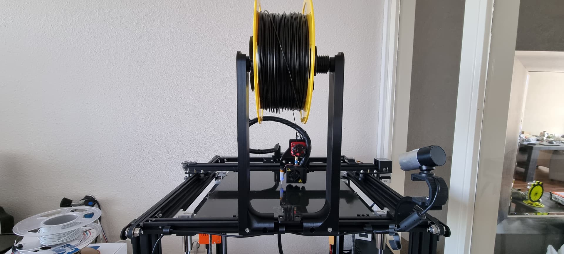

You can convert it very simple to Direct Drive… You can download a bracket to 3D-print that makes is possible to attacht the stepper motor from the extruder directly on the carriage of the hotend. The only part you need to order is a extension cable for the stepper motor.
STL-file for this bracket can be found on Thingiverse. If I have some free time tonight I will post link and photos of the conversion.
Bracket –> https://www.thingiverse.com/thing:4310609
I also have made some parts to mount the role of filament on top of the machine, will see if I can find the files and share them with you
