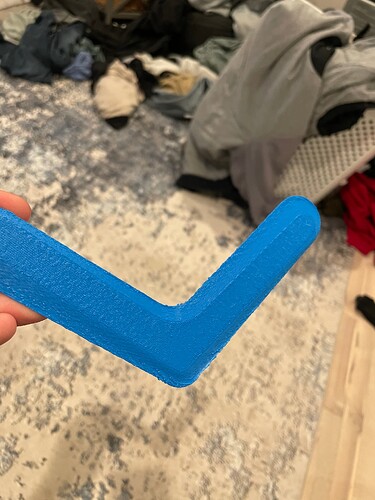

I got one or two good prints out of my printer before prints started looking like this. with or without auto calibration it looks bad it looks like the printer is struggling to extrude bed mesh included for reference
0.9mm over that sized bed is pretty good. Looking at the prints having a little feathering to the edge the z offset looks a tiny bit too close. Find one of the single layer test prints and see how that prints so we can see that too.
I’ve seen a helluva lot worse. Looks like the z-offset is too low but only 0.05/0.1mm, that gives rippling and possibly flowrate a little high also rippling effect. A few minor adjustments should get that sorted. 0.9 variation on the bed will easily be coped with in the autolevel.
