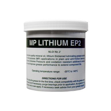

Thank you gents. I’m thinking that 500g tub of lithium grease will do me very nicely for the price. I’m a chemist (industrial, not pharmaceutical) by training, so the one rule I would have known would be the “avoid solvents” one. The others I’d have worked out, but I just wanted to make sure there wasn’t a “must have” or “steer clear” product.
I’ll stick with grease rather than oil more because of my Parkinson’s…one twitch and there’d be oil everywhere…I feel grease will be more forgiving/controllable.
