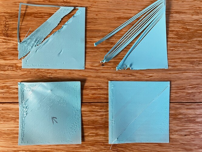

the first prints are in the photo top to bottom 1,2,3,4 show my issue i have not adjusted anything just printed the same test layer 4 times all with different results

I don’t know much about adjusting that particular printer but what was your bed leveling procedure?
Adjust Z offset.
Once you get the bed level then the Z offset (or how close the nozzle is to the build plate) needs to be adjusted. I could be wrong but your nozzle seems to be too close.
thanks for the reply wow super quick response i have spent a long time watching lots of videos and following what thay say the bed is perfect the issue is it prints the same model test layer different every time as shown in photos
The bed can be perfectly level but if the nozzle distance from the bed (Z offset) is not adjusted properly it will print like in your pictures :face_with_monocle:
A few basic things to check…
What temperatures are you running?
What kind of filament.?
Is the filament dry?

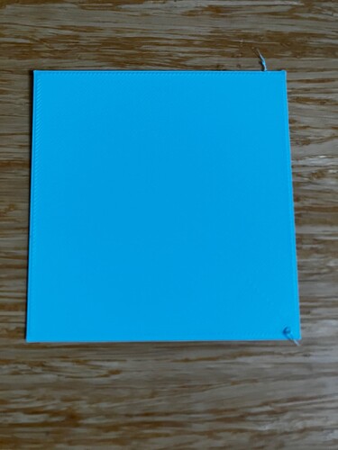

the issue must have been with corrupted file i downloaded so i found a couple different firmware on Creality website and did a update after the first being another altered firmware for cr/bl touch i found this to be working fine (with my limited knowledge that is ) i then checked everything to make sure i had not missed anything did the bed level again and printed the test square however it refused to print watching another video of transferring files to SD card it recommended short file names when saving to sd card so saved it as test 1 and it printed quite good for the first print see photo 1

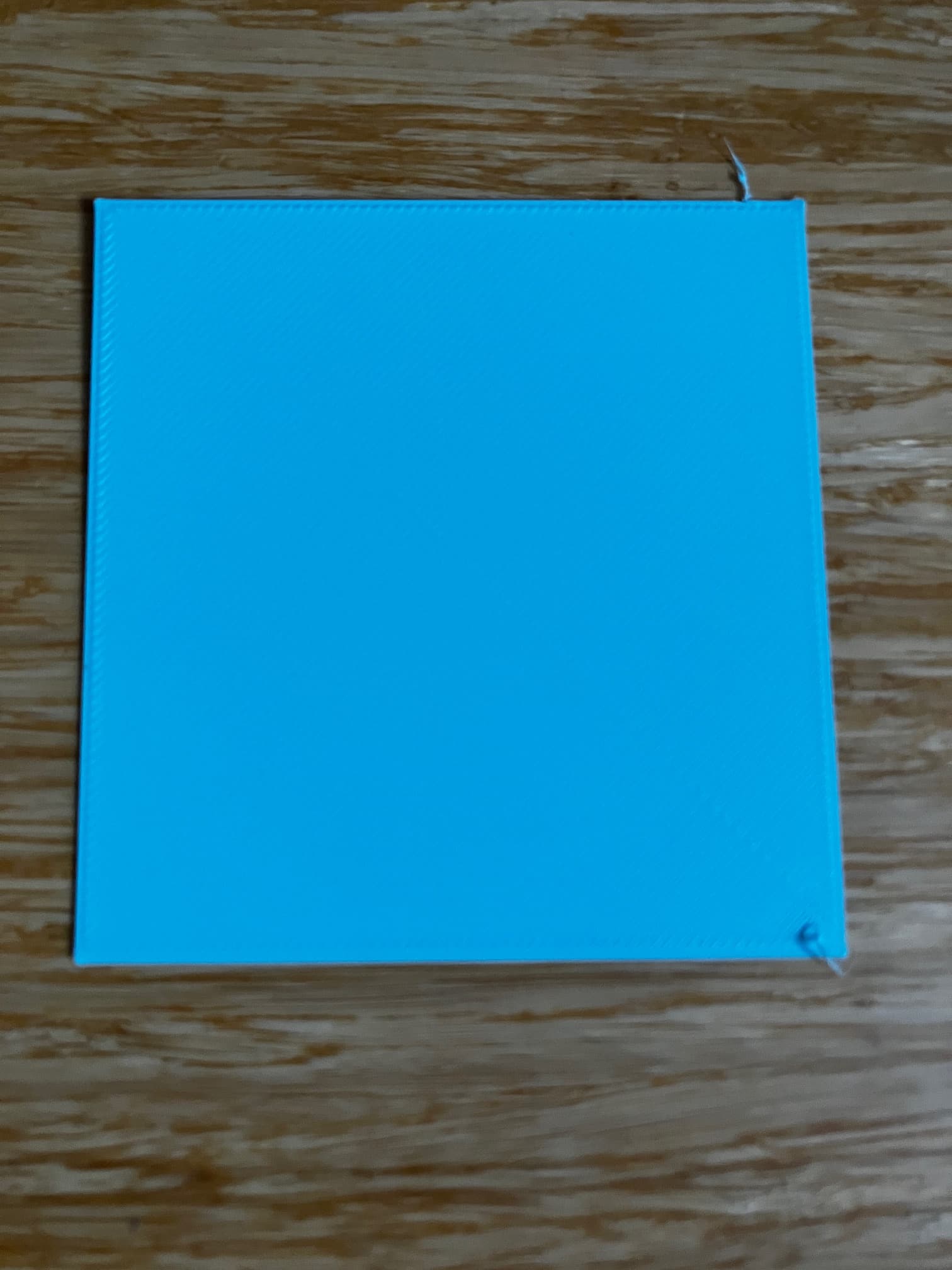

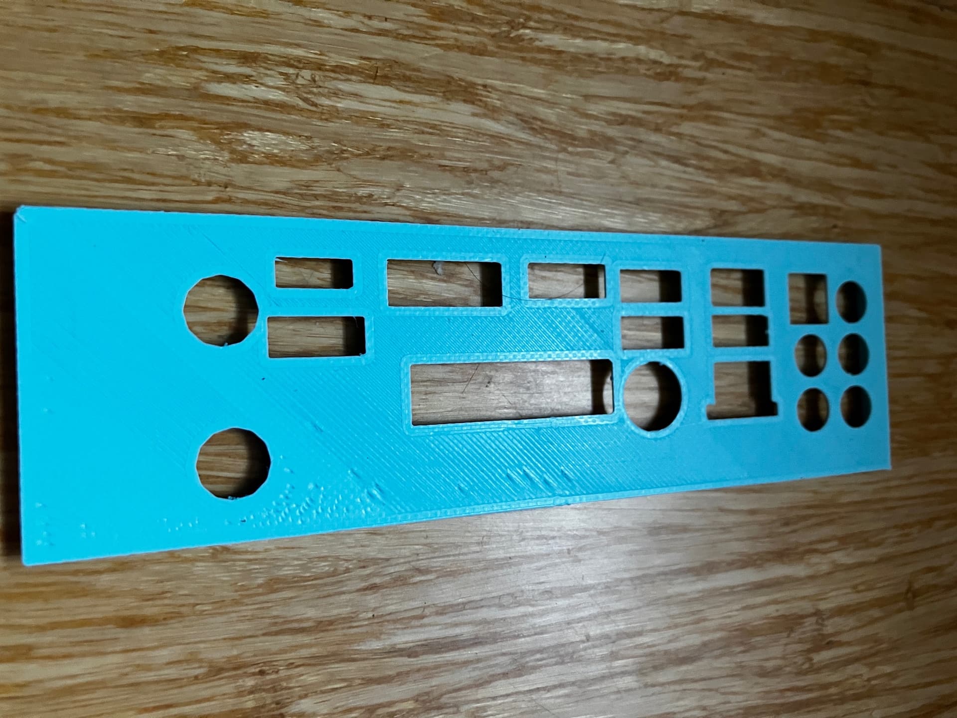

after some tweaking and changing the temps to 220 nozzle and 60 bed this time it remained constant so i then printed my first i/o plate photo 2 looks ok bit stringy and some odd lumps ill upload the end result when done main thing is its working and im sure it will only get better as i get more into it next project is a graphics card stand

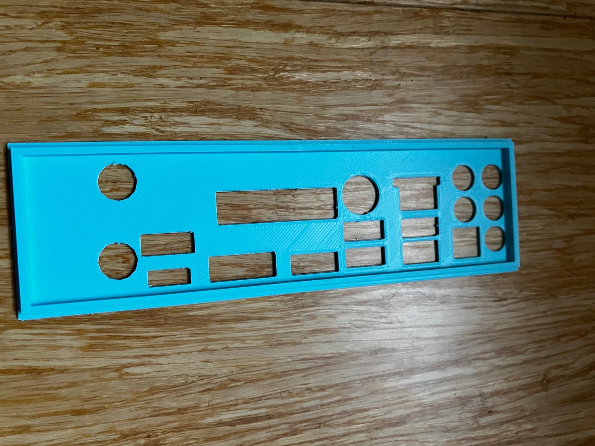

finished i/o plate
Looks way better nice trouble shooting
