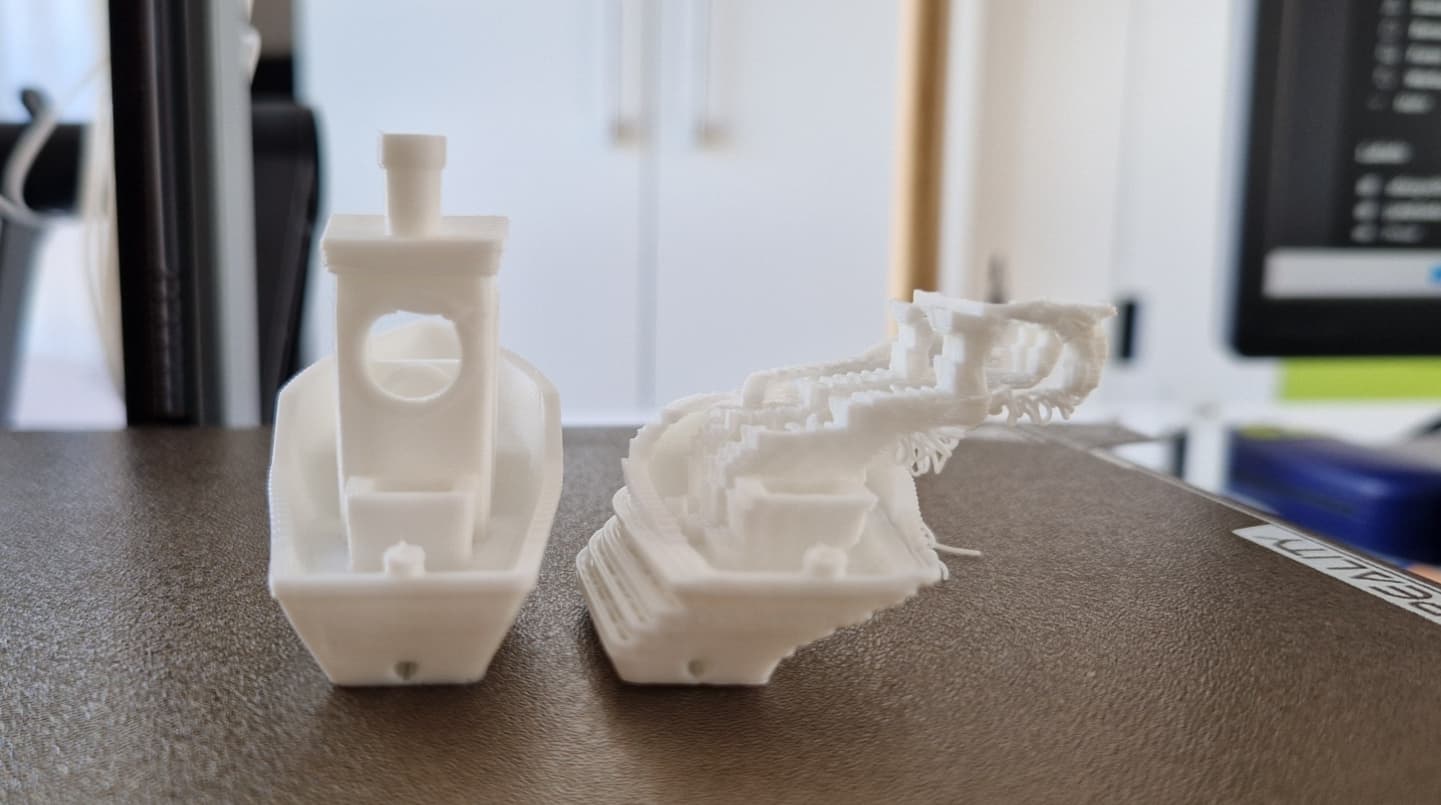

This is how bad I get them
I will have to look into voltage/current test
I shall have to dig out my rather artistic benchy, but yes that is the sort of shifting I get too, but not with 4.3.8 but always with Orca and 5.1.x
Upped the y-stepper current to 0.75 from 0.6, ran a benchy and a saturn stress test and not a single layer shift using latest version of CP 5.1, prints just as well as 4.3.8 now. If only I knew how simple it was to do before now. Opened printer.cfg in Fluidd, changed the y-stepper run-current, save&reboot, all of 10 seconds to fix it. Shall try Orca in a bit to be doubly sure. Orca seems fine now too, was as bad as 5.1 before.

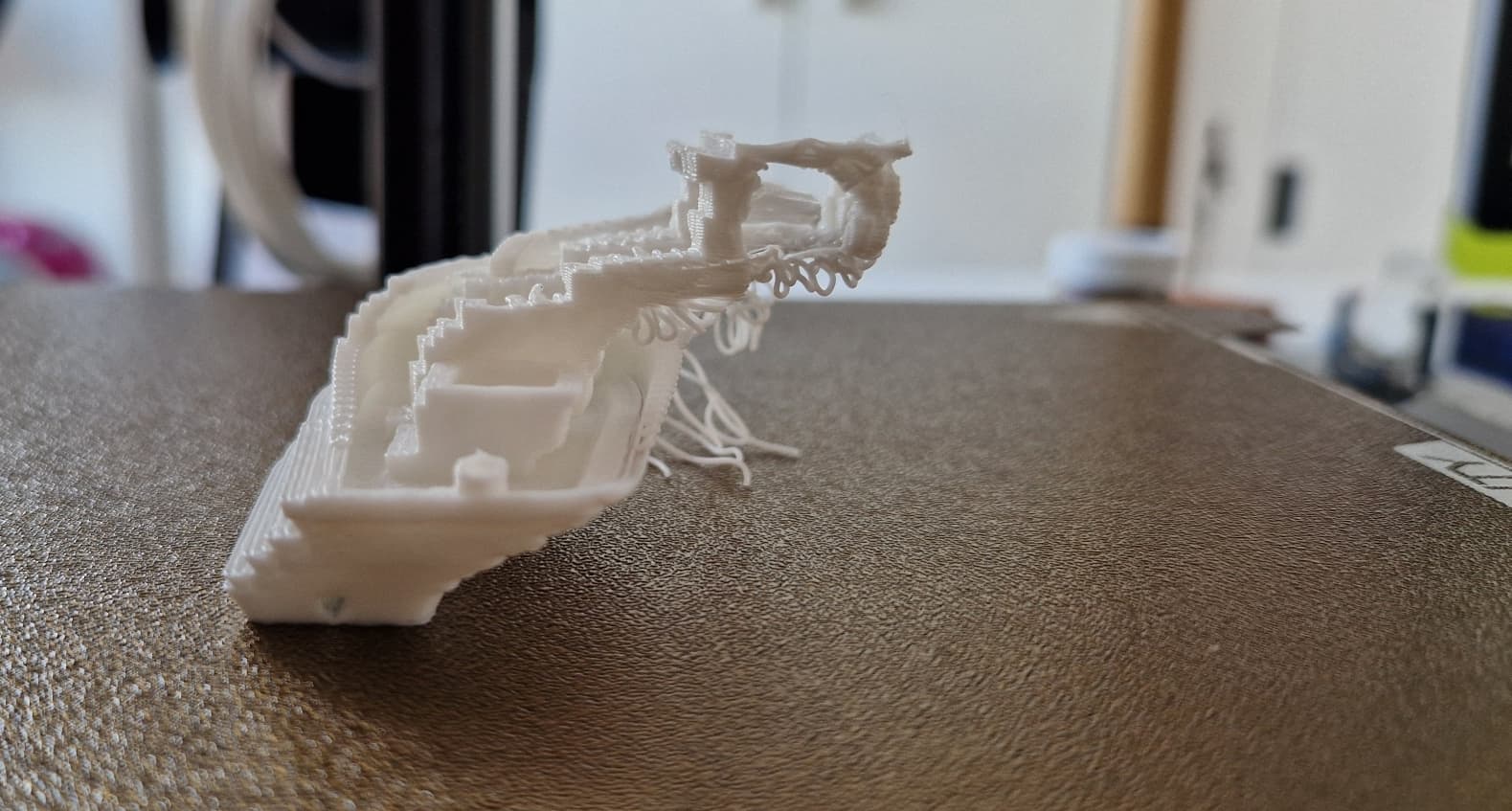

Scrap that it’s now back to its old ways hahaha from this
To this back to back prints
Check the current hasn’t reset, mine has behaved all day.
Just checked it and it’s still set at 0.8 iv dropped it to 0.75 and going to lower the acceleration down and give it another go if that fails there really is nothing left to do
I’ve not changed any accelerations or speeds just the current. Been printing white PLA, which I normally struggle with, been totally fine.

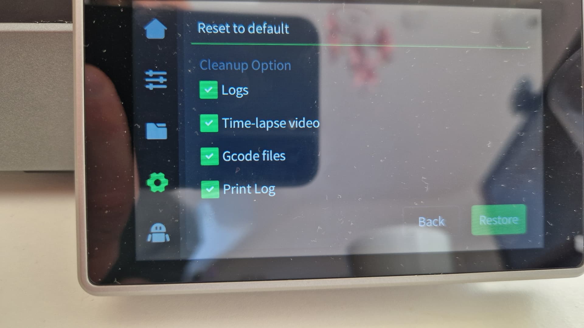

I have been facing an extreme layer shift over the y axis, too.
Brand new Ender 3 V3, first print of Benchy.
You would think it comes with latest firmware and best standard settings. But apparently it does not.
I “Reset to Default” and went over the initial steps once more.
Afterwards, Benchy printed fine.
Weird!
