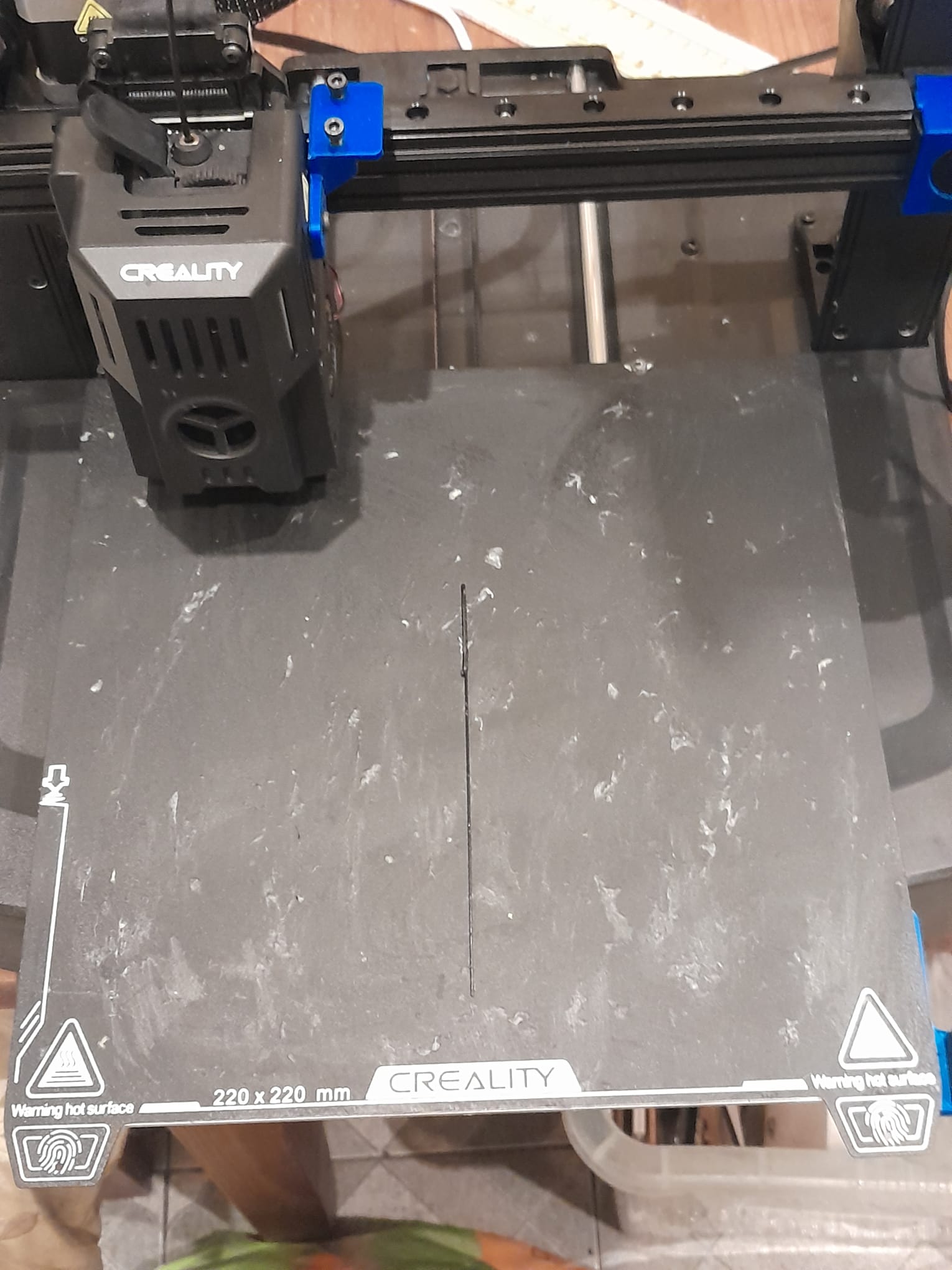

I’m not sure if this is the x or y axis, but my creality ender 3 v3 ke has suddenly decided to not use the left half of the build plate.
I’ve tried all the levelling options I can think of (I’m very inexperienced so I don’t know many) and even tried doing a factory reset, but the same problem persisted.
I thought the ender would move continuously to the left until it hit that little switch to know when it was to the far left of the print space, but it doesn’t do that - even after doing a factory reset.
Please see the attached photo - the black line you see in the middle of the bed is where the printer tests the filament before starting the actual print. This should be really far to the left of the bed, not in the middle.

So is it hitting the limit switch? Limit switches can fail, check the wiring and perhaps look at getting a replacement switch?
its not even using the limit switch.
It goes half way across the print bed then tells me its at the far end, when it clearly isnt.
I wonder if you can manually move the printhead to being near the limit switch so that it triggers, one of my printers got a little confused and the bed would keep going down (ender 5 plus) until I manually wound it back to being near the limit, cured it. The V3KE, the bed should go back and twice click the switch, the head should move left twice and then go to the centre for levelling.

Is there any way to check continuity on that limit switch with a multimeter? I would say the switch is stuck as the head moves to the right under power but never to the left

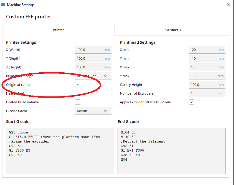

Some Slicers have the option to set origin to middle of the bed… like Cura
Most others default to 0,0 being origin
A couple things to try:
Get rid of whatever that is on the right side of the printhead. If it’s for the vibration sensor, you use that device one time, unless you change or modify something. It adds mass and may be keeping the printhead from moving right all the way.
You should be able to carefully inspect the micro-switch in the left side of the printhead. When actuating with your finger, you should see the little paddle arm contact a very small button on the microswitch, It seems it is somehow stuck ‘on’. Perhaps a small piece of filament is stuck in it. The board that it is attached to is easily removed and/or replaced. You can use a multi-meter to test it, but you will have to disconnect it.
