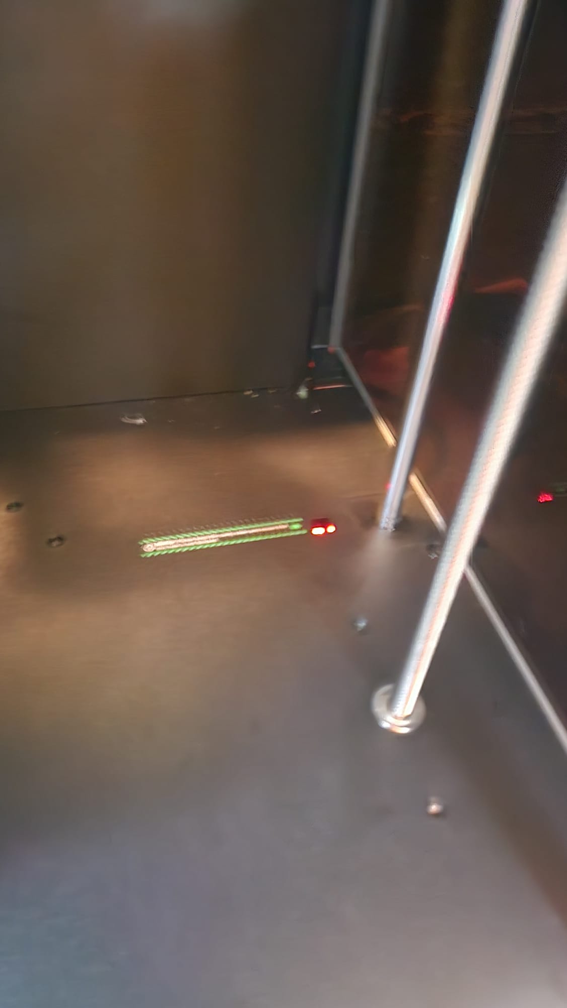

hello i fixed this issues just clean the end sensor plat see my picture red light

OK. i think ive got the fix. In the previously posted pics there is the square hole near the back right side (by the green sticker) filament pieces get stuck in that hole deeper than just the surface area. solution, i took a small piece of filament i cut (approx 3”) and just stuck it in there and moved around a bit. i heard a small piece of used filament fall from within that hole. restarted the system and so far it has corrected the error.
You saved me an hour of work. The head was already disconnected… Thanks! By the way, I finally vacuumed it… :slight_smile:
