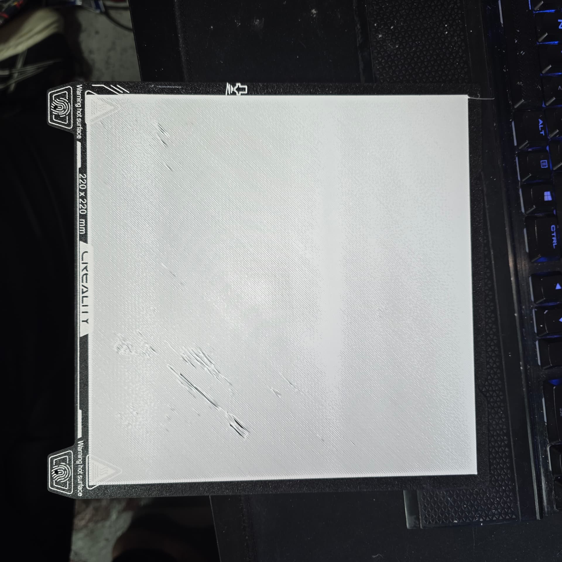

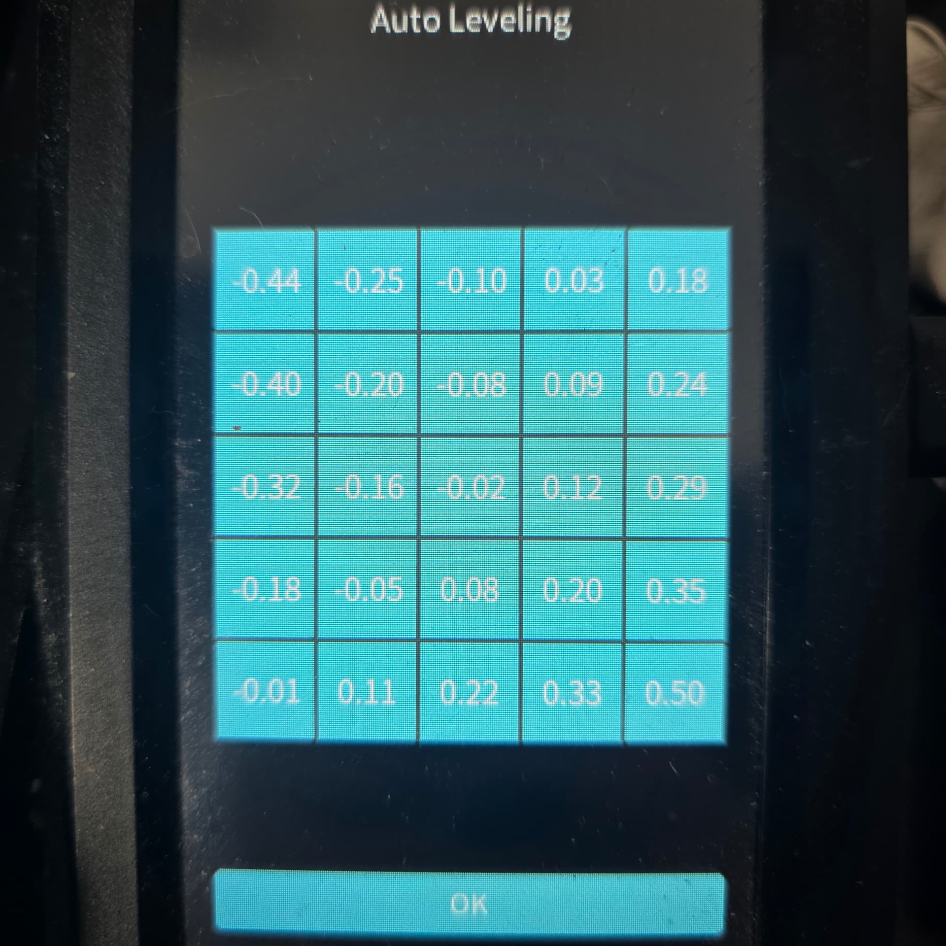

I noticed my bed mesh was uneven like crazy. I always do bed calibration before i print. also did the 24 point on the machine itself. How can i fix this?

Have you tried to preheat 5-10 minutes before doing the leveling ?
And looking at the first photo, I think you may need to play with leveling knob under the bed (Check first but I think there are installed by default on the V3 SE ? :thinking: )

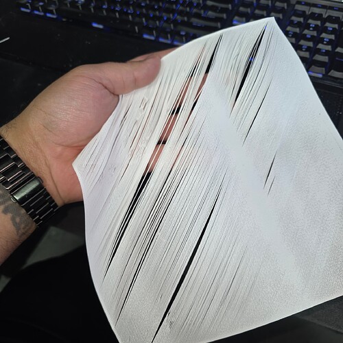

It looks like you need to adjust the “Z” offset, the nozzle needs to be a bit lower. This can be done as you are printing the test 1st layer.
i already did the z offset as well. Im looking into spacers but not sure which ones are good
Ah yes ! Then it’s shim time (you need to put spacers under the bed
Hopefully, in only one corner (it will make a huge difference)
any recommendation for which ones ?

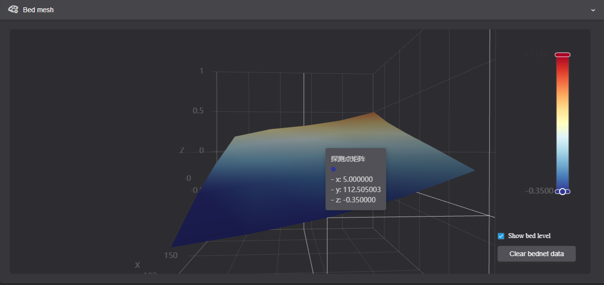

I would need a better view of the bed mesh map. I don’t see where X start and where Y start
