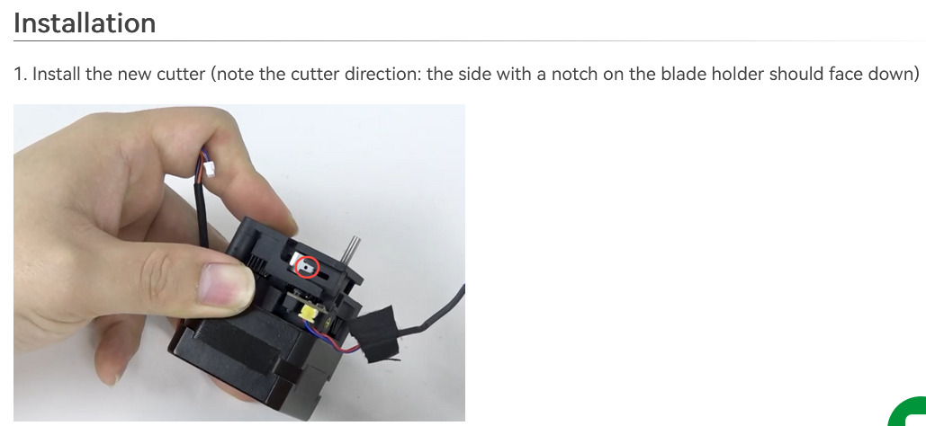

Make sure you didn’t put the cutter blade in upside down - when it is, it will catch and not rebound properly every time. It may be time to replace the blade too - they do get dull which is why replacements are available.

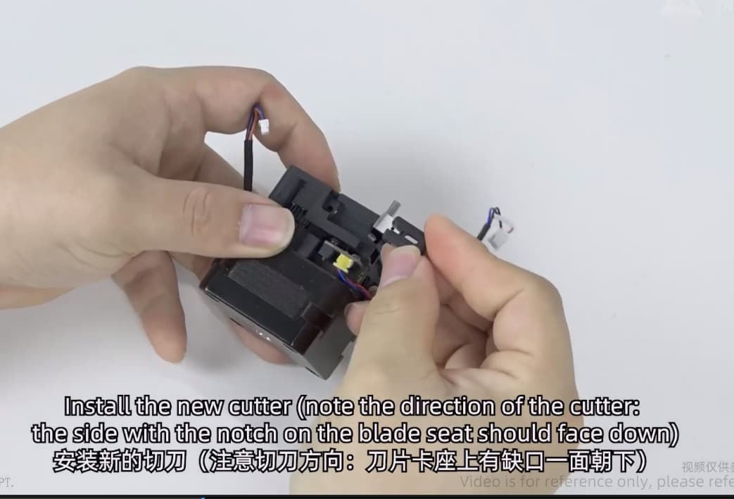

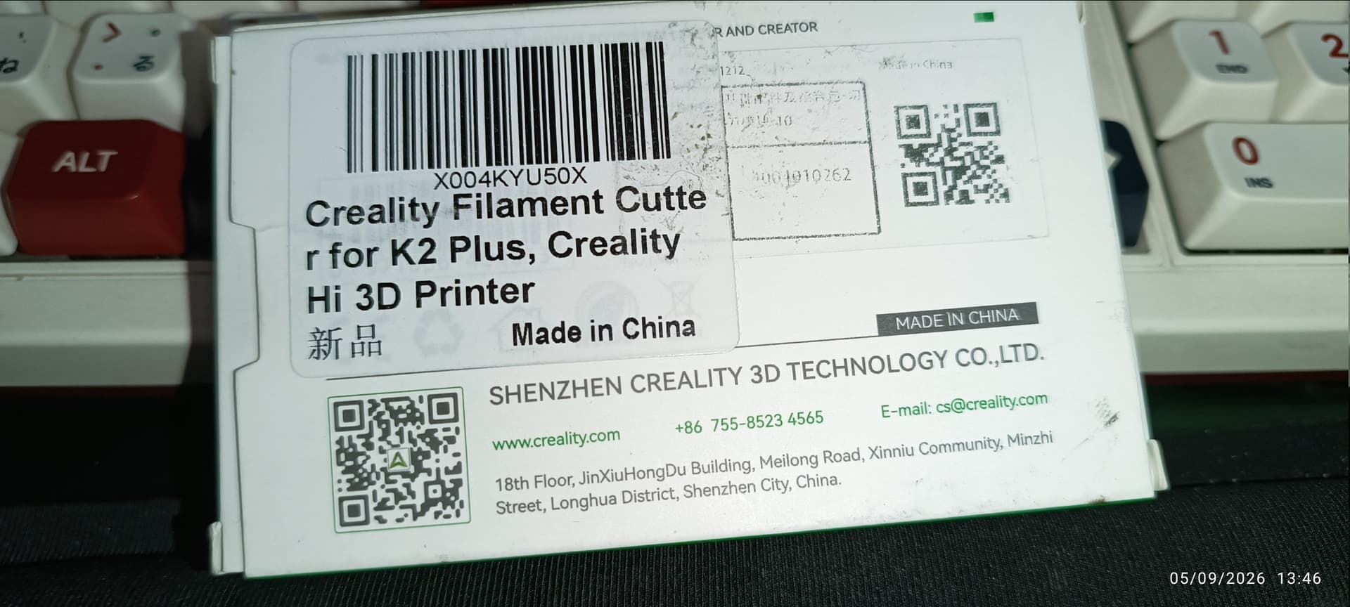

I got a pack of ten blades, WHICH COME WITH THE MAGNETS ON THE WRONG SIDE, so if I put them on the «correct» way they do not bounce, I had to remove the magnet on my extruder and flip it. arggghhhh
You might have gotten the ones for the wrong printer. I think the K2 and Hi cutters are different.
nop, they are specifically for the Hi.
Yup - flip it over the other way. You have it upside down so the polarity of the magnets is wrong.
It is on the right direction, at least by the official video and instructions:
Did you try flipping it?
Yes madam, and did the same:
