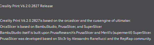

I believe cura does not have this printer profile. At least it does not have one for mine Ender 3v3plus. there. there are instructions online how to add these printers, but why bother CReality print is based on Orca I do not see real benefit to switch.

I switched from Cura to Orca simply for native integration… also Creality 6.2 (beta) isn’t too bad now… (better than v5 was)
not sure if the Creality beta program is full or not, but you could look to join… I figured with the amount of K2 problems that exist being on the beta isn’t “less stable” than being on the production ready release
