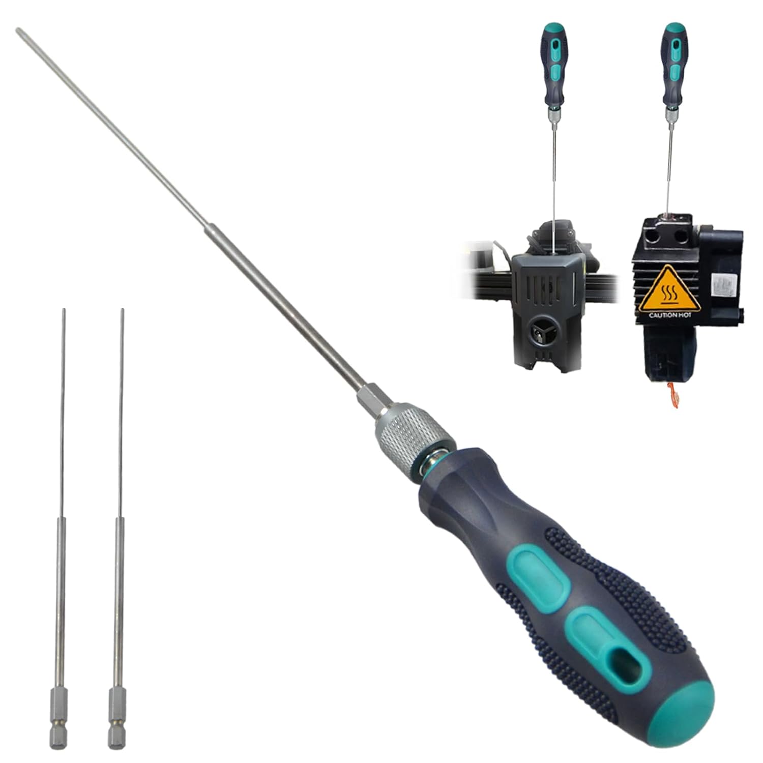

The K2 comes with a tool that clears out the nozzle. You take out the teflon tube and then push the thin rod into the extruder and heated up nozzle and I’ve not had that method fail for any nozzle jam I’ve had so far (and I’ve had a lot).

Use a 1.75mm clog poke. a cheap one comes with the K2 toolkit. I got one from Amazon
