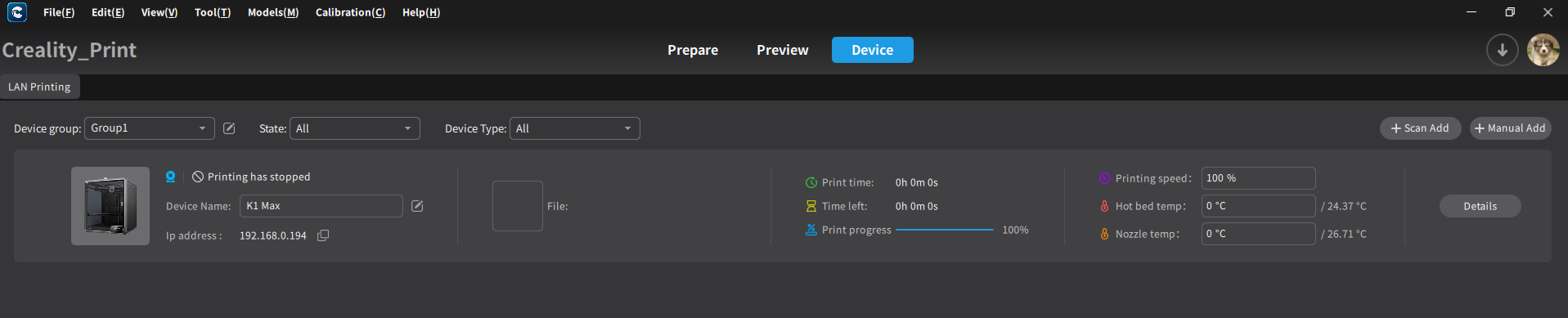

But anyway… what I want to know is HOW I can use the wireless connection. You write that you can run the printer, but don’t say how. Do you mean that you can make a remote start of a print? Can you see anything on your desktop when you “run the printer”?

Have you been able to connect your K1 to Creality Print..?
OK, yes, in the meantime I found out how to do that. Blame it to my bad eyesight, I have difficulties to see these gray fonts on black. However, the connection works now and I could send a .stl downstairs. But the print I had to start manually on the printer. Maybe I will also Ind out how the start procedure works.

Once you can send the gcode file to the printer press “details” to go to the printer control screen:
You should see the gcode file you sent. Click on it for the menu options to start printing.
You can do this without having to go downstairs. :smiley:
I like to watch how the first layer is going down.
