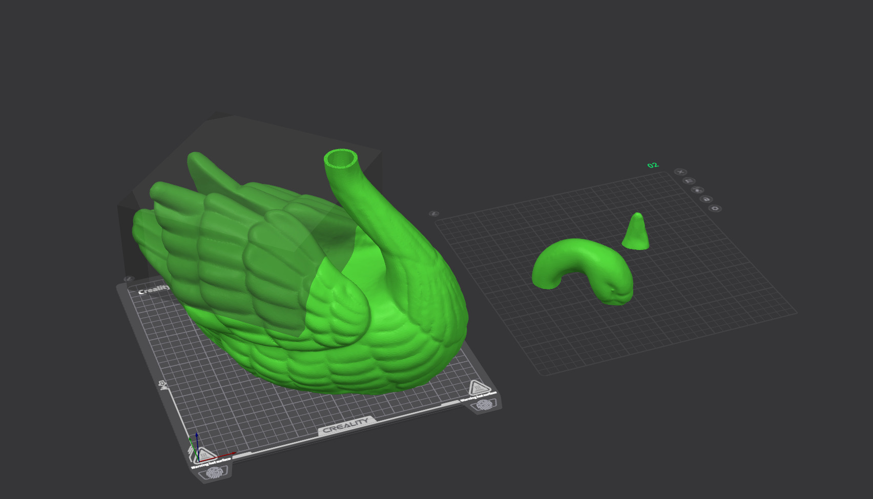

I have a Swan STL that I intend to make remote control for my wife. I have scaled it up, hollowed it out, and sliced off the pieces I need to fit in my print area, but now I want to cut out a piece of the top to access the inside. (I have attached a photo for reference.)
I created a “negative part” cube for the section I wish to cut/print separately, but now I’m stumped as to how to make this a separate piece. Even if I check the preview with the negative part, it only cuts off the outside edges of the cube and not everything inside of the cube’s volume. (If you’re used to designing in Fusion 360 at all like me, I’m trying to essentially create a new body via the “intersect” method.) Unfortunately this STL isn’t my design, so I can’t edit it except in the slicer.

You might be able to print the swan with ‘pause’ at layer and stop the print. Not sure about the head but you could turn it upside down and stop at layer. Trouble is it would need supports and I don’t think you can generate for just the head.
