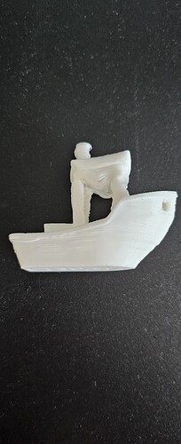

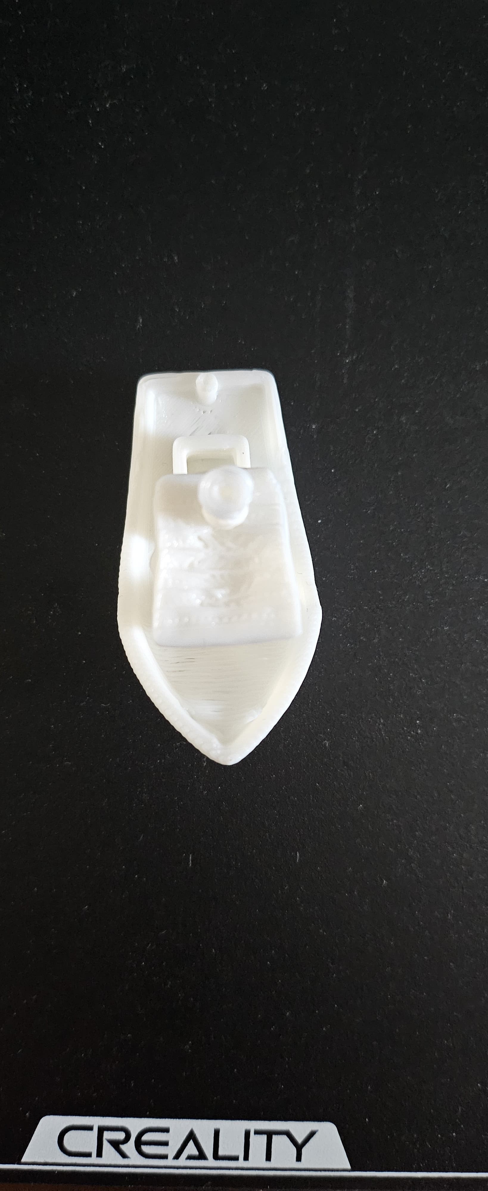

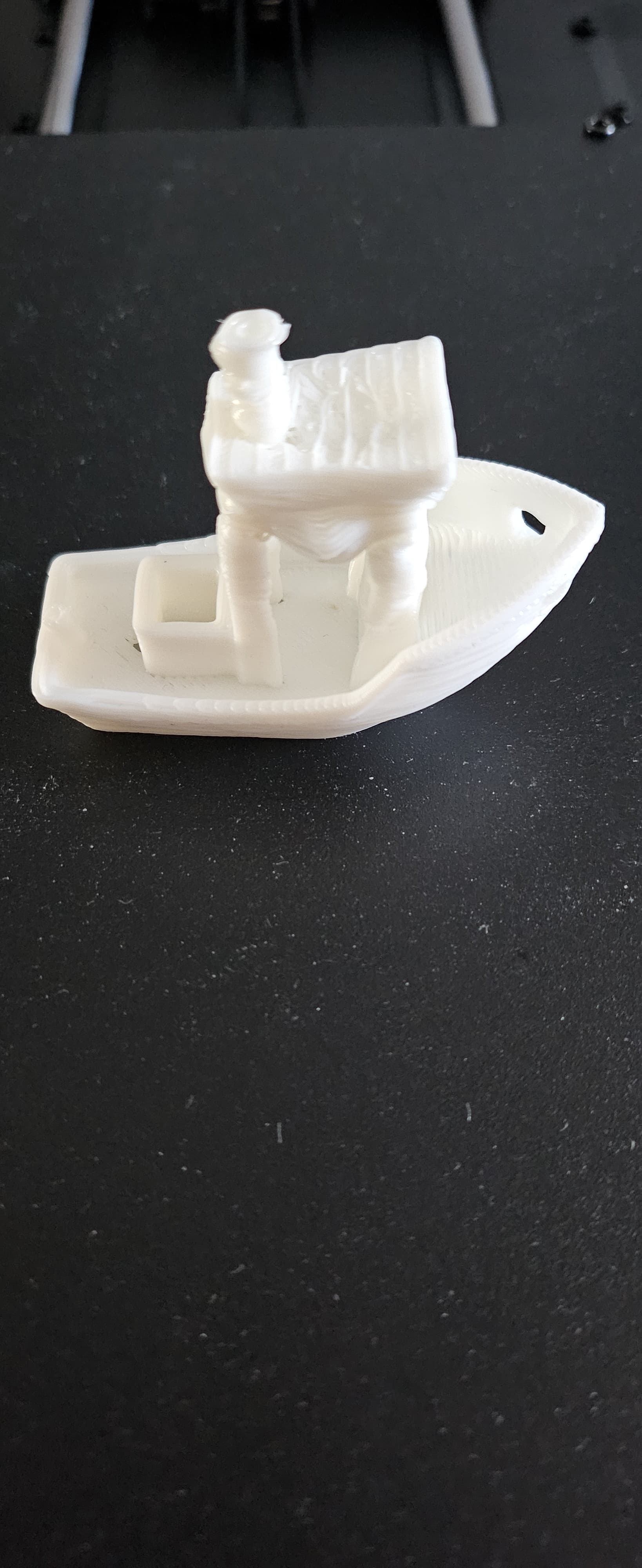

I have printed this test boot and I would like to know how can I print it in a neater way?
Hi
This could be due to a lot of things.
Please let us know what material you are printing with (PLA, PETG etc.) also what temperature your printing head and bed are set to.
I’m just using PLA.
The temperature of the nozzle is zet on 240 celsius.
And the hotbed is on 50 celsius.
But the temperature wil all zo being zet during a print of a model.
Zie foto

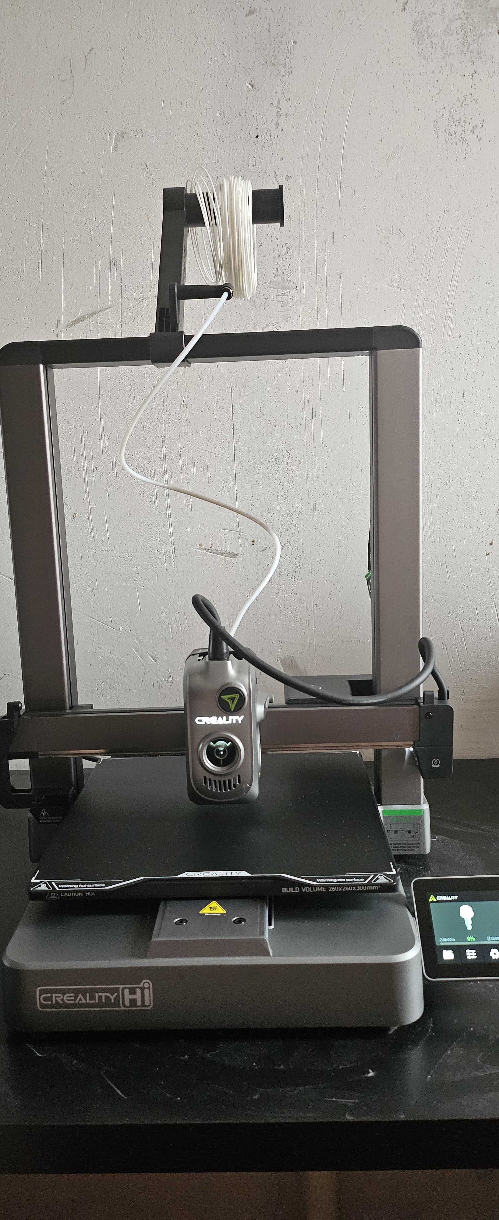

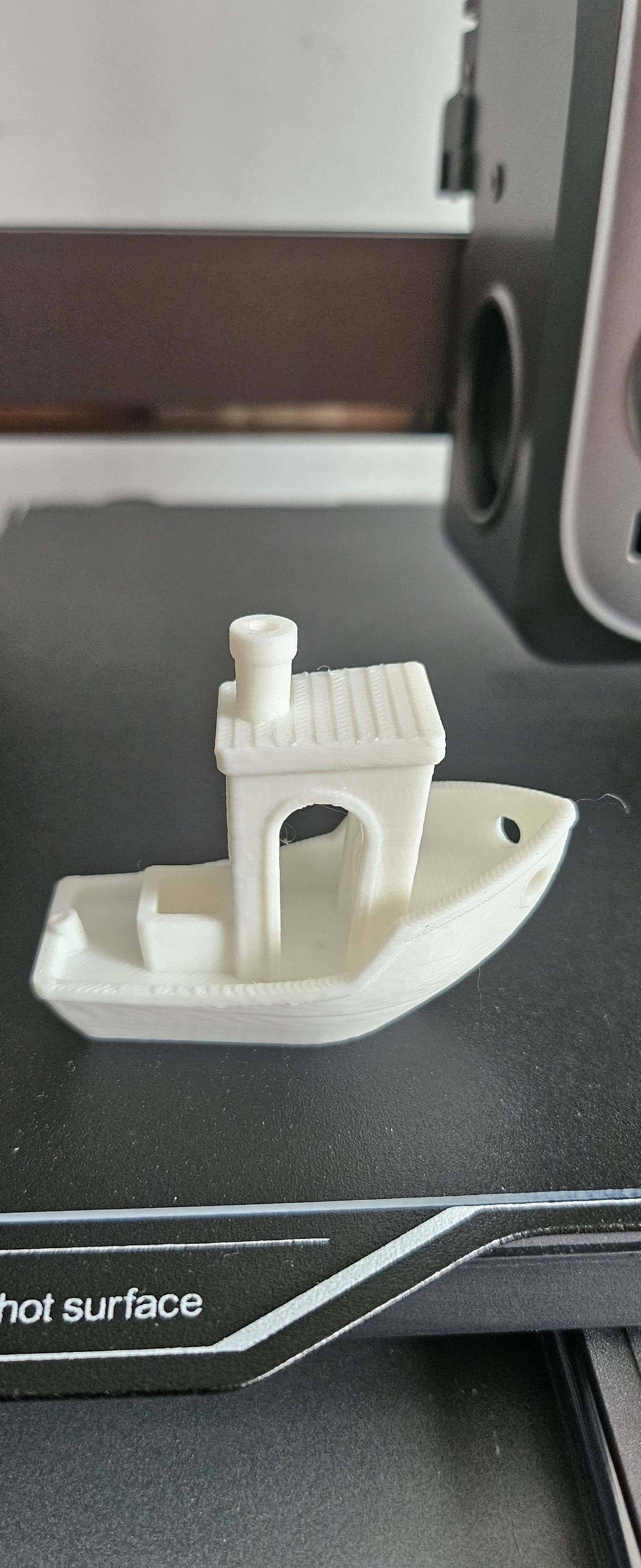

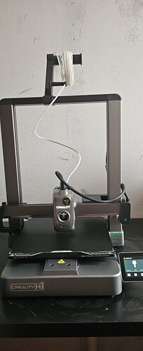

And when I got my money back I bought a Creality Hi combo.
All the fans on this printer are now working.
And you can see that in the test boat I printed afterwards.
I haven’t connected the Creality CFS yet, because I wanted to test the printer first.
