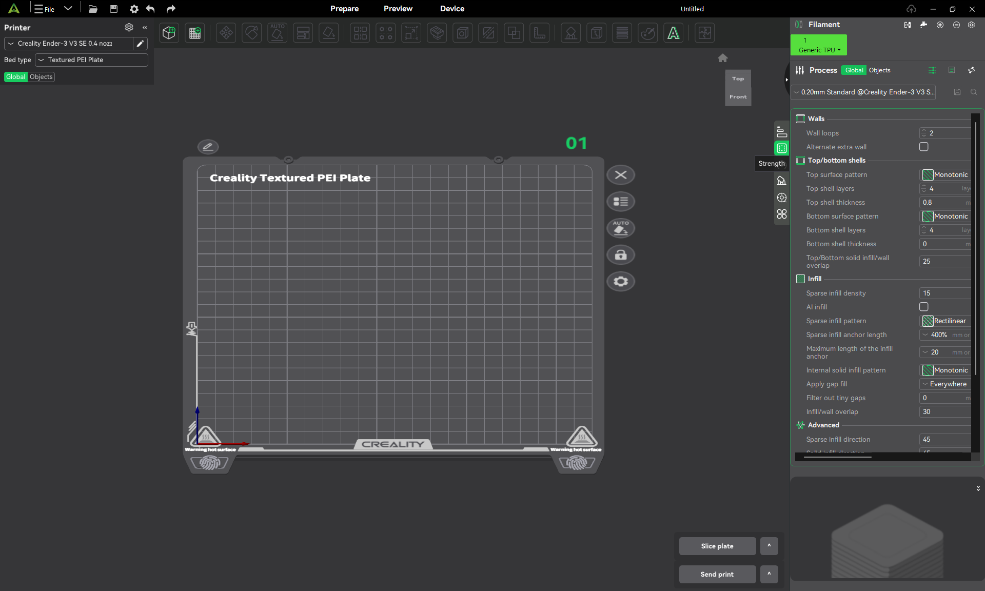

How do I set 3 Wall perimeter?
How do I set 3 Wall perimeter? Could not find this setting
In the Processes area, the Strength tab, Wall Loops is the same thing as Wall Perimeter. Just put the number of walls you want in there. In your case 3. If you want 4 wall perimeters, enter 4 for the Wall Loops value.
Strength>walls>wall loops
Can you please help me? Changed my wall loops to 4-5 but it still doesn’t show up in my prints, any idea on how to fix this? Btw i’m printing a hollowed out bust.
