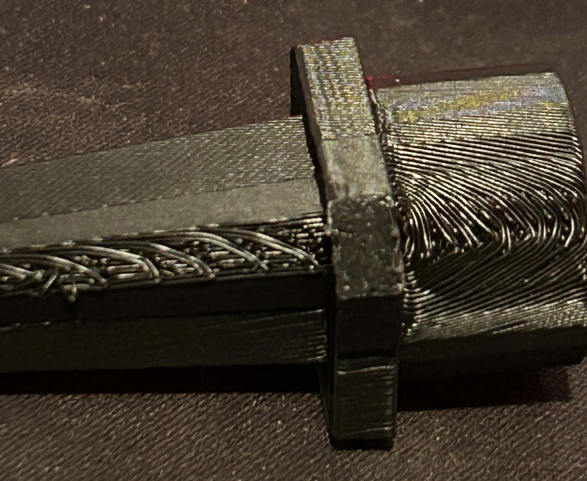

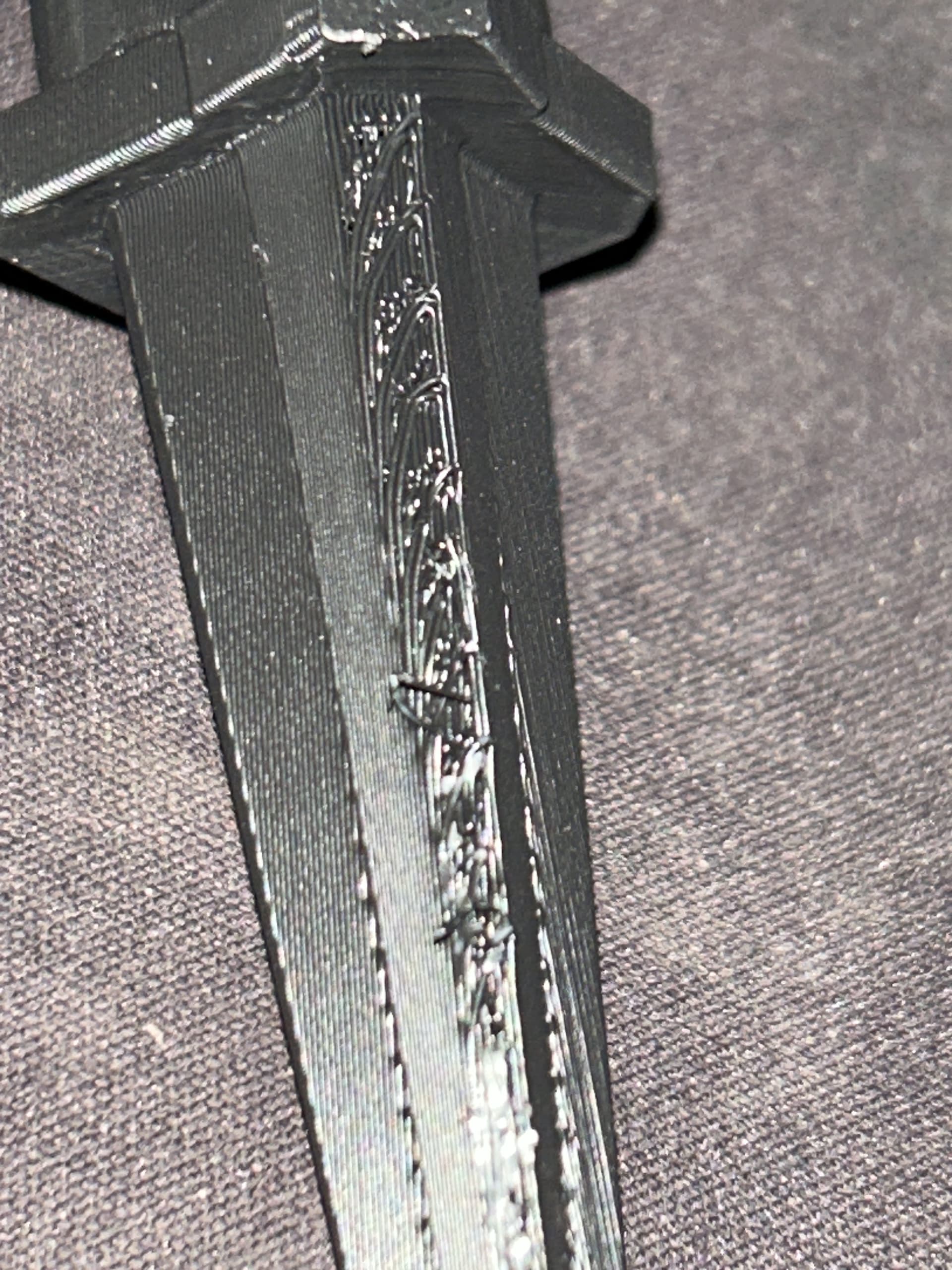

so yea, my k2 se supports are damaging my prints, i need to make a spike for a project im doing and no matter how i design it or what way i lay it down the supports and the top face always seems to be a little dodgy is there a way i can stop this? im using the Hyper pla that came with the printer.
You can switch to tree supports with 3 interface layers and increase your z distance to .3. Try using ironing support interface
Changing orientation is the best way.

I do auto orientation, and then:
Tree (auto)
On build plate only
Top Z distance .275
Top interface layers: 3
This makes the supports break off very easy and less damage to the print
