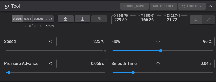

I’m merrily printing bulk standard cheap CR ender pla at 225% using 0.4 nozzle standard 0.20 / adjusted per object infill profile
Edit: I tend to print slowly (50-80%) for the first 3 layers depending on shape/complexity, then ramp it up..

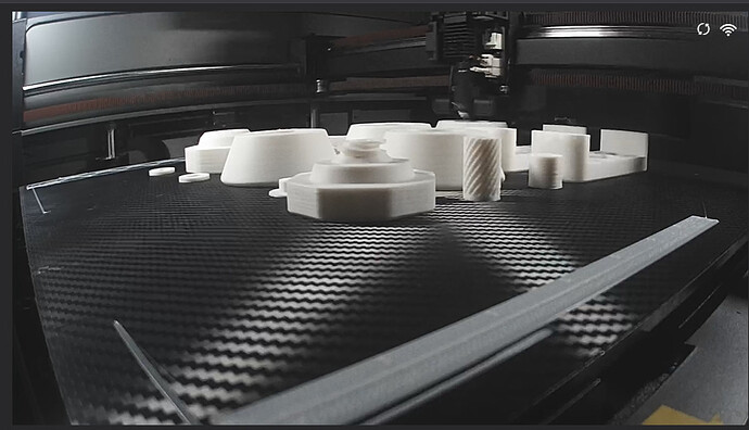

so far i’ve only gone as far as 500% on basic shapes, which turned out surprisingly well.

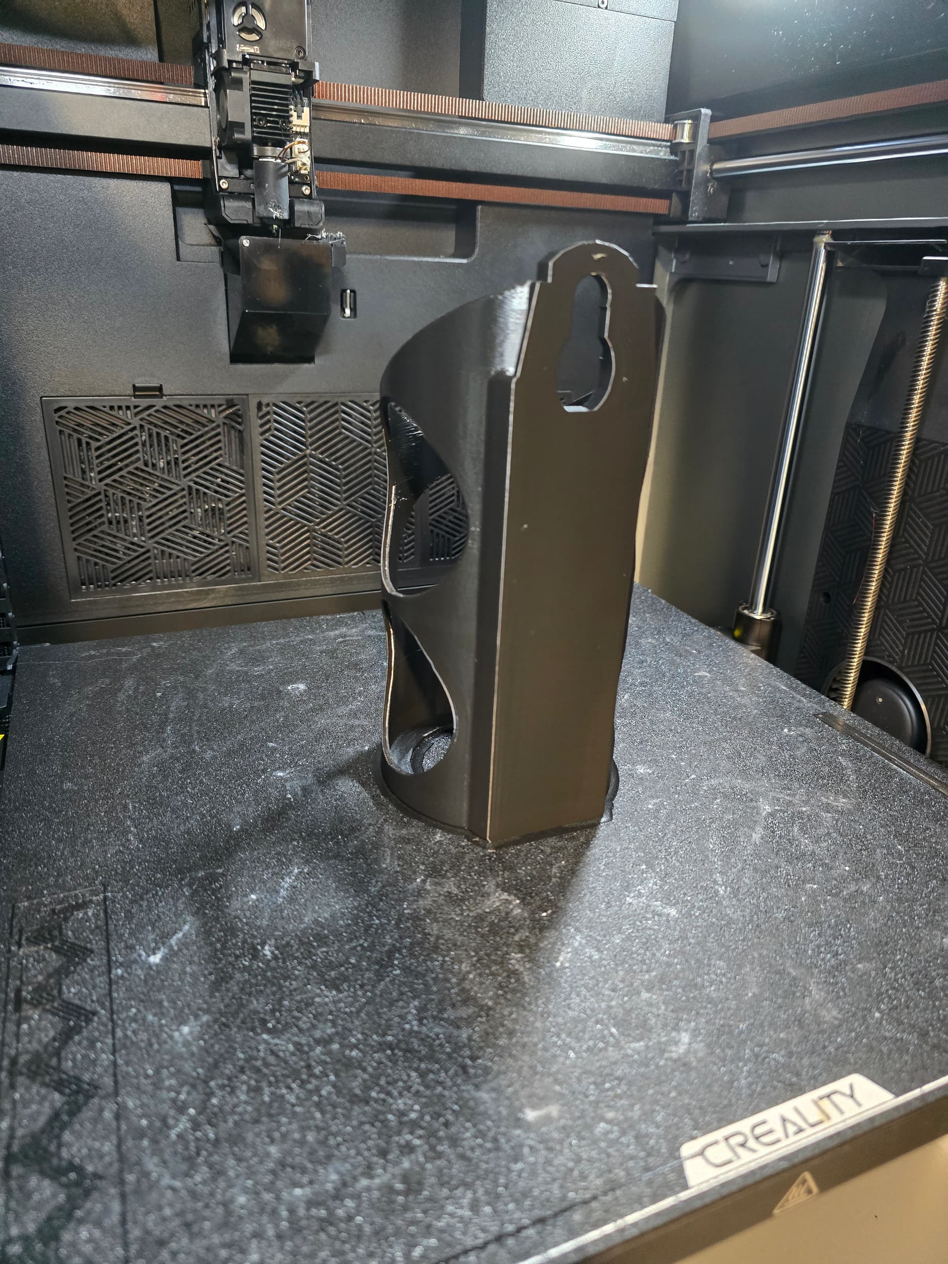

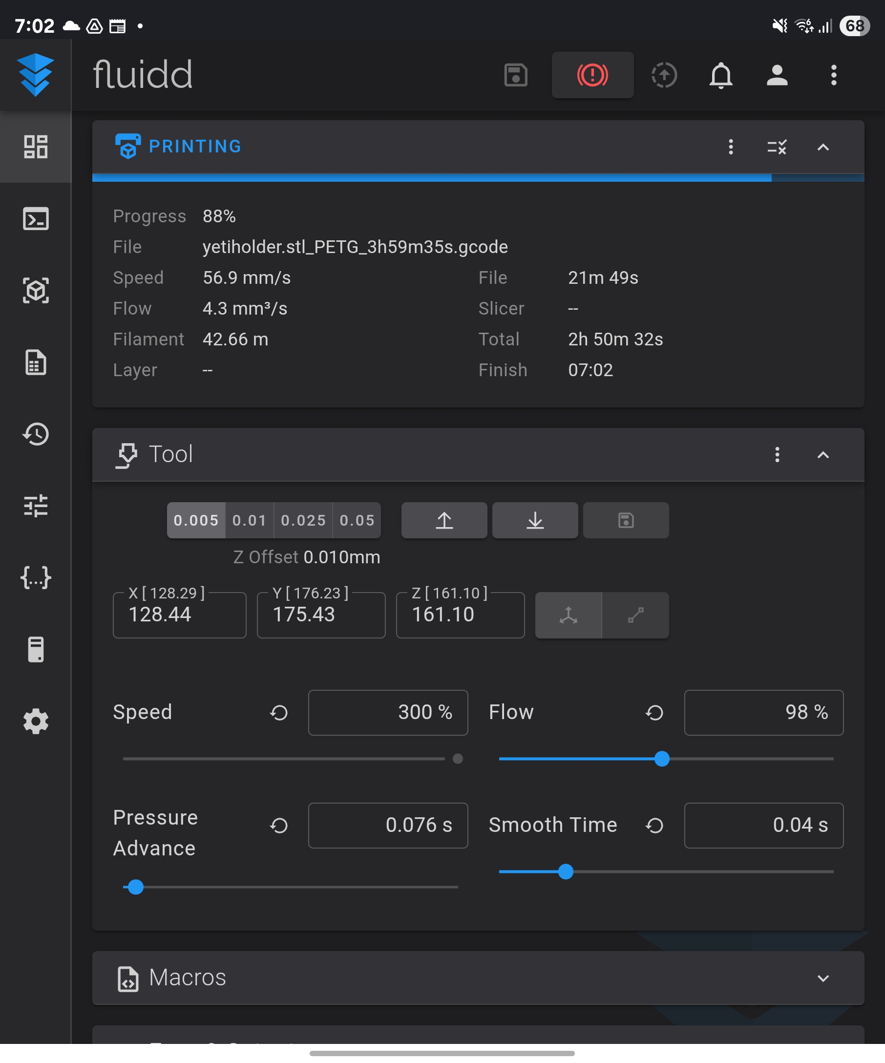

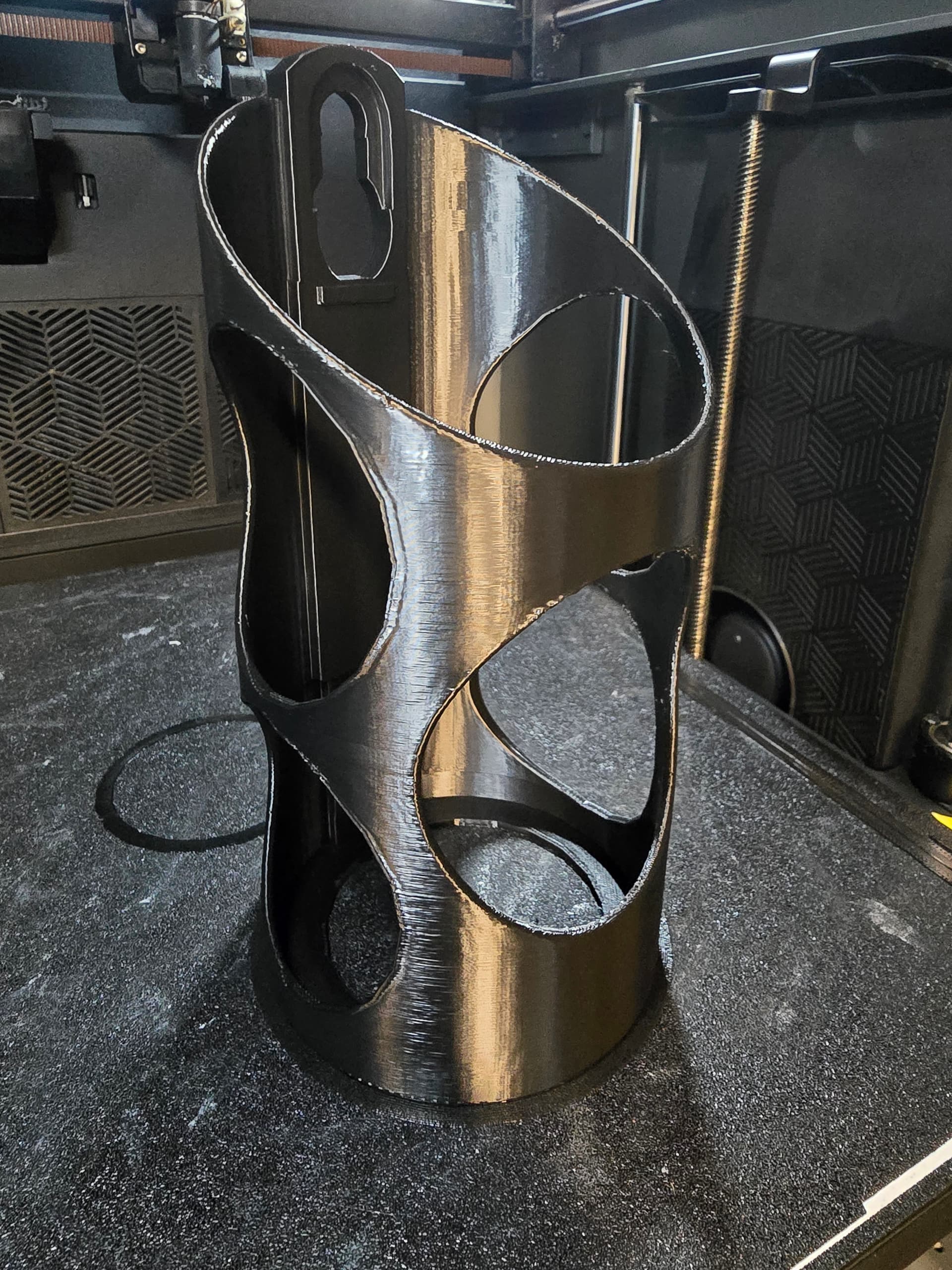

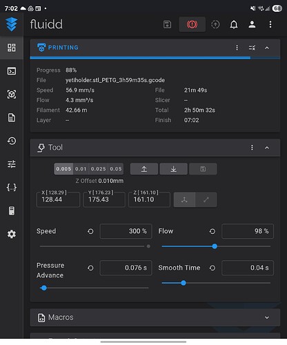

Petg yeti drink bottle printed at 300% 0.4 / .20 strength profile (for golf cart so don’t care if its not super fine detail)
with strength profile on this object lots of “slow” circular printing, 300% chopped about 40 minutes off the print
