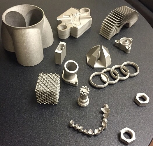

Metal 3D printing using brass opens new doors in manufacturing, automotive, marine, and construction industries. The versatile alloy, known for its corrosion and high-temperature resistance, conductivity, and machinability, has long been used in heat exchangers, musical instruments, pipe fittings, locks, and even ammunition casings. Notably, Italian 3D printer maker 3D4MEC introduced the world’s first specialized laser powder bed fusion (LPBF) 3D printer for brass powders—the 3D4Brass printer, qualified for CuZn42 (CW510) brass powder printing. This breakthrough offers faster, cheaper production of traditionally brass-made parts with improved detail and finish.

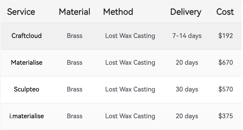

Brass 3D Printing Service: Get Your Designs Printed
To create brass parts through a 3D printing service, the most common method is lost wax casting. This process involves printing your part in a wax material, covering it in plaster, and then melting the wax out to leave a hollow mold. Once the mold is created, molten brass is poured into it, and afterward, the plaster is broken away once the brass has set. The final step is polishing the brass to achieve the desired finish. Several 3D printing services offer brass printing using this lost wax casting technique. You can easily upload your digital design and get a quote for the process.
