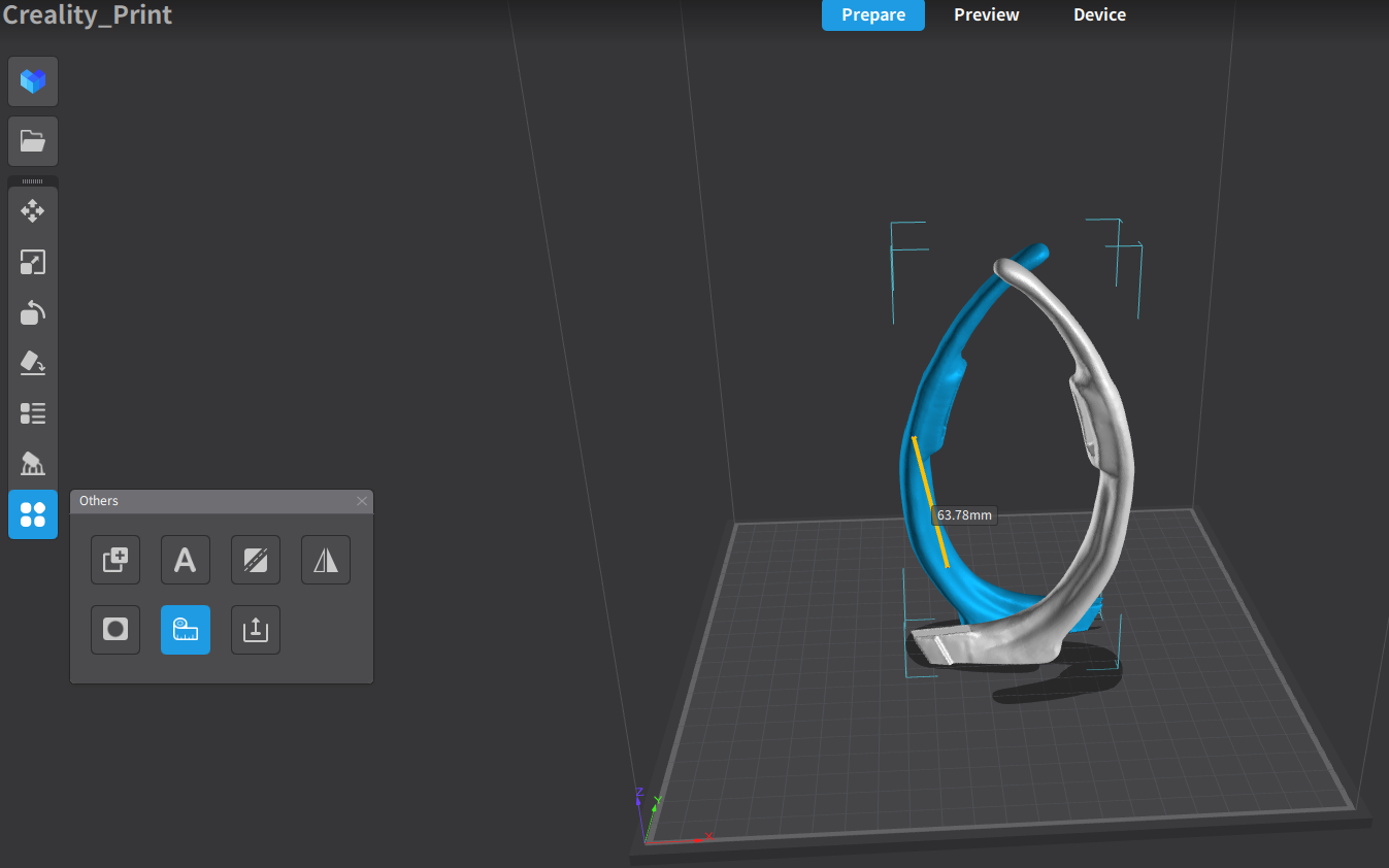

If you are using Creality Print there is a ruler where you can measure the prints on their X, Y or Z axis. It’s in mm so you will have to do some converting… :thinking:

I haven’t updated to Creality Print 5.0 yet so I’m not sure if it’s the same… But here is where the ruler is that I’m using..

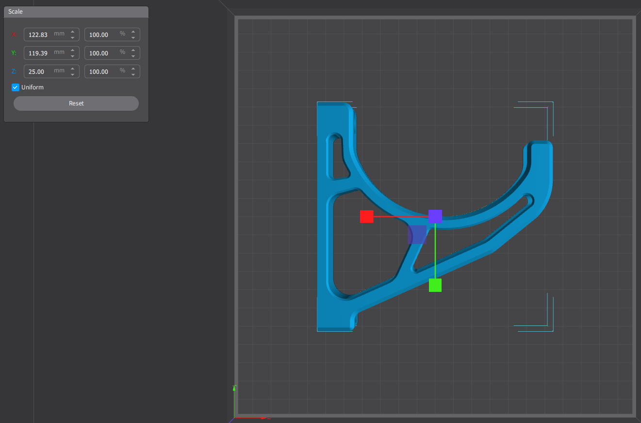

This is the Scale showing the measurements of the model.
For example this picture shows the full dimensions of the model. The length width and height are shown.
This is clear as mud. What length is shown? Is it from the left side of the model to the right side of the model? Or from the blue square to the side of the model? Or is it showing the size of the box around the model?
Sorry I didn’t explain better… :upside_down_face:
Take the x axis first. It shows 122.83 mm of the actual model. Left to right or right to left. Same thing. The measurements are the model itself.
If you create a model of a square and adjust the parameters in the top left picture where the scale is you can input the size you want it to be. If you type 20mm x 20mm x 20mm that’s the size of the model that will be printed…

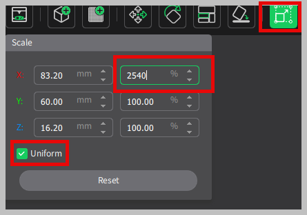

If your STL is accurate in inches from your modeling software.
You need to scale it to 2540% (25.4mm = 1 inch)
Do not turn Uniform off, or you will only scale in one axis.
Edit: I design in inches. Sometimes I forget to convert the finish STL mesh to Metric before saving it. When I go into the slicer, I have to scale it up by 2540%. 25.4 is the conversion factor for going from inch to Metric.
