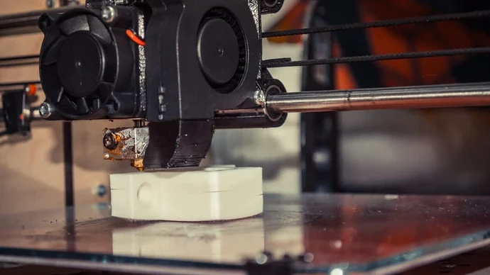

Print in an Enclosure
ABS’s resistance to temperature makes it highly prone to warping. To mitigate this, try printing in an enclosure to raise the ambient temperature, reducing thermal contraction forces.
You can choose between DIY enclosures or commercial solutions. Some commercial enclosures even actively heat the chamber, though this is often unnecessary; the heat from the bed usually suffices. If your budget allows, consider an enclosed 3D printer for simplicity.
Whichever option you choose, test the enclosure to ensure it doesn’t damage your printer’s electronics or printed components.

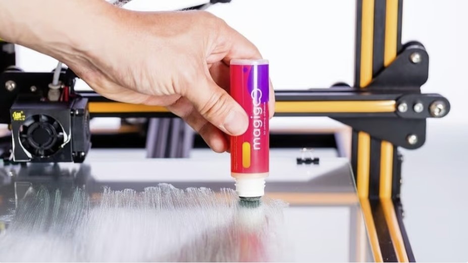

Use an Adhesive
If an enclosure doesn’t help, or if you prefer not to use one, using an adhesive can help keep the first print layer in place and prevent it from curling and ruining your print.
Common adhesives include household hairspray and glue sticks, as well as commercial solutions like Magigoo. For ABS, a good option is ABS juice, a mixture of ABS filament dissolved in acetone. This creates a sticky surface that helps the first layer adhere more effectively.
When using adhesives, apply a thin layer at a time and reapply as needed. Overuse can lead to residue build-up, which can affect print quality and adhesion. Regularly cleaning your print surface, as mentioned earlier, is crucial to maintain optimal conditions.
Adhesives can be particularly useful when other methods fail or if you want a straightforward solution. However, always ensure that the adhesive is compatible with your print bed material to avoid damage. With the right approach, adhesives can significantly improve print adhesion and reduce warping issues.
