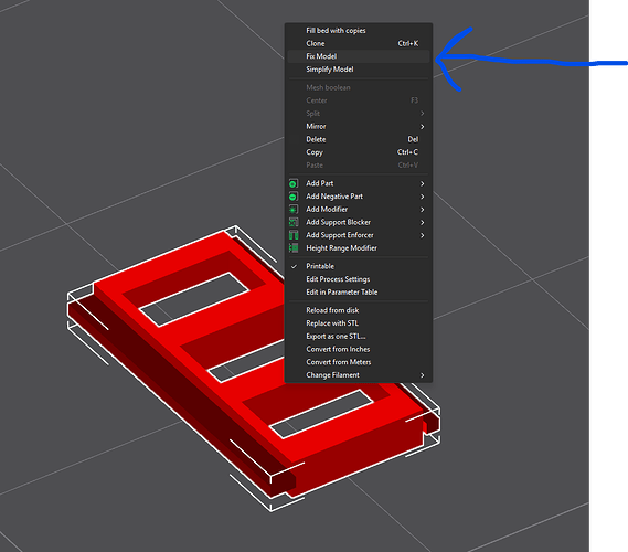

Trying to slice and print the above file
( ladder for the side of of an HO gauge loco) but when I slice and print the result has no holes between the rungs and is all filled in - cant find the settings to stop this - help please - tried to attach the gcode file but it wont let me
David
Hello !
I just tried and I think I found your issue.
In the slicer, right click on the model than “Fix”

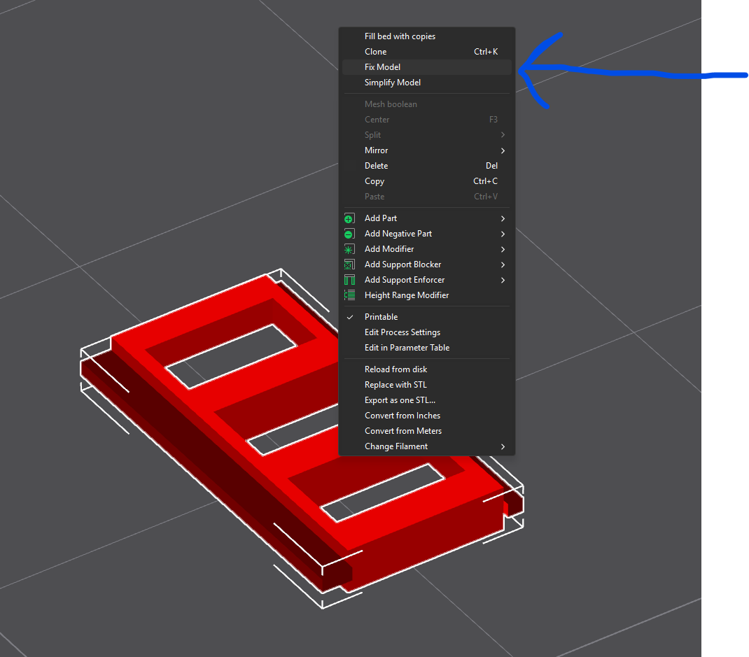

Hi Alex - which slicer are you using? I use both Creality Print and Creality slicer an neither of them have that menu and fix option on right click
Hello !
I’m using Creality Print 6.2 on windows

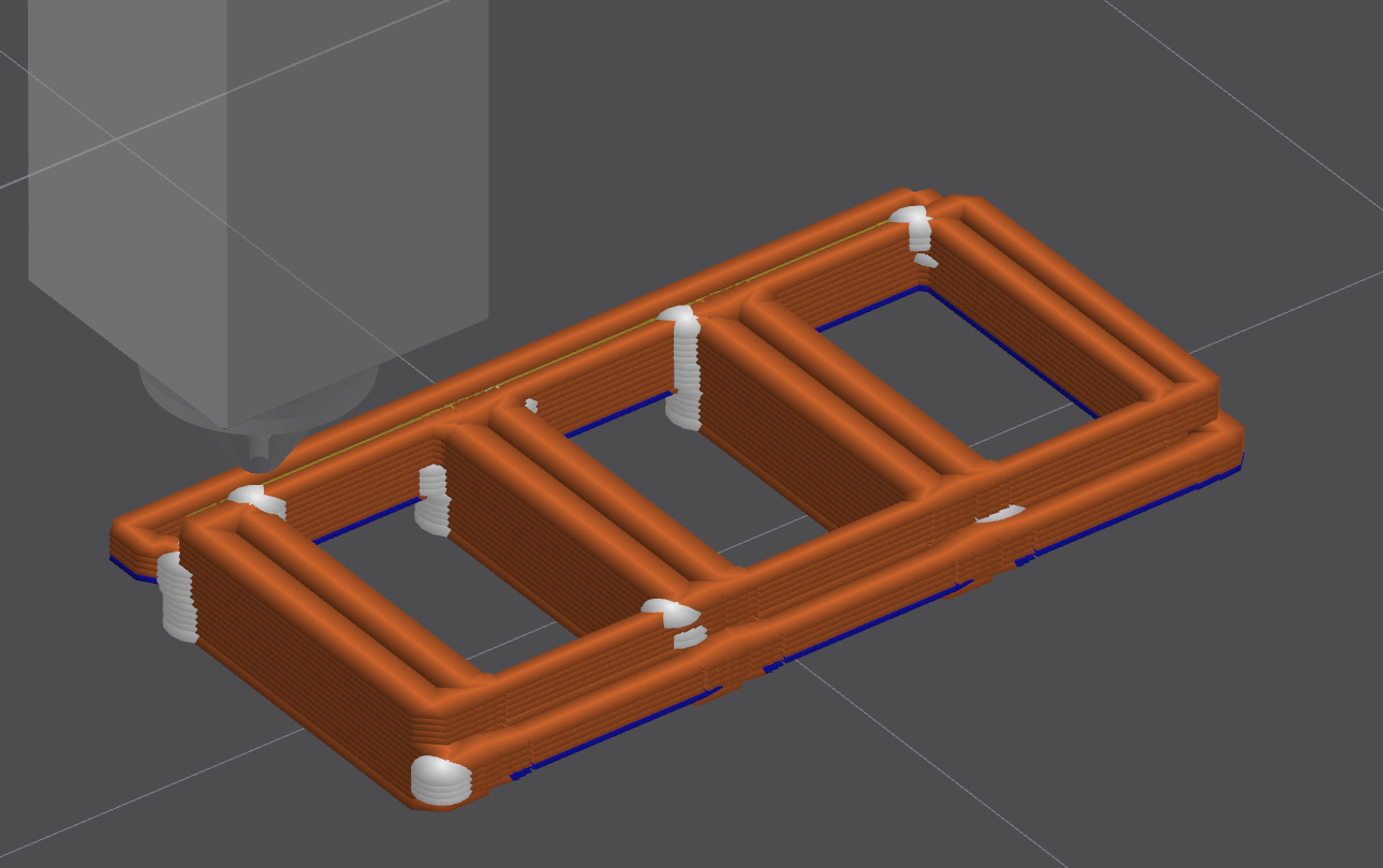

In case, here is the repaired stl from CrealityPrint 6.2
Mick- ladder-3.stl (21,4 Ko)
