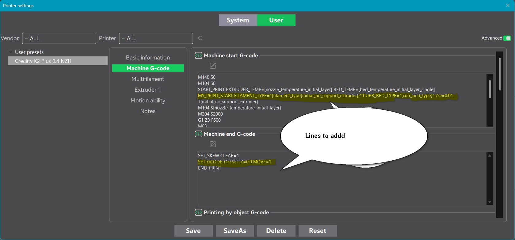

Anyhow, to make the above macro working you need to run the macro also in your printer start code in slicer.
You need to enter in the ‘Machine start G-Code’ section after the ‘START_PRINT’ line
MY_PRINT_START FILAMENT_TYPE="{filament_type[initial_no_support_extruder]}" CURR_BED_TYPE="{curr_bed_type}" N_ZO=0.0
Where N_ZO will be the Z-Offset you would need with PLA on the textured print plate, before I changed my nozzle it was 0.0 but now it is 0.02!
In ‘Machine end G-Code’ you need to enter before the ‘END_PRINT’ line
SET_GCODE_OFFSET Z=0.0 MOVE=1
In this way the macro will be called just before loading filament and printing the purge line (which is important that purge line is also affected). At print end the Z-Offset is reset to 0 (or whatever you want or need).
The MY_PRINT_START macro itself is (in the listed version) only checking if filament = ‘PETG’ and if yes adding 0.025mm (you may change this for your filament needs) and then it’s checking if print plate = ‘High temp Plate’ and if yess adding my 0.06mm for this plate.
So in my case when I print PLA on textured plate the Z-Offset will be 0.02, for PETG it would be 0.045 and on High temp plate it would be 0.08 for PLA and 0.105 for PETG.

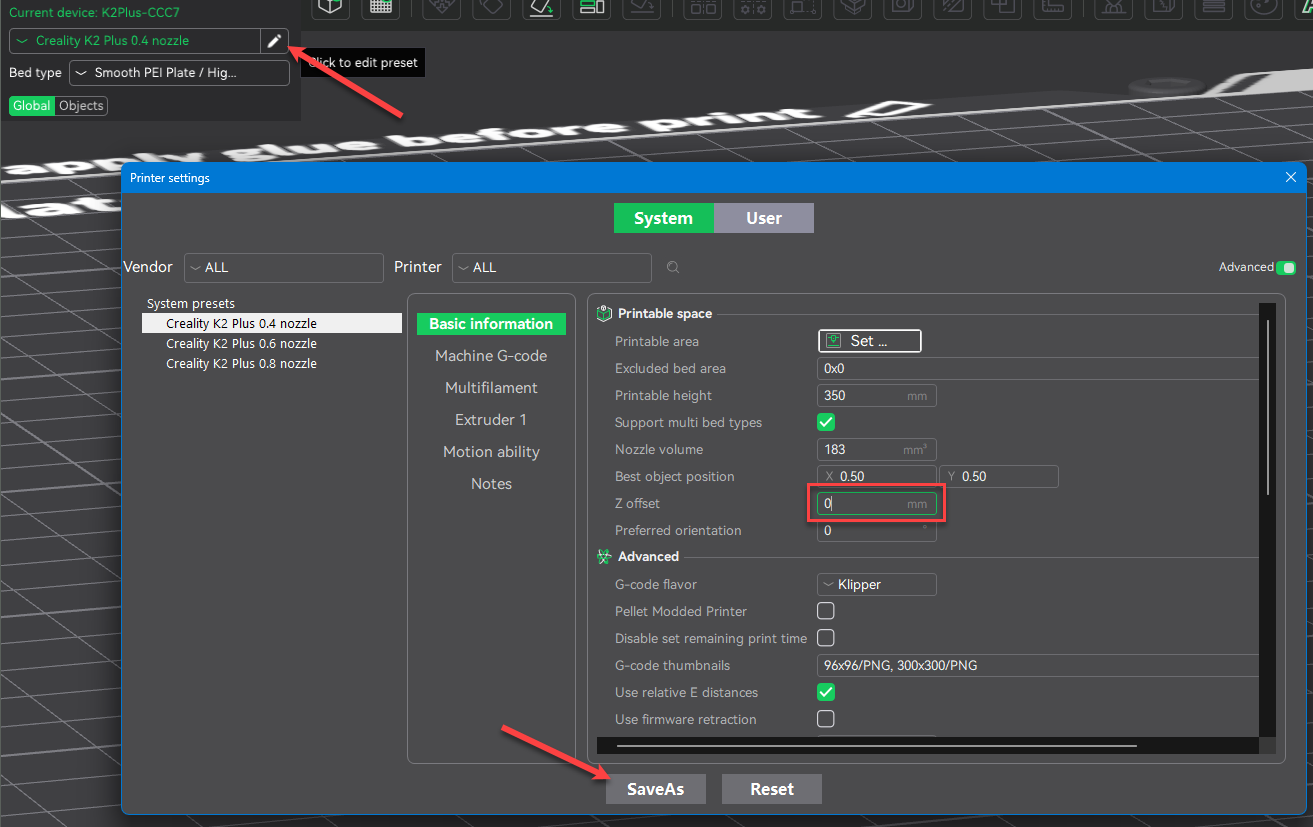

Dear all!
As I copied over the macro from a non-CFS/AMS printer I had to change the call in the printer settings to make it work also on CFS when first filament used is not in first slot!
I reflected the changes needed in above postings but you need to change only the printer config settings line to:
MY_PRINT_START FILAMENT_TYPE="{filament_type[initial_no_support_extruder]}" CURR_BED_TYPE="{curr_bed_type}" ZO=0.01
where ZO=0.01 is you Z-offset when using PLA, most probably can be removed or set to 0.0 for you (I need it for new nozzle).
Here is again the picture where you need to enter the line:

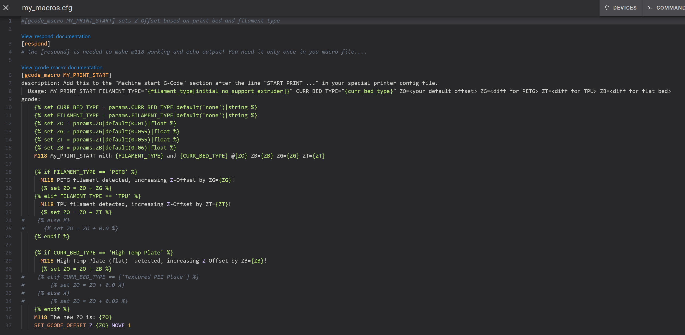

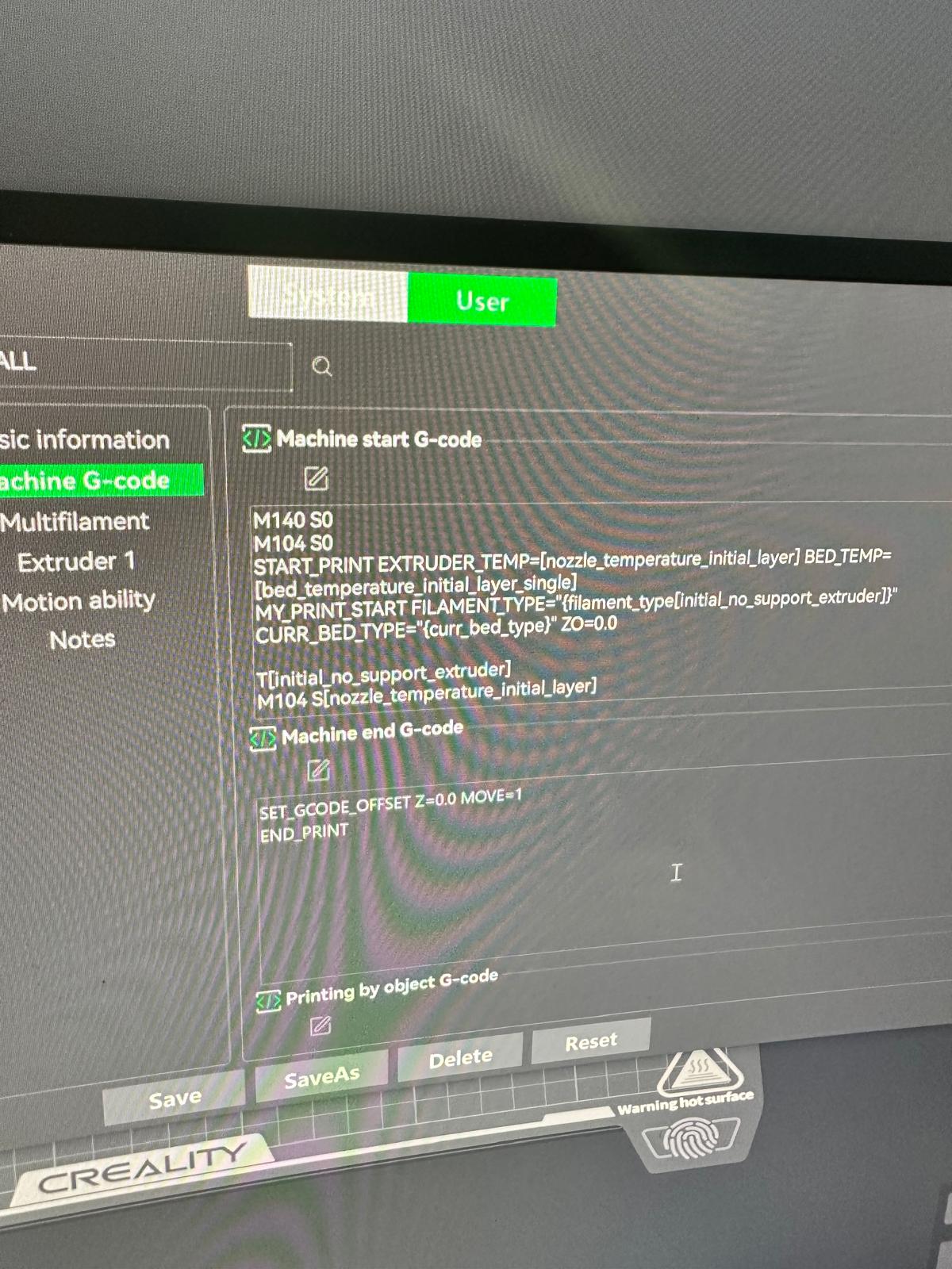

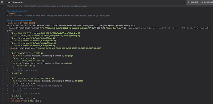

I have been meaning to add this to my K2 Plus for a while now and finally did.
Somewhere I have an issue as I don’t see a Z offset change when printing nor any of the M118 messages in the console.
Here’s my printer machine G-code change with the added lines in the start and end sections:

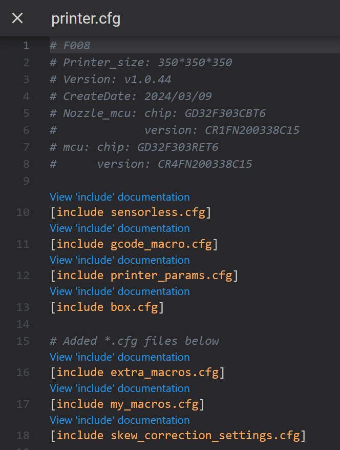

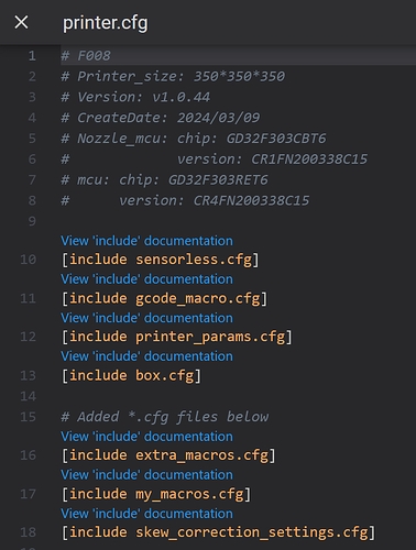

My printer.cfg code with the [include my_macros.cfg] line:
And here is the my_macros.cfg file that is in the configuration section of fluidd:
I did a save and reset after all of the changes.
I have re-read the post several times and must be missing something.
Any help would be appreciated.
Thanks a lot!
@NumerousPayloads , It looks good.
Normally you just need to slice it with this profile and then the lines sould be visible in the gcode file.

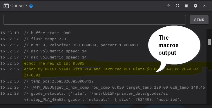

You can check if the macro is running when you watch your fluidd console just when the purge line is printed, you should see similar lines (yellow painted):
If you do not see these echo lines the macro is either not loaded or not run correctly. You may watch fluidd console after a fluidd restart if you get any error messages when starting. The problem may be also in another file!
the lines above the macro is running normally,
p.s.: I see in your printer.cfg that you also include the set-skew macros.
I did than on my Qidi as well, but realized then that I can include it just in print profile as well like below:
Thanks @frankjoke!
I wasn’t reslicing my print file after the machine G-code changes. Works well now!
Had to put [skew_correction] in printer.cfg to get the SET_SKEW in the machine G-code to run.

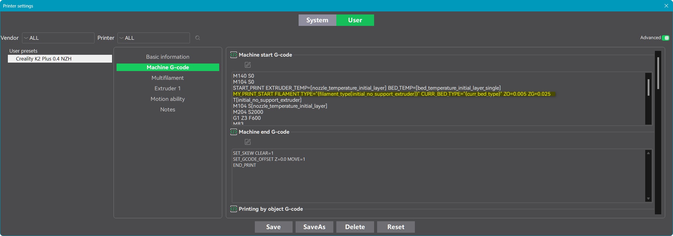

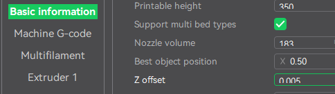

Hey frank :slight_smile: I just wanted to jump in and share the output I’m getting (it’s not setting the offset) and see if maybe you might have some guidance as usual:
01:36:04 echo: My_PRINT_START with and @0
01:36:04 echo: The new ZO is: 0.0
Thanks as always :slight_smile:
It seems that filament type and other info is not handed over to the macro.
are you sure that you have in your user machine settings - Start G-code the right line (here yellow)?:
MY_PRINT_START FILAMENT_TYPE="{filament_type[initial_no_support_extruder]}" CURR_BED_TYPE="{curr_bed_type}" ZO=0.005 ZG=0.025
This is my version for 0.05mm basic and additional 0.025mm for PETG.
You may leave out the ZO as here:
MY_PRINT_START FILAMENT_TYPE="{filament_type[initial_no_support_extruder]}" CURR_BED_TYPE="{curr_bed_type}" ZG=0.025
If the syntax is not right - like missing space or bad characters inside - it won’t work.
The text need to be exactly the same with the exclamation marks and all the special characters.
Yep, and as far as I can tell it’s in there unless I did something stupid:

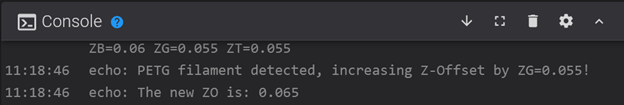

Ok, did you print PETG?
Only if you print PETG or on flat print bed you will see a difference.
Here is my output when printing PETG:
23:52:24
echo: The new ZO is: 0.030000000000000002
23:52:24
echo: PETG filament detected, increasing Z-Offset by ZG=0.025!
23:52:24
echo: My_PRINT_START with PETG and Textured PEI Plate @0.005 ZB=0.06 ZG=0.025 ZT=0.02
I am missing also some status print in first echo line therefore it seems that you did not use my updated macro from February 26th:

    {% elif FILAMENT_TYPE == 'TPU' %}
      M118 TPU filament detected, increasing Z-Offset by ZT={ZT}!
      {% set ZO = ZO + ZT %}
#    {% else %}
#      {% set ZO = ZO + 0.0 %}
    {% endif %}
    {% if CURR_BED_TYPE == 'High Temp Plate' %}
      M118 High Temp Plate (flat)  detected, increasing Z-Offset by ZB={ZB}!
      {% set ZO = ZO + ZB %}
#    {% elif CURR_BED_TYPE == ['Textured PEI Plate'] %}
#    {% else %}
#        {% set ZO = ZO + 0.09 %}
    {% endif %}
    M118 The new ZO is: {ZO}
    SET_GCODE_OFFSET Z={ZO} MOVE=1

Hi All… i’ve implemented the macro with some minor changes successfully…
my question is what offsets are you all using on CR 6.2 ?
my log file & console show what looks to be a default offset being applied by the system, assume that’s a result of ABL &/or bed type being applied by default, so the only offset I’m needing to add is very minor for textured PIE, nothing for smooth beds (except for TPU)
// [WHY_DEBUG]get_z_now_comp now_comp:0.050 target_temp:220.00 G28_temp:139.70
15:51:32
// temp_pos:1.4711138210000172
15:51:35
echo: My_PRINT_START with PLA and Textured PEI Plate @0.0 ZB=0.0 ZG=0.0 ZT=0.005 ZA=0.0
15:51:35
echo: PLA filament detected, increasing Z-Offset by ZA=0.0!
15:51:35
echo: Textured PIE Temp Plate (non-flat) detected, increasing Z-Offset by ZH=0.005!
15:51:35
echo: The new ZO is: 0.005

Really I don’t know what happen.
I follow the instructions, easy, but when I try to print something and arrive to the starting Gcode I can see that printing stops and an error in the console. Seems that it doesn´t like the line I copy and paste.
!! {“code”:“key513”, “msg”: “Malformed command ‘Z-OFFSET_MACRO FILAMENT_TYPE=“PA” CURR_BED_TYPE="Textured PEI Plate”’”, “values”: ["Z-OFFSET_MACRO FILAMENT_TYPE=“PA” CURR_BED_TYPE=“Textured PEI Plate””]}
Could anybody help me with this? cheers!
