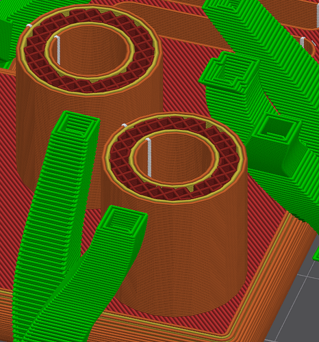

Hi all, please see attached STL created with Sketchup (solid).. I would like to print itas 60% massive, but it doesn’t apply my infill settingsafter slicing. Please help…

I was able to slice the file with Creality Print. Reduced size to 60%. Changed infill to different settings and it worked.
Why did you reduce the size?
Should the slicer show the fill in pattern e.g. in the bottom and in the pilars between bottom and bridge?
I probably read the translation wrong when you said I would like to print itas 60% massive. Not sure exactly what that meant. Sorry. I resized it different sizes to see what the slicer did.
