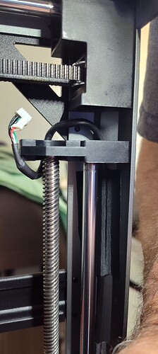

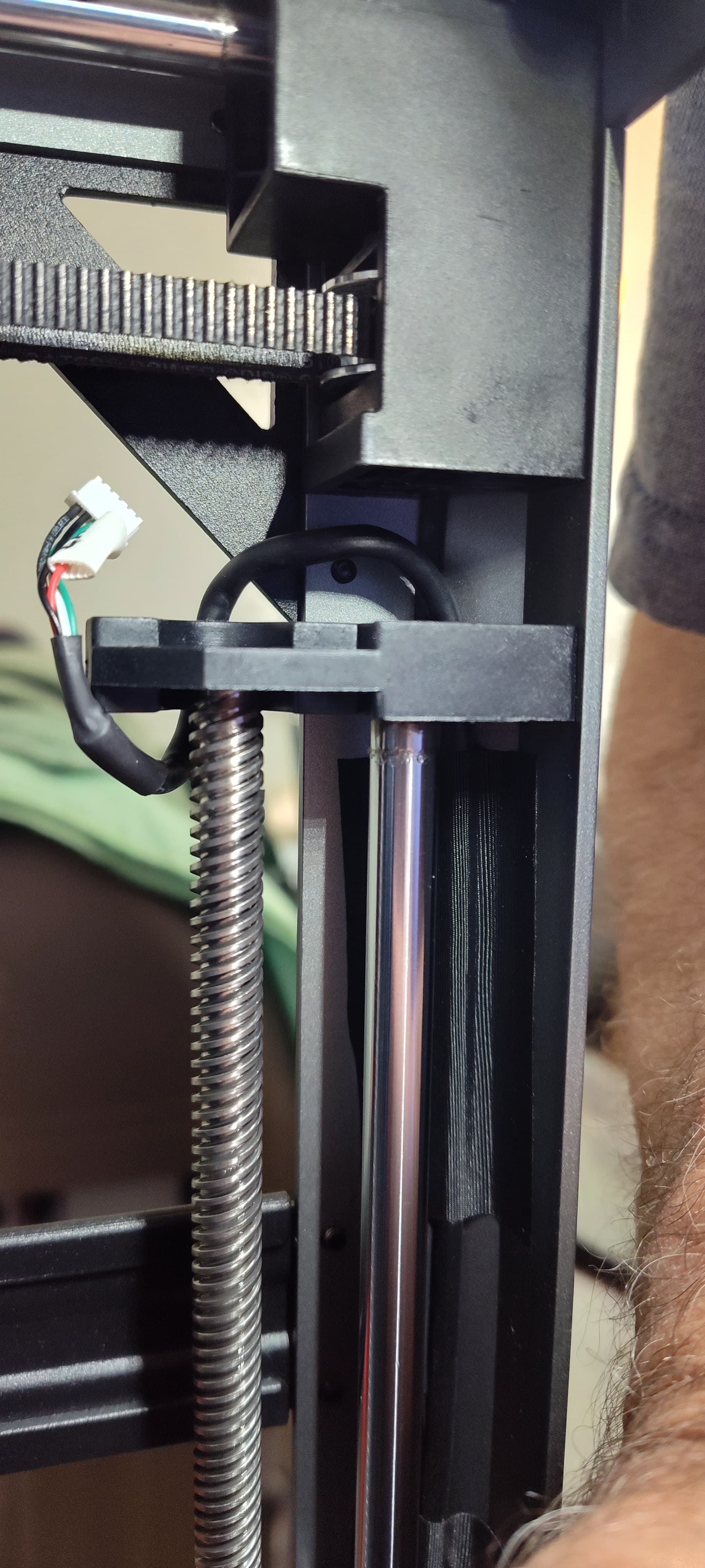

I would like to add a camera to my K1 SE, but cannot find the camera connector. I looked where it’s supposed to be, but there is nothing there. Did Creality forget to install it or does it come witn the camera?

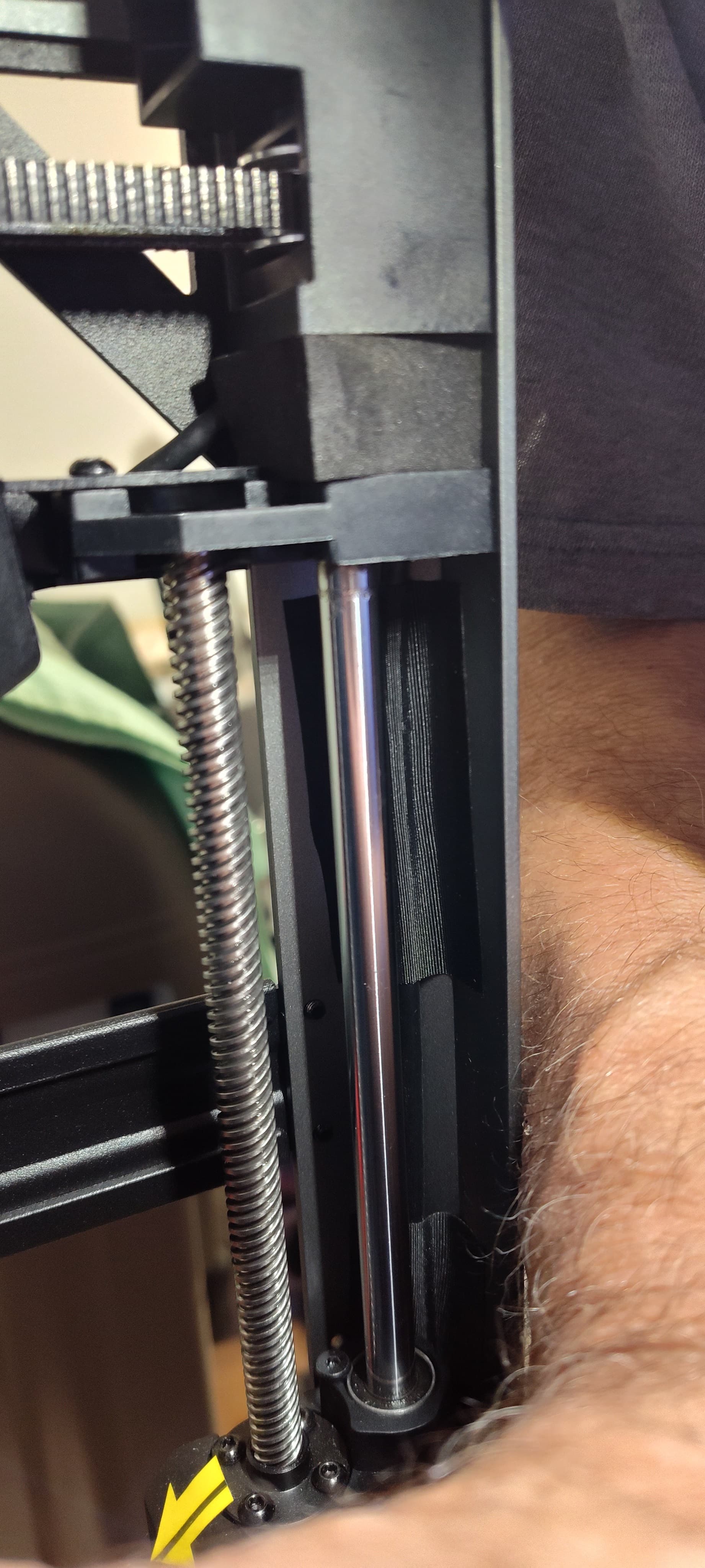

OK, I ordered the camera. Unboxed it and the instructions didn’t help. I looked closely at the location they gave. I comparte it to the other side. The right hand side had a rubber like “plug” above the bearing block, and the left was open. I removed the “plug”, and there was the connector. Hope this will help someone else.
